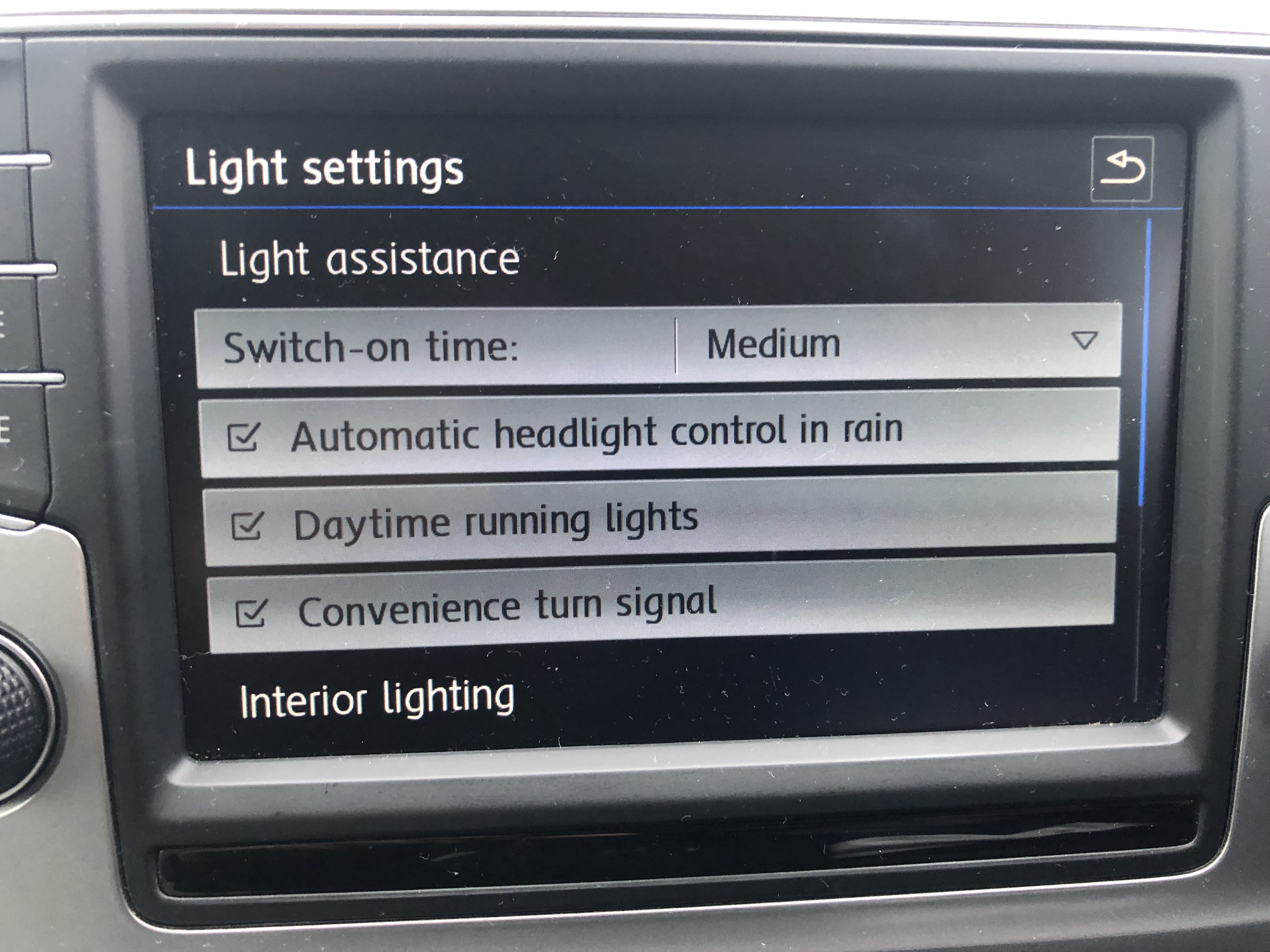

to enable the drl menu that enables or disables the drl lights the following needs to be enabled:
Control unit: 09 Central Electrics:
Security Code (31347):
Adaptions:
Daytime running lights:
Tagfahrlicht Aktivierung durch BAP oder Bedienfolge moeglich: active
I disable the option and my drl lights turn off even with hndbrake down.
In car settings/light menu you well get this as seen on my polo:

Post by ciclo » Wed Feb 13, 2019 11:13 am
massimo23 wrote:
Wed Feb 13, 2019 9:28 am
Are you squeezing the lemon? :lol:
You're great! 8)

Post by massimo23 » Wed Feb 13, 2019 1:10 pm
Thanks Ciclo , there is a lot of lemon to squeeze software wise on these newer cars. :lol:
This is what is available in the adaptions for drl, how it is setup in my polo and google translated :) :
Scheinwerferferreinigungsansteuerung und Abblendlichtanzeige bei Dauerfahrlicht: not active
(Headlight remote cleaning control and low beam indicator for continuous running lights)
Werkseinstellung fuer Tagfahrlicht Freischaltung BAP / Bedienfolge: active
Factory setting for daytime running lights Activation BAP / operating sequence
Standlicht aktiviert zusaetzlich Tagfahrlicht: active
Parking light additionally activates daytime running lights
Tagfahrlicht Dauerfahrlicht bei Handbremse abschalten: active
Daytime running light Switch off the permanent running light with the handbrake
Tagfahrlicht-Dauerfahrlicht aktiviert zusaetzlich Standlicht: not active
Daytime running light driving lights additionally activate parking lights
Tagfahrlichtkontrollleuchte: not active
Daytime running indicator light
Fahrlicht bei Tag: Daytime running lights
Driving light by day
Daytime running light activation by BAP or operating sequence possible
Tagfahrlicht nur in Schalterstellung AUTO: not active
Daytime running lights only in switch position AUTO
