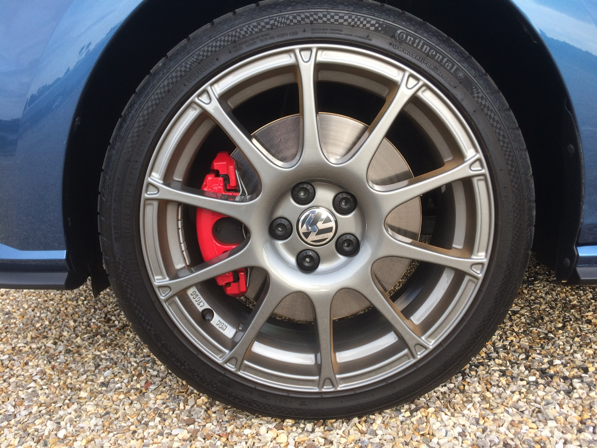

17” alloys will fit the Polo - The 6r / 6c Polo GTI and BlueGT came with 17” alloys as standard. I have these fitted to my Polo GTI (VW Motorsport in anthracite grey; 7Jx17 ET46);
