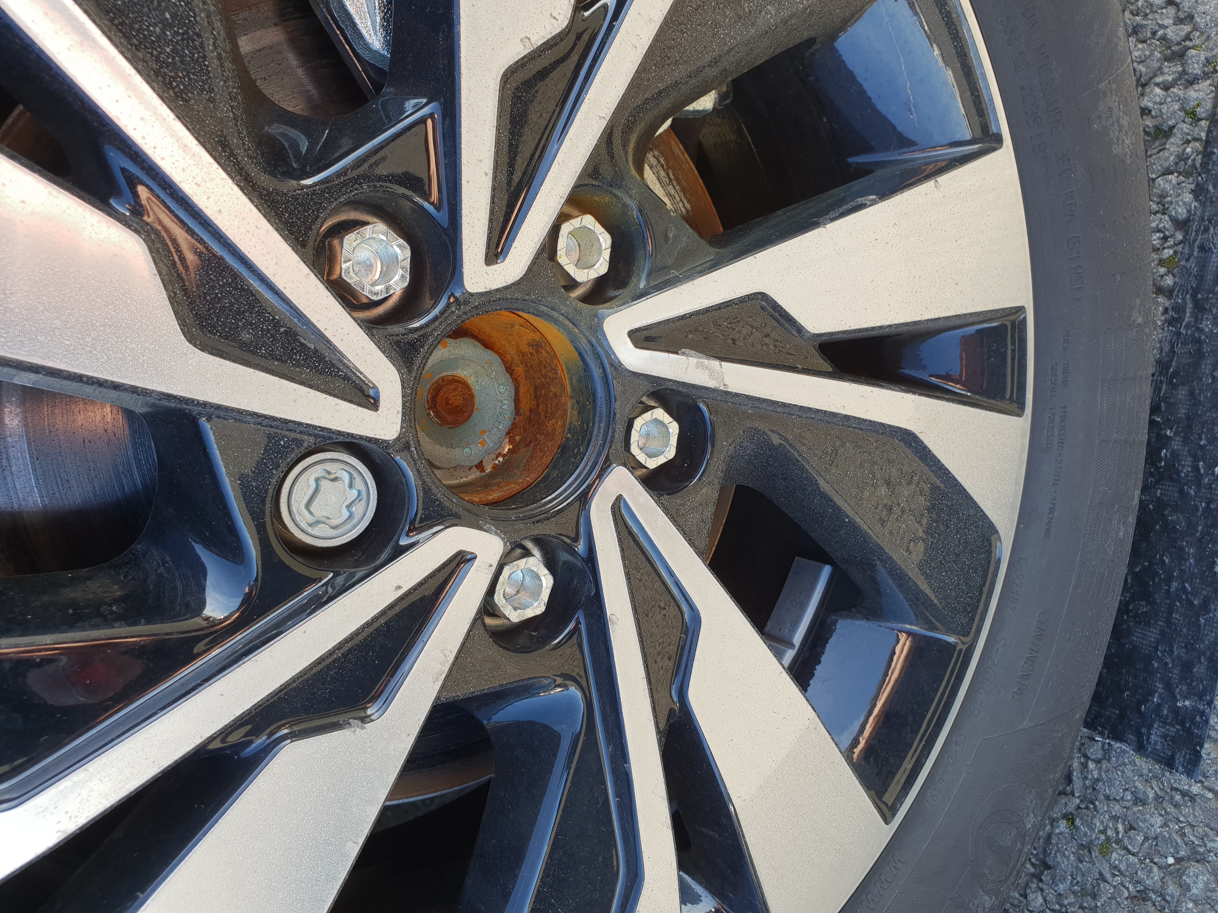

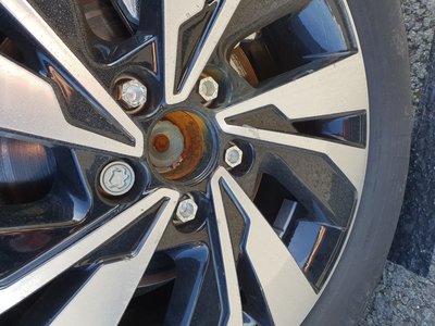

New Polo SE from Stock - How much hub rust is OK?
After being quoted 21 weeks on a factory build I opted for a stock car (same spec apart from wheels - unregistered at Grimsby) with only 4-6 wk wait time.
So the car is already at the Dealer approx 3 weeks after order. I couldn't hold my water and went looking to see if it had arrived which was probably a bad idea.
So I found my car at the back of the lot still with partial plastic wrap on and very dusty as would be expected.
But the thing that stopped me in my tracks was no centre caps on the alloys and very rusty hubs visible.
I know you get rust on the inner hub and brake discs if the car has been standing for any time but just wanted some feedback on this from more experienced buyers.
It looks as if the centre caps have been removed at some point between the factory and the dealer and the hubs have been left exposed to the elements.
OK, once they put new caps on I won't be able to see it but should I be bothered about this, or just let it go?
The car is going to be on a 3 year lease. I guess as long as it's not visible, doesn't cause any mechanical issues, and will not cause a problem when VWFS take the car back in 3 years it shouldn't be a big deal.
If I hadn't gone looking I guess I wouldn't even know about it!
But..... it's a new car! More importantly it's my new car!
So what does everyone think?

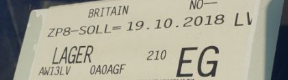

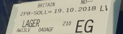

Another question is about the (presumably) customs sticker on the windscreen. Not sure if the date would be entry date to the UK or Exit from SA. Just trying to work out how long it's been sitting in a soggy field in Grimsby!

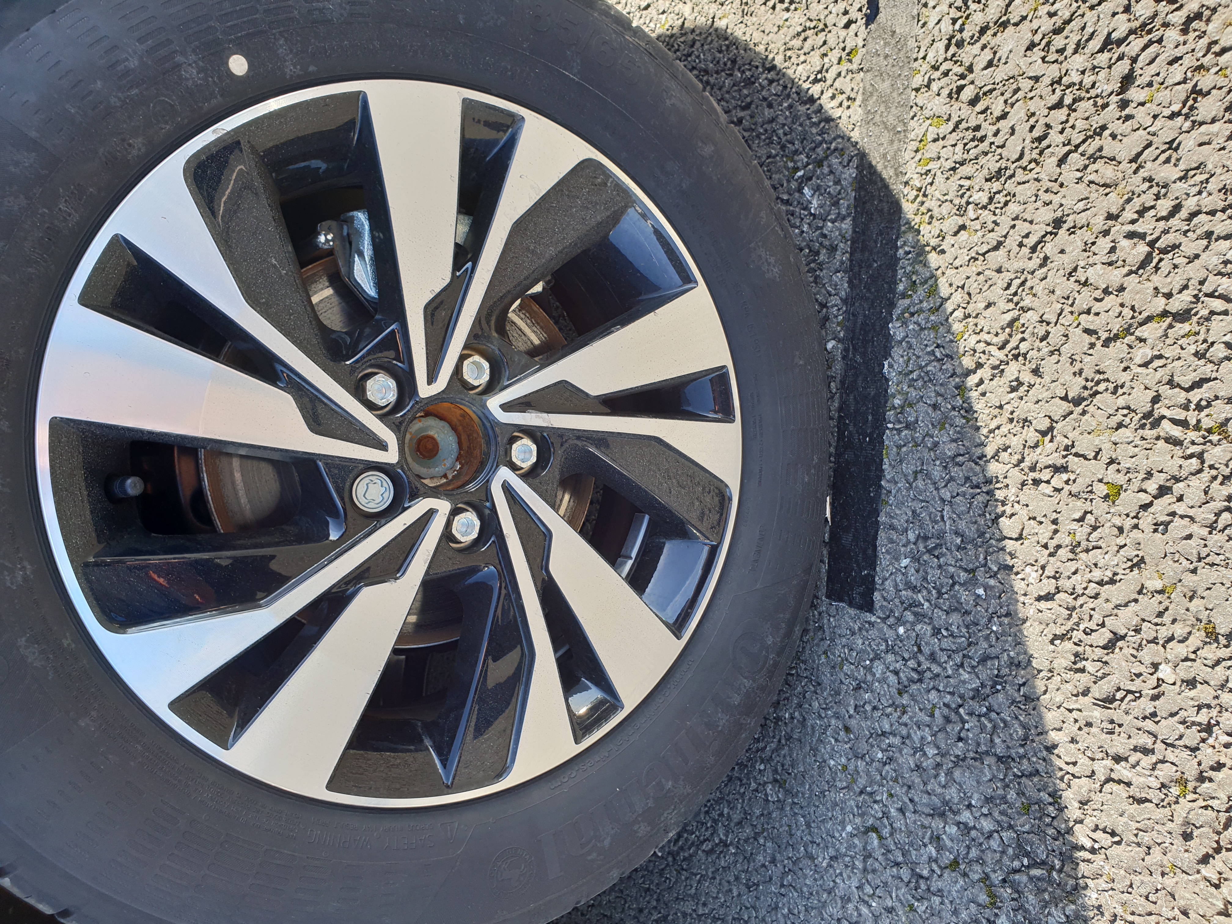

Mine could look like that behind the centre caps, for all I know.
Are the visible brake parts Ok, calipers/discs?
I wouldn't worry about end-of-lease, they only look for damage to wheels/bodywork etc.
Things like brake calipers/drums/hubs being rusty aren't considered 'damage'

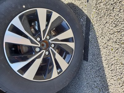

Re: New Polo SE from Stock - How much hub rust is OK?
This Might be a better picture for calipers/discs.

You're maybe just a bit 'premature' and all this will be cleaned up as part of the PDI.
With regard to the date on the sticker, even if that's the date it left SA it only takes a few weeks to get here.
So, yes, I would say your car has been sitting 'somewhere' for a while.

I’ve seen a number of ‘just delivered’ new cars on various occasions at the dealership I use (when I’ve taken my car in for servicing work). None of these have had the wheel centre caps fitted, so I don’t think they’ve been removed from your car - they’ve just not been fitted yet, but will be as part of the PDI before you take delivery.
There’s been lots of discussion on various VW forums during the lifespan of the mk7 / mk7.5 Golf on the subject of rusty hubs; primarily the visible part of the hub that you can see through the wheel spokes, rather than the centre of the hub that’s hidden behind the wheel centre cap. Some cars that are only few months old have visibly rusty hubs. If you do an internet search on ‘mk7 Golf rust hubs’ you’ll see it’s quite common. Owners who’ve raised this with their dealer have been told its ‘normal’, so if VW aren’t worried about it, then I don’t think you’ll have any issues with VWFS at the end of your lease in three years time.
I wouldn’t worry about it.

Mine are rusty like that (Polo GTI+) - but only on that centre bit. I have pics on the forum from when I was checking wheel arch liner clearance for wider tyres (search: arch lining, and you'll see the pics).
Centre caps are dealer fit at PDI so they don't get pinched on the journey to deliver.

Hum, yes on all counts!(with reference to Andy beats posting)
A newish model of an in demand car and it was probably built over 4 months ago.
I would not be concerned one bit about that rust as these parts get no corrosion protection, if concerned I’d get these wheels off as soon as you collect it and “paint” that central hub area with grease but not out where the flat area of the wheels contacts.

Most VAG cars get rusty hubs in no time so like Tom Jomes 'it's not unusual'.
If you're getting a new car best thing to do is remove the wheels, one at a time give the hubs a good rub with wet and dry, wipe with white spirit or meths and paint the hubs with Smoothrite. Drys very quickly and will last and look smart for many years.
If it's a used car then do the same but try and remove as much of the rust that is there before painting.
The area shown on the images above dont need painting, when you have the wheels off, just rub the area with a little grease, it will soak in to the rust make it look black and stop it rusting any more.
One very useful tip, a thing to do whether you're painting hubs or not, is if you are taking the wheels off just put a smear of grease on the hub where the centre of the wheel sits, that way when you come to remove a wheel for a puncure etc the wheel comes off easily and doesnt need to be beaten.....
