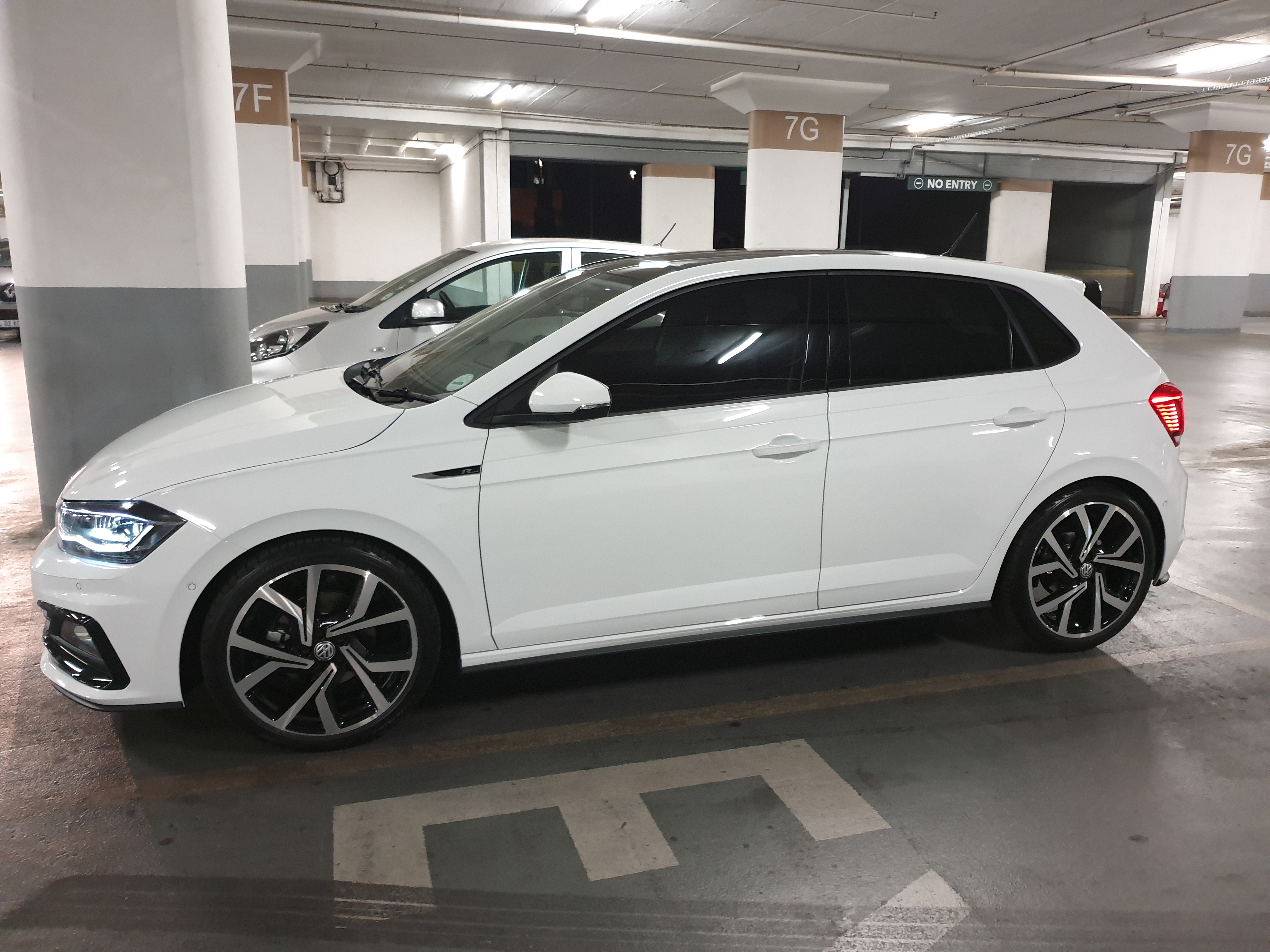

Polo GTi

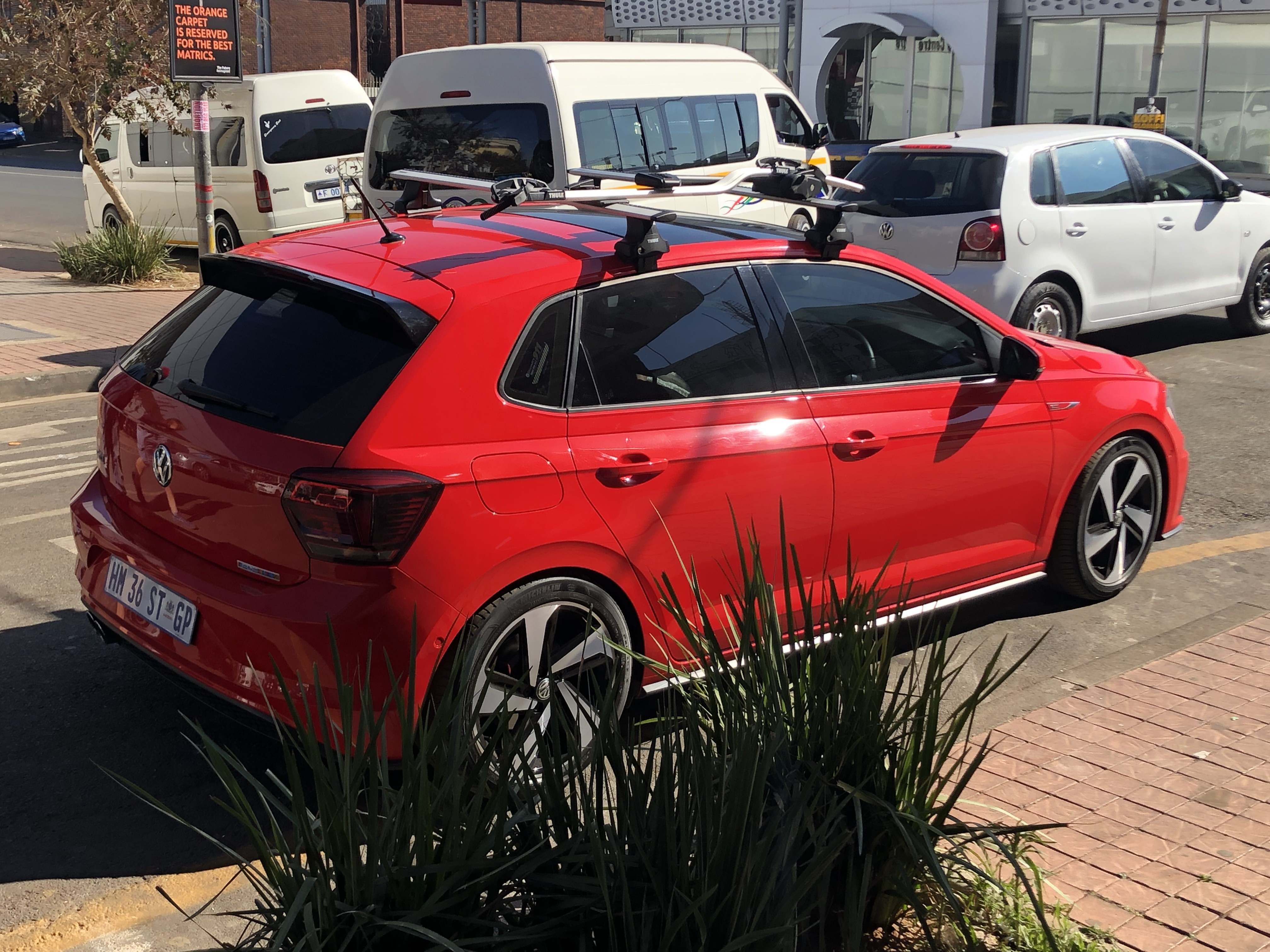

Polo TSi RLine with spacers

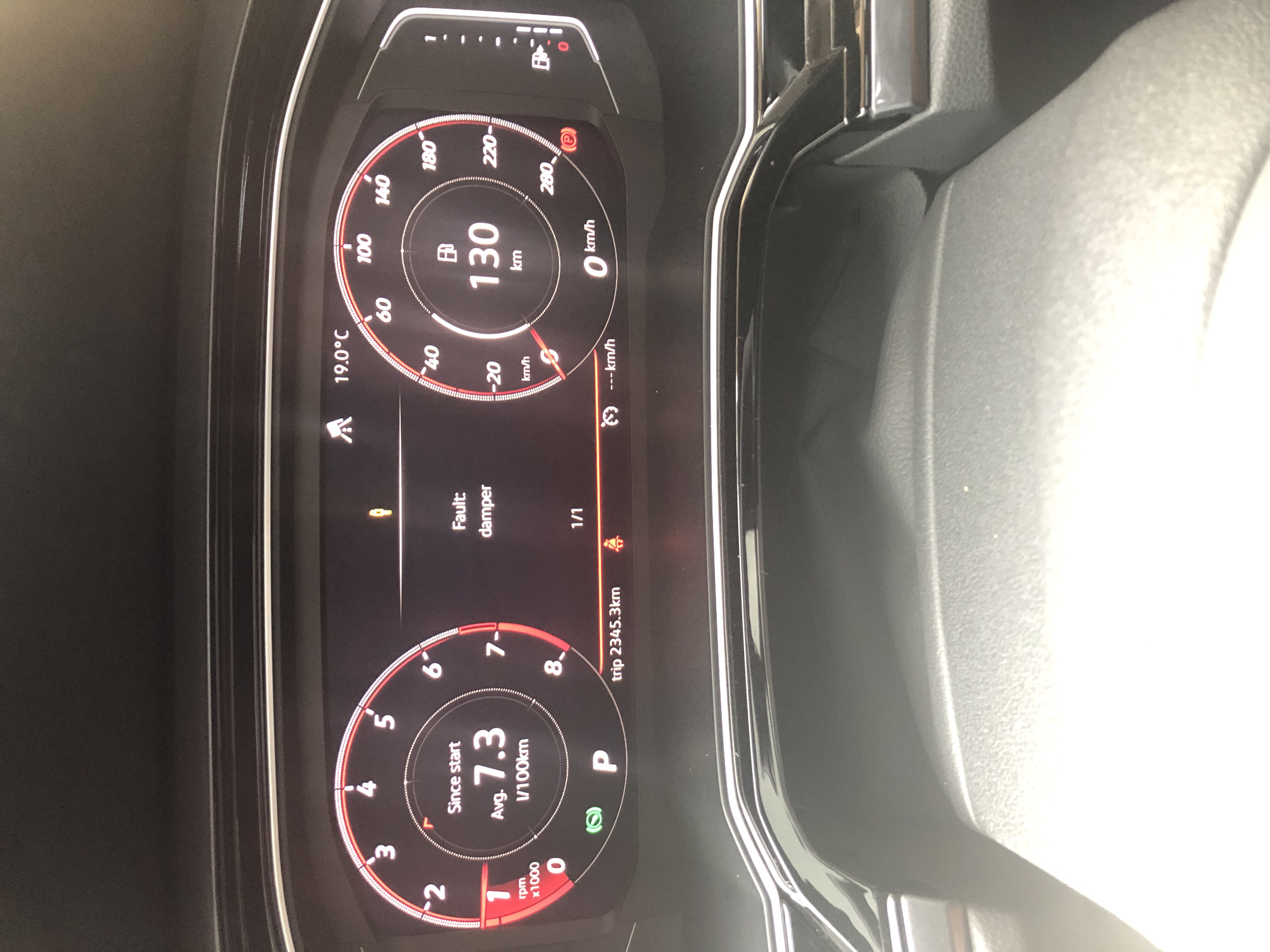

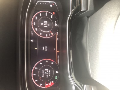

Folks, I just fitted my POLO GTI 2018 model with H&R lowering springs and H&R Wheel spacers (15 on the back and 12mm on the front). After the fitment now I hav a error on my car damper sensor/ error appears on my car. None of the VW technician can help me.

Check if the sensor on the top of the two front struts is connected.
Maybe it's not.
