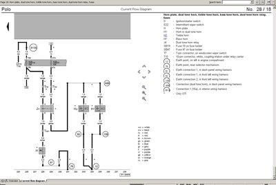

by 937carrera
It doesn't make sense that the fuse is blowing when the relay is removed. look at the wiring diagram below and confirm the car is wired as original.

With both horns removed it still blows fuse 47 which from the diagram above is the horn.
Relay 95 removed, and relay 100 in place, fuse does not blow.
one thing I have noticed is that where relay 95 goes there doesnt appear to be any connector to the middle pin on the relay, but from looking at the relay it looks like there should be??? any one able to confirm that the middle pin of 95 should be making contact with something?? maybe I have pushed that pin out by mistake when I put the relay back in?

by dipstr
Right I have had a quick.look at wiring diagram. Remove the horn relay then check that you have the lives to the relay. If lives are present then would suggest remove air bag and check wiring in steering wheel. The horn plate is part of the slip ring and you should have a contact from rear of steering wheel to slip ring. You will also need to remove steering wheel to check condition. If all looks ok then try bridging horn plate and see if horn sounds/fuse blows..if it blows fuse then you have a wiring issue from slip ring to relay
