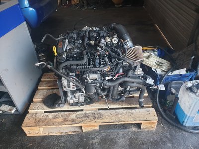

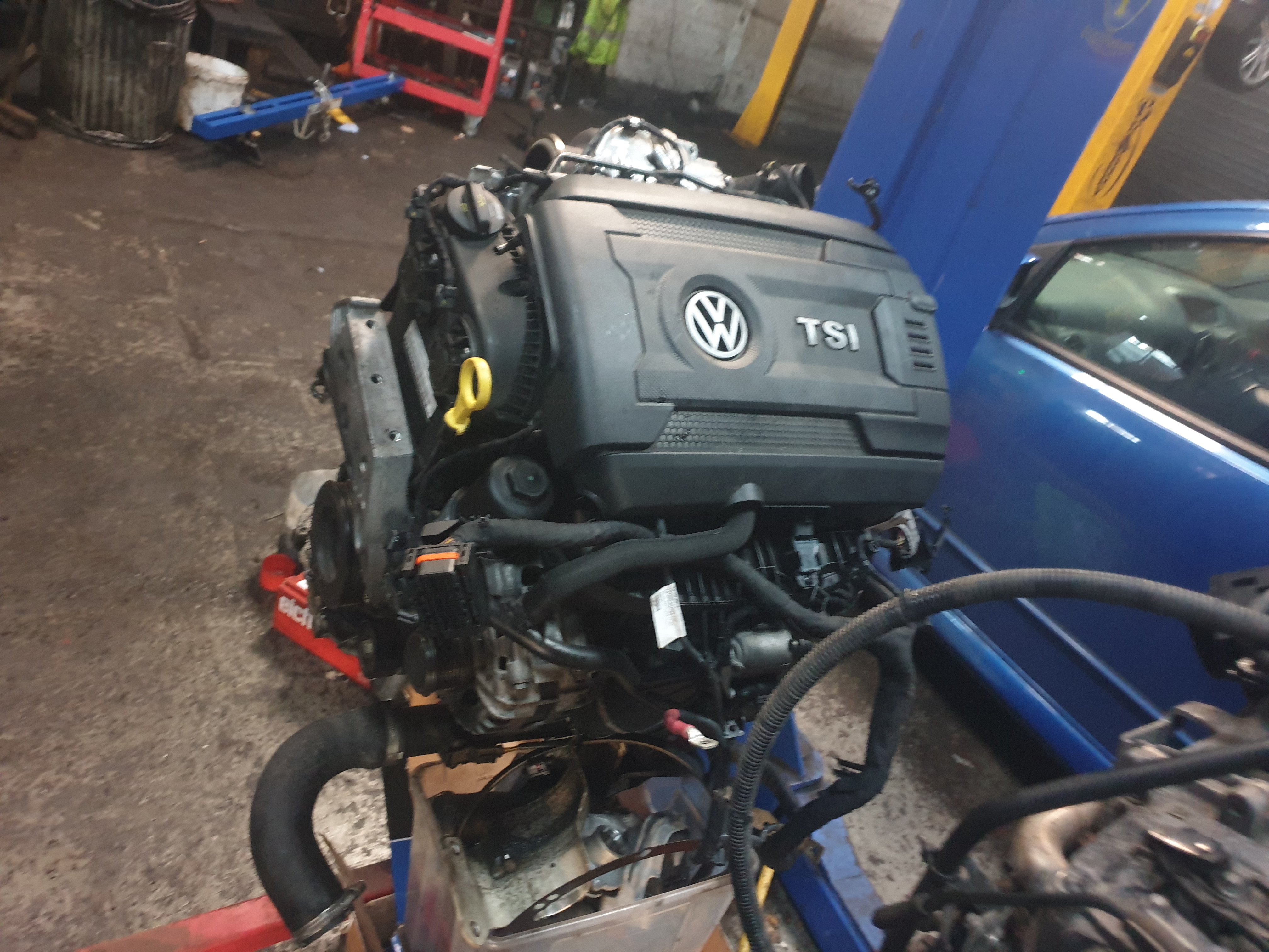

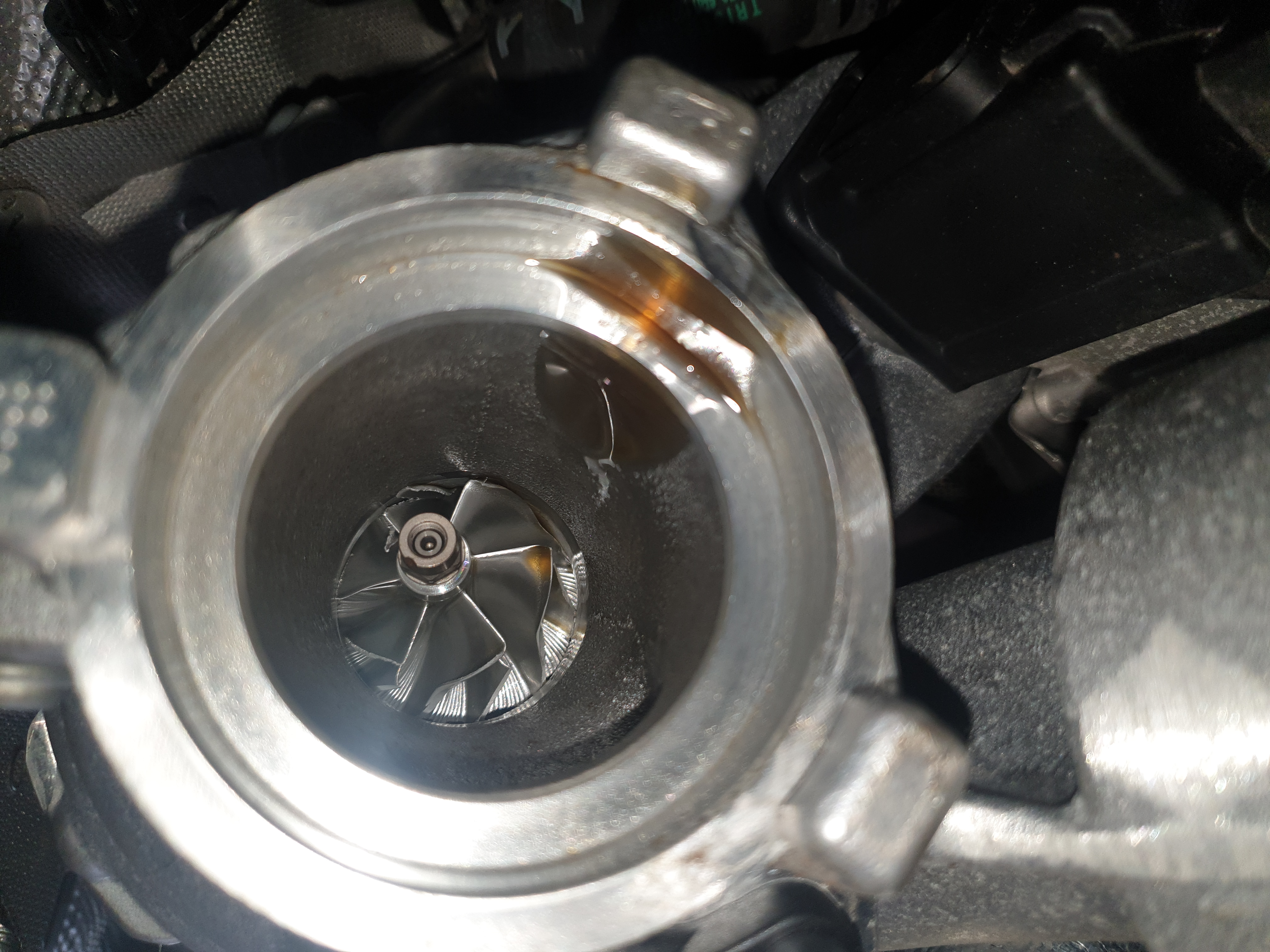

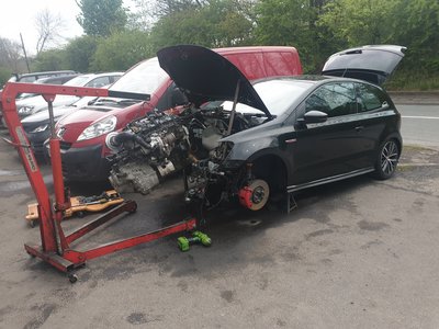

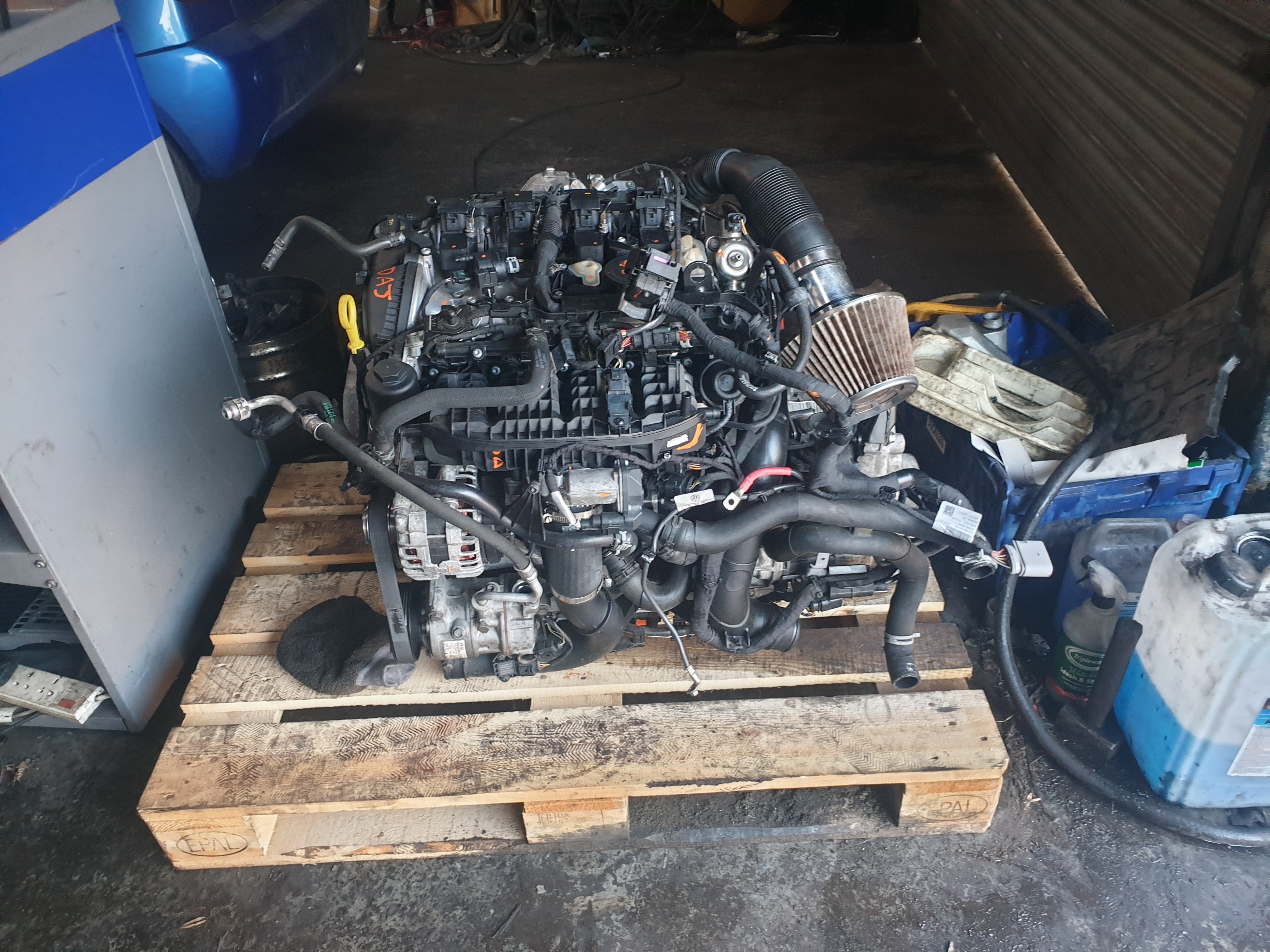

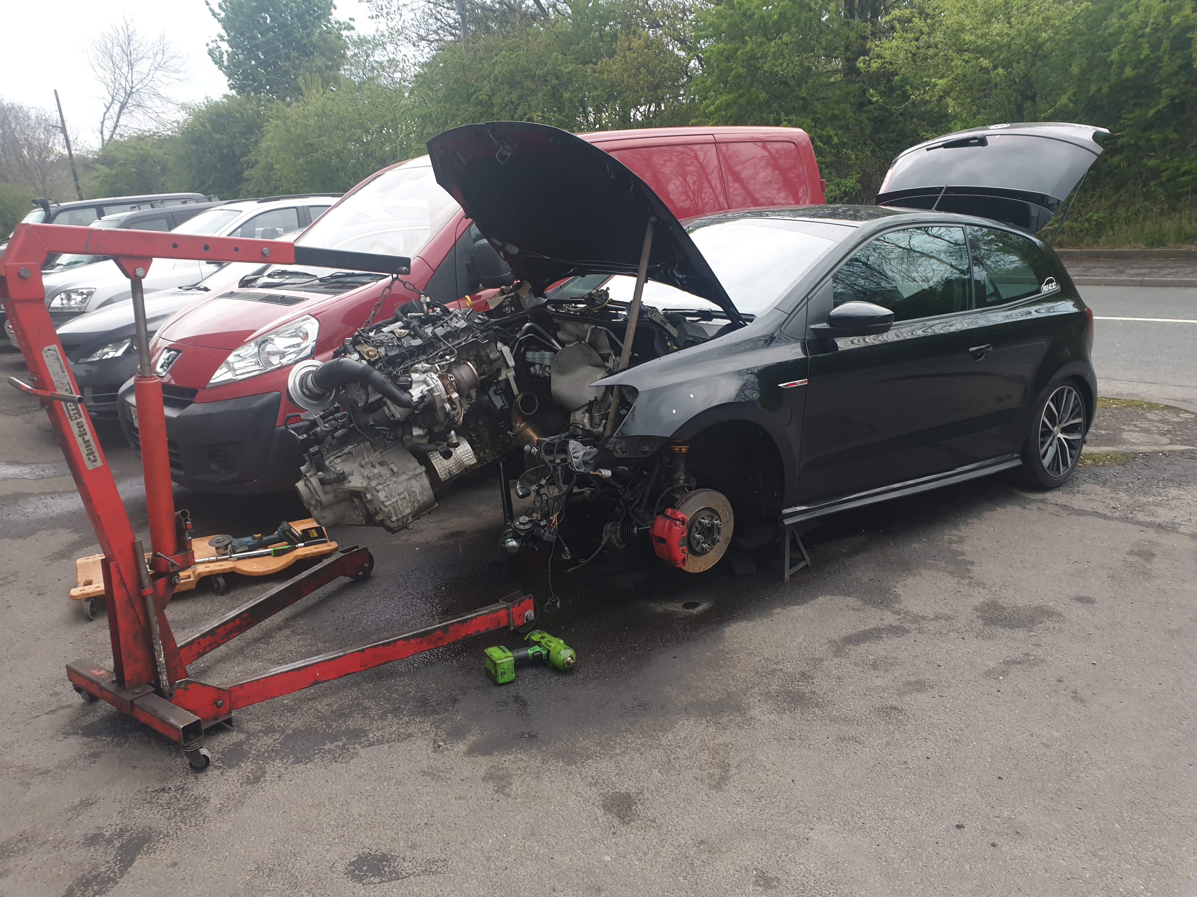

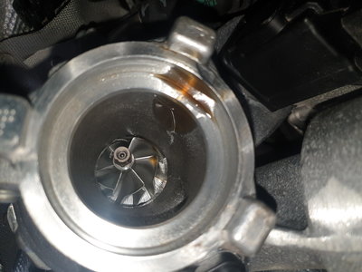

I've just put a new 1.8 tsi lump in my polo due too blowing a rod too find the turbo has s**t its self aswell is there any bigger turbos that just drop on like golf GTI and R hell would be great as going tomorrow too pick one up from a breaking yard. Cause if I'm right the stock turbo is an is12 ??

the is20/38 turbos are pretty much a bolt on upgrade.
any thing with a ea888 gen.3 engine should fit
