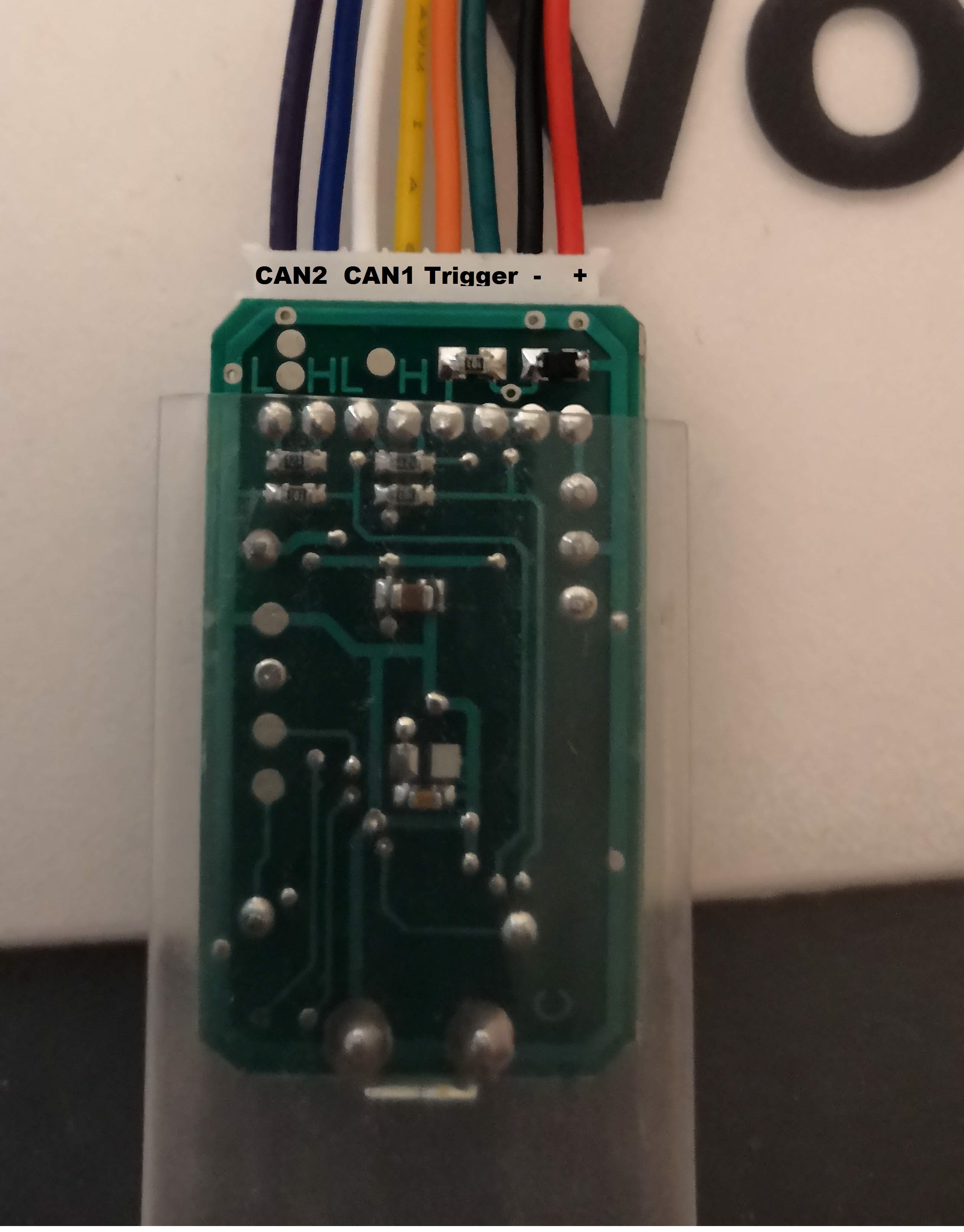

Gra-high will work by external unit - the CAN emulator. That CAN emulator genarates data for gra high into the instrument cluster's CAN bus. In this case the hardest work to write the right code for emulator for correct gra high indicating of all cruise control modes: ccs on, ccs off, ccs on&active&stored_speed, ccs on&inactive&stored_speed)
In my case I used CAN filter. I bought it in Russian Internet shop ecutools.ru.
My friend provided tremendous work in developing the code for can filter, and it now works.

The device is CAN filter, but in that case it works in emulation mode

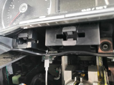

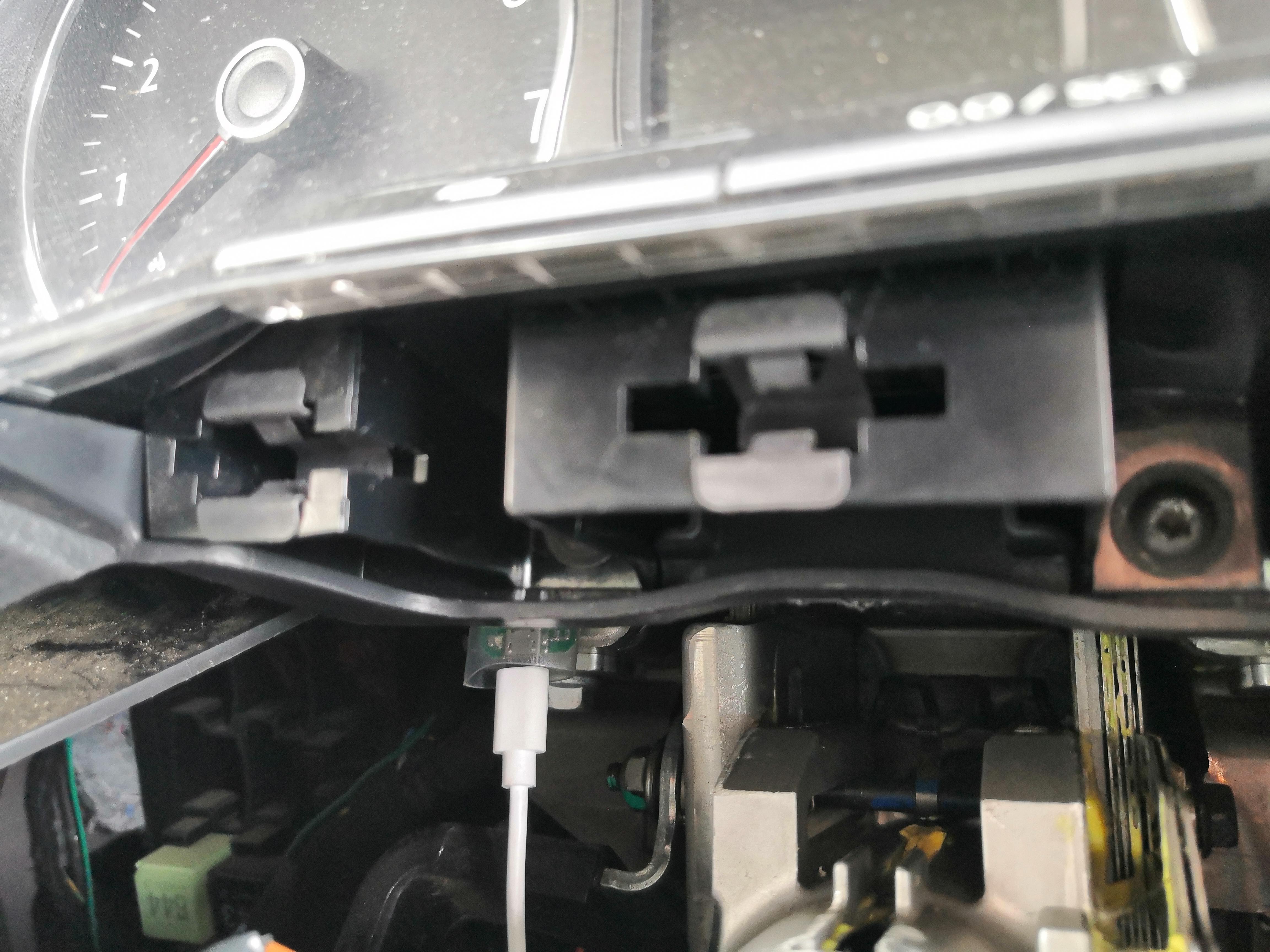

The CAN filter has an microUSB socket for loading the logic by the PC. After connecting to the cluster CAN wires and power wires (15 terminal and ground) it looked like on the photo. USB wire used often while testings.
