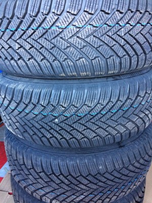

by Boxerboy
Man in dealer confirmed normal valves are what we need, so got my new Conti TS860s fitted to a set of Las Minas wheels today.
2x LH plus 2x RH. You do have to remind some of the tyre monkeys. I did once receive 4x RH tyres.
Can't believe how quickly wheels arrived all the way from Germany.
In fact, the MyTyres tyres arrived quickly from a far away place also, Glad to see they are week 41 2019. Newest I've ever had.

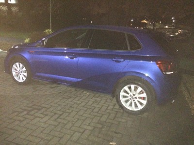

Posted: Sat Jan 18, 2020 11:28 pm
by Boxerboy
Boxerboy wrote: Mon Dec 09, 2019 6:27 pm
I’m planning on winter tyres and have acquired a set of VW 16” rims.
Can you get away without sensor valves?
If not, which valves come recommended?
I guess a VW packet will be dearer than ECP or any other supplier.
Swapped over today.
