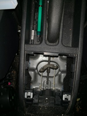

Your help on this would be very much appreciated as this one has me stumped. The driver's side rear drum brake binds, but the left side does not. I discovered this when I replaced both rear drums and when I reset the show auto-wear adjustor on both, no matter how I fiddled with it, I end up with the situation whereby if the right one can spin freely, the handbrake goes to high, if I wind in the handbrake nut by the yoke, the right rubs enough to not spin and but the left spins freely with a slight scrap.
The yoke is at an angle,
Yoke
Yoke
With the right side clearly pulling up more than the left. Despite slacking the nut off, setting the auto-wear adjustor back to the thinnest part of the wedge and then pressing the brake pedal, the yoke stays at the angle in the pic. I don't know if this is a normal angle, if the cable is stretched, or if it is the cause of the right side binding first (seems to me, the last is more likely]. I tried holding the left side wedge up with a screwdriver while letting the right side auto adjust first, but that didn't work. It did correct itself once, but could not get it to that again...
Anyone got any ideas as to what it could be, and what the fix is - many thanks for your help in advance.

Yes when the equaliser yoke ends up like that things are not right!
