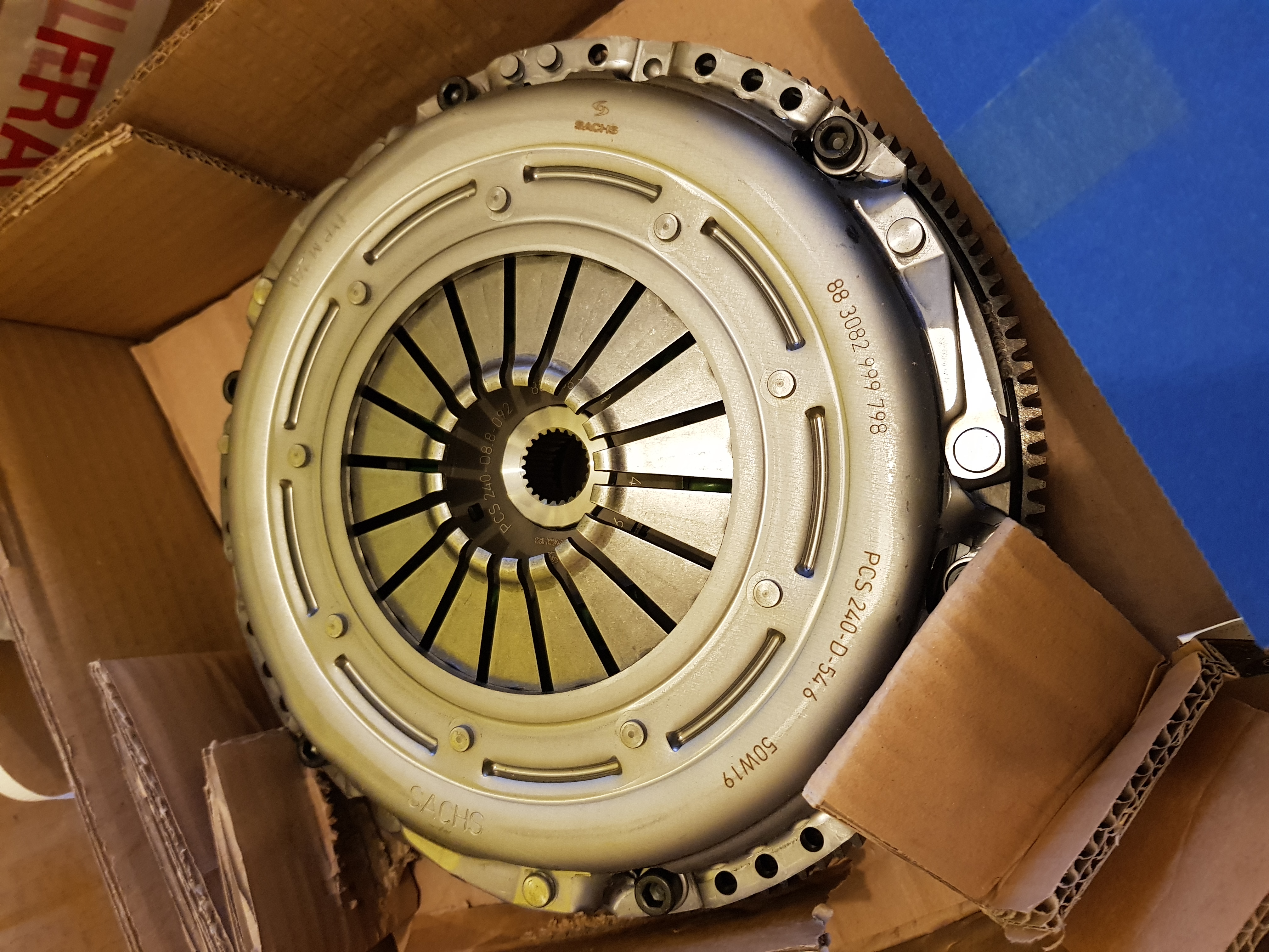

Mine has started to slip at 23k miles.
The 1.8 tsi has a decent amount of torque for a petrol (albeit turbocharged)
I'm going to fit an is38 turbo so fitted this below.

The sachs organic replacement seems to be a fairly reliable upgrade and also RTS clutch seems to be alright aswell
This is for the manual obviously as the DSG is completely different issue.
