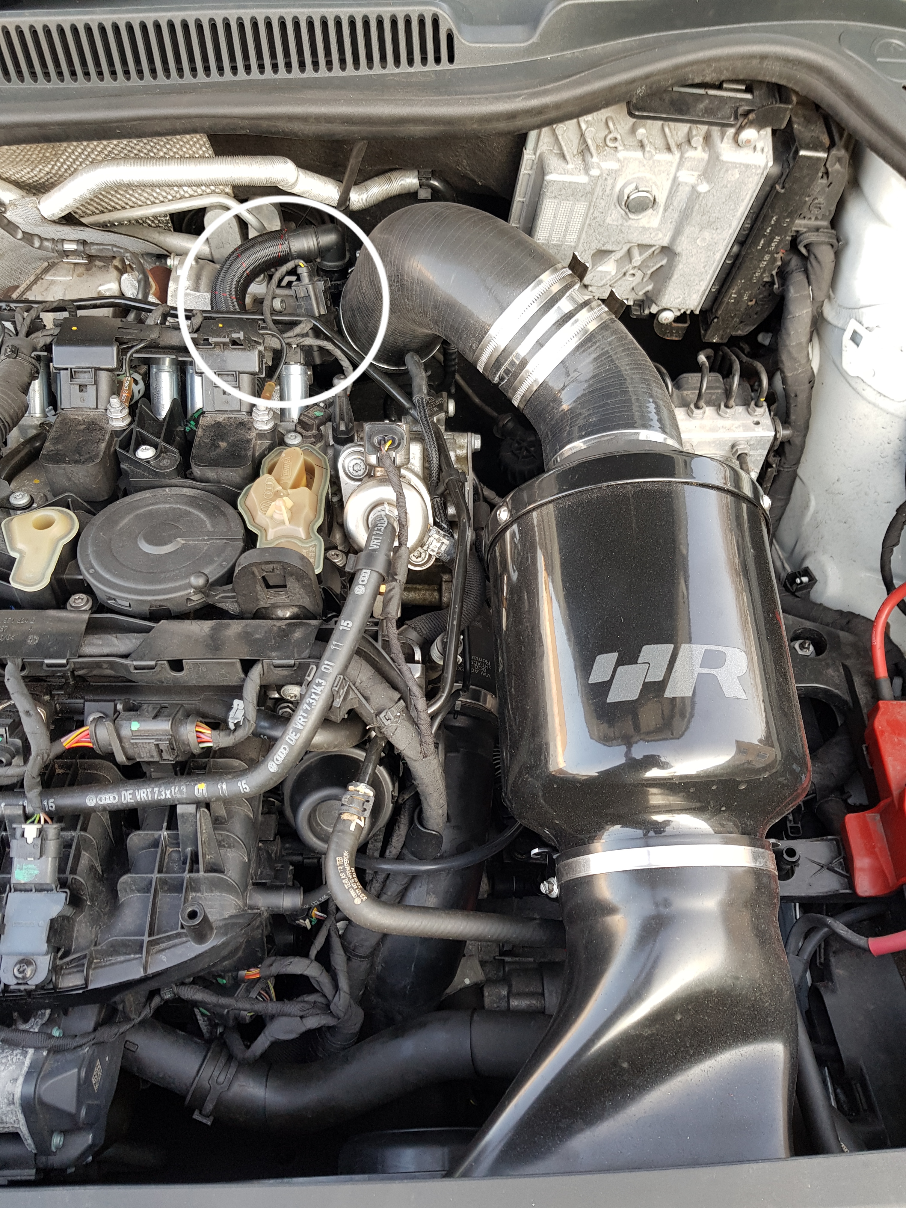

Hi
I've fitted the racingline intake on my 2015 gti but wasn't happy with small elbow fitted stock.
So looking into it i found that all the turbos have exactly the same dimensions for attaching everything.
So a racing line elbow fits no problem but you need the breather hose off a golf R as it attaches to the underside of the elbow rather than the top side.
This also goes for muffler delete fitting any turbo is12,20,38

no if you get a polo specific intake it will probably only fit the smaller elbow
racing line do a kit that comes on top of the intake but imho it's pointless as you are left with a useless silicone hose
that is why i fitted my own silicone hose to the racing line elbow
you will need the breather unless you find a larger elbow specific for the polo
