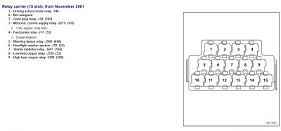

Hi All
Had the error code 179834 and just replaced the purge valve but after clearing the code, after a few miles, the light has come back on so my next move is the relay but where is the relay?
Any photos much appreciated as when looking on the internet, its a minefield and so much on Golfs etc
Thank you
Andrew

Hope this helps

Thank you Iichel, this is very much appreciated
Are they located under the dash on the drivers side? Easily accessed?
Cheers
Andrew

by Bepis
This should help to locate the relay box but no mention of a relay for the purge valve.

Thanks Bepis
Yes, it has been difficult to find things electrical for purge valve, it seems to be more related to fuel pump stuff
Cheers
