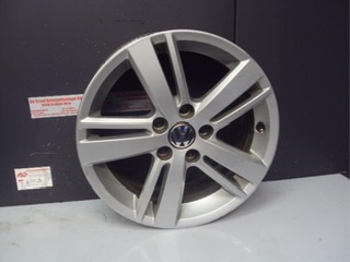

I think the standard alloys on a 2016 Polo Match Edition was a design called ‘Stratford’ - as per picture below;
VW do sometimes have the same design of alloys in different sizes for different models of vehicle. If you do an internet search on ‘VW Stratford Alloy Wheel’ you’ll see that VW fitted this design of alloy to certain models of the Golf, Sharan and possibly the Touran, which might explain the different manufacturers (possibly VW used a different manufacturer for each different size?).
The Polo version of the Stratford alloy was a 6Jx15”, PCD (bolt pattern) 5x100, centre bore 57.1 and offset ET40. Part number is 6R0601025AB
The Tosa alloys should also fit; they’re also a 6Jx15” alloy. PCD 5x100, centre bore 57.1 and offset ET40. Part number is 6C06010258Z8
The Spokane for the Polo is the same size, bolt pattern, centre bore and offset as the Stratford and Tosa wheels. Part number for the Spokane is 6R0601025AK
So with any luck, it’ll be one of the above and you’ll be able to find some in good condition at a reasonable price. Good luck with your search.

It’s the Stratford design in your pictures but I see the same design described as Borbet and Spokane. Maybe they are the manufacturer?

Borbet are definitely an alloy wheel manufacturer rather than the name of a VW alloy wheel design. Borbet manufacture both aftermarket alloys and original equipment alloys for a number of car manufacturers, including VW.
Spokane and Tosa are the names of two of the styles of VW alloys - if you search on the part numbers in my previous post, you’ll see some (but not all) of the wheels in the search results described as Spokane or Tosa. It looks as if the eBay sellers at the links you included in your post have mistakenly named the Stratford alloys as Spokane and Tosa - confusing, but easily done as they are similar 🥴🤔.

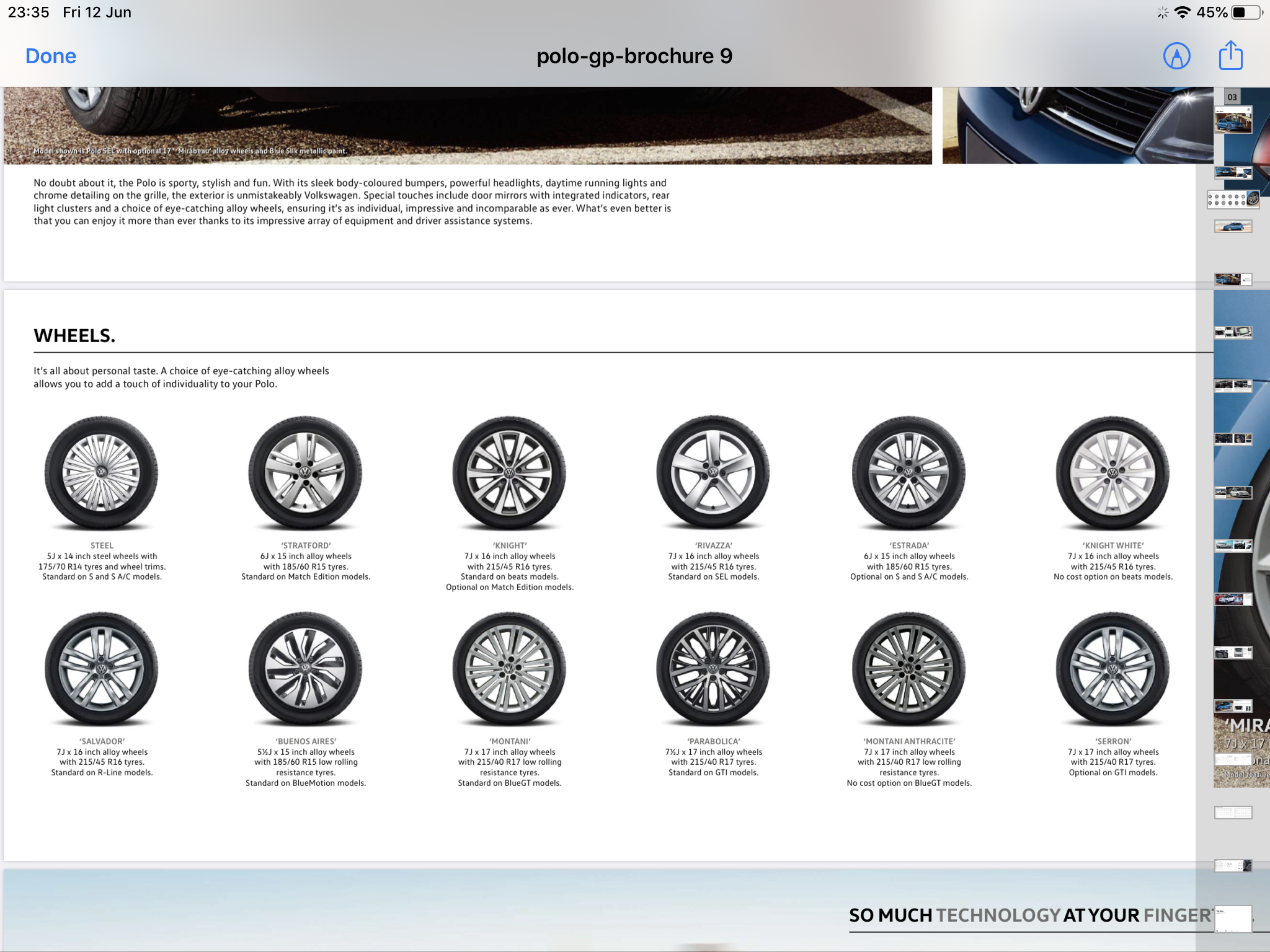

The screenshot below is from the June 2017 Polo brochure, which shows the Stratford alloys as the standard wheels for the Match Edition (top row, second from left - click on the image for a larger view).
I wasn’t able to find a 2016 edition of the Polo brochure on the internet, but I had a look in the used cars section of VW’s website at 2016 Polo Match cars for sale, and they also do all seem to have Stratford alloys - the same as the later (2017) Match Edition does.
