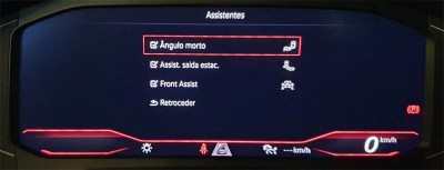

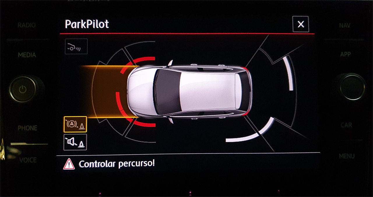

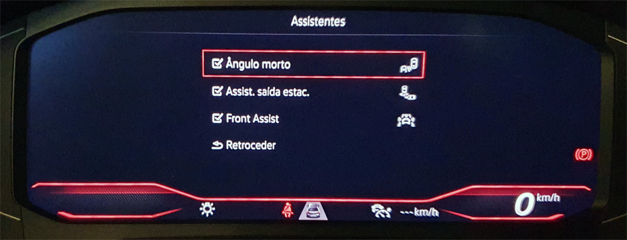

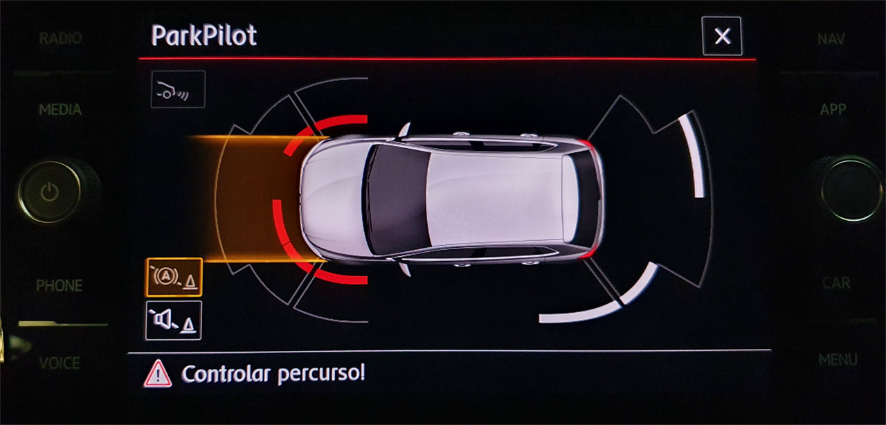

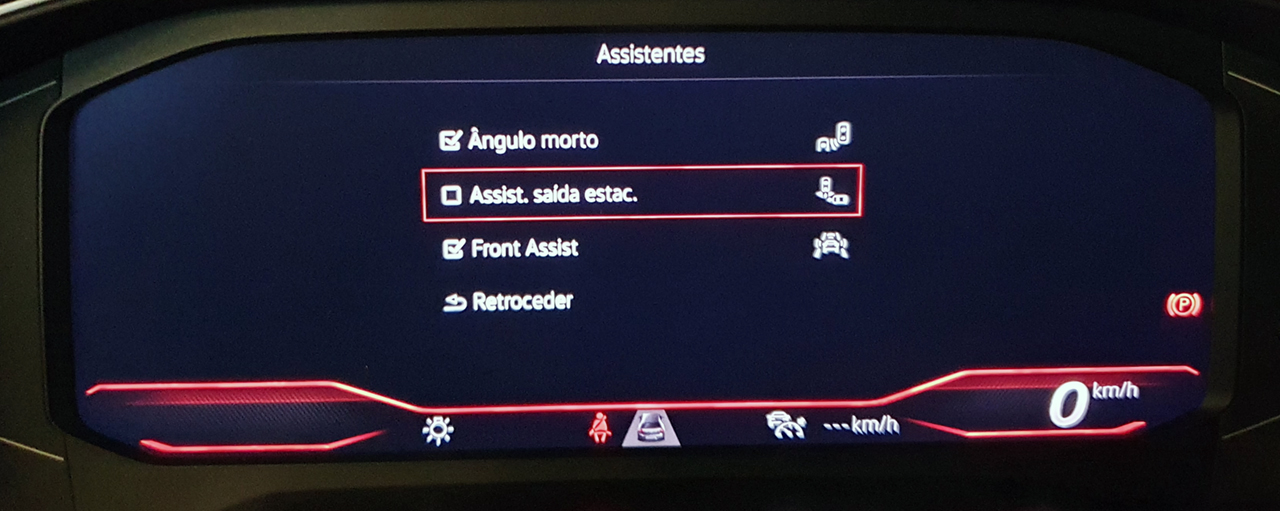

After finding out if there was a possibility to turn off this function while doing the maneuver I found this...
I don't know if anyone had noticed but in the assistance menu we can turn off some of the functions.
No more problems with reversing maneuvers, not the perfect solution but no more scares and sudden braking.:D
