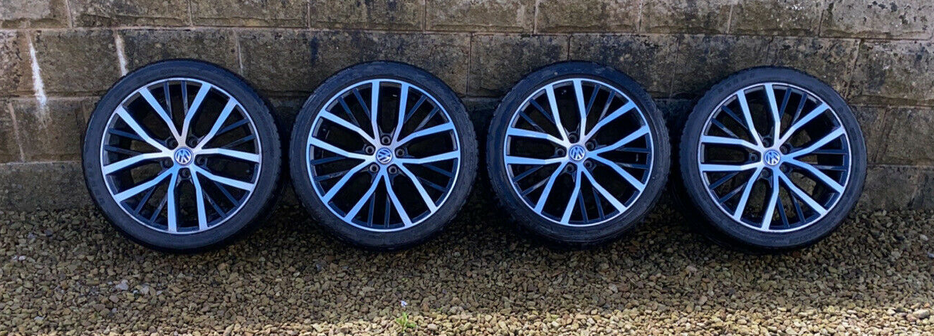

I've recently bought a Polo GTI but it doesn't have the alloys I wanted. I bought it becuase it had great spec, good mileage and in my budget.
I've attached an image of the alloy I want. What are people's views on buying alloys off ebay? There's a couple of sellers who sell other alloys and have businesess. Would the quality be okay, considering they aren't original VW?

The wheels you posted are stock 6c GTI wheels so as long as they are genuine and are not bent then should be fine.
One word of caution though is that they are s**t lol they look nice for a couple of months then go to s**t. Diamond cutting can only be refurbished once iirc so you will either have to get non refurbished ones and get it done or get refurbished ones and hope they last.

As @Dink has said, they look like the standard fit alloys from the 6c Polo GTI.
When considering buying used alloys, always ask the seller if they’ve had any structural repairs - e.g. if they’ve suffered any cracks or buckling from hitting a kerb at high speed or from pothole damage. I’d also be asking if they’ve been cosmetically refurbished - especially with diamond cut wheels as the diamond cut refurb process involves re-cutting the face of the wheel. If too much metal is removed, then the structural integrity of the wheel could be compromised.
Also ask to see a photo of the reverse of the wheel so you can see if they’re genuine OEM wheels. If they are, then details such as the size (7.5J x 17” ET44), part number (6C0601025K), VW logo and manufacturer’s name should be stamped into the reverse side of the spokes.
Also, if they’re in need of refurbishing, a high quality refurb job will cost in the region of £80-£90 +VAT per wheel, and some refurb places charge extra to remove and refit the tyres.

All of the 17" Parabolica alloys (found out the name) I showed before are labelled as 'GTI style', so none are genuine OEM.

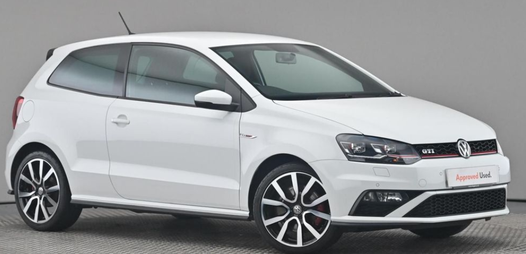

I never knew that about diamon cut alloys, but makes a lot of sense! Attached are the current alloys (not my car), which I assume are also diamond cut, the front 2 were refurbed before I bought it.

Definitely not genuine vw alloys as the offset of parabolica wheels is et44

@jackdanes; Yes, the wheels on the White Polo in the picture are diamond cut. If they’re genuine VW OEM, they’re the optional Serron alloys that could be specced on the 6c GTI as a factory fit extra cost option. They were 7Jx17” with an offset of ET46.
In terms of VW OEM Serron v’s Parabolica; the Parabolica alloys are slightly wider with a slightly more aggressive offset than the Serrons. However, the design of the Parabolica alloys, with a second set of (black) spokes recessed back from the face of the wheel, they are a more intricate design, and so more difficult to clean, so something to consider if you’re into car detailing and / or regular car cleaning.
