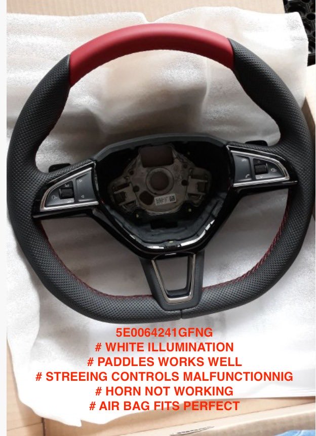

I thought it would be direct fit which makes all functions work well but unfortunately having the below issues.
After installing the new wheels paddles works fine
1, Horn not working
2, steering controls not functioning proper
a, left volume roller UP/DOWN increases volume in Head Unit
b, Right roller UP/DOWN increases volume in Head Unit
c, Left volume straight press works as Volume increase in Head unit
d, Right Roller straight press works as Volume decrease in Head Unit
e, all the other call, track change buttons are not working.

tried installing these buttons on the steering with stock air bag loom and 5E0971584A air bag loom, has the same issues
1, Horn not working

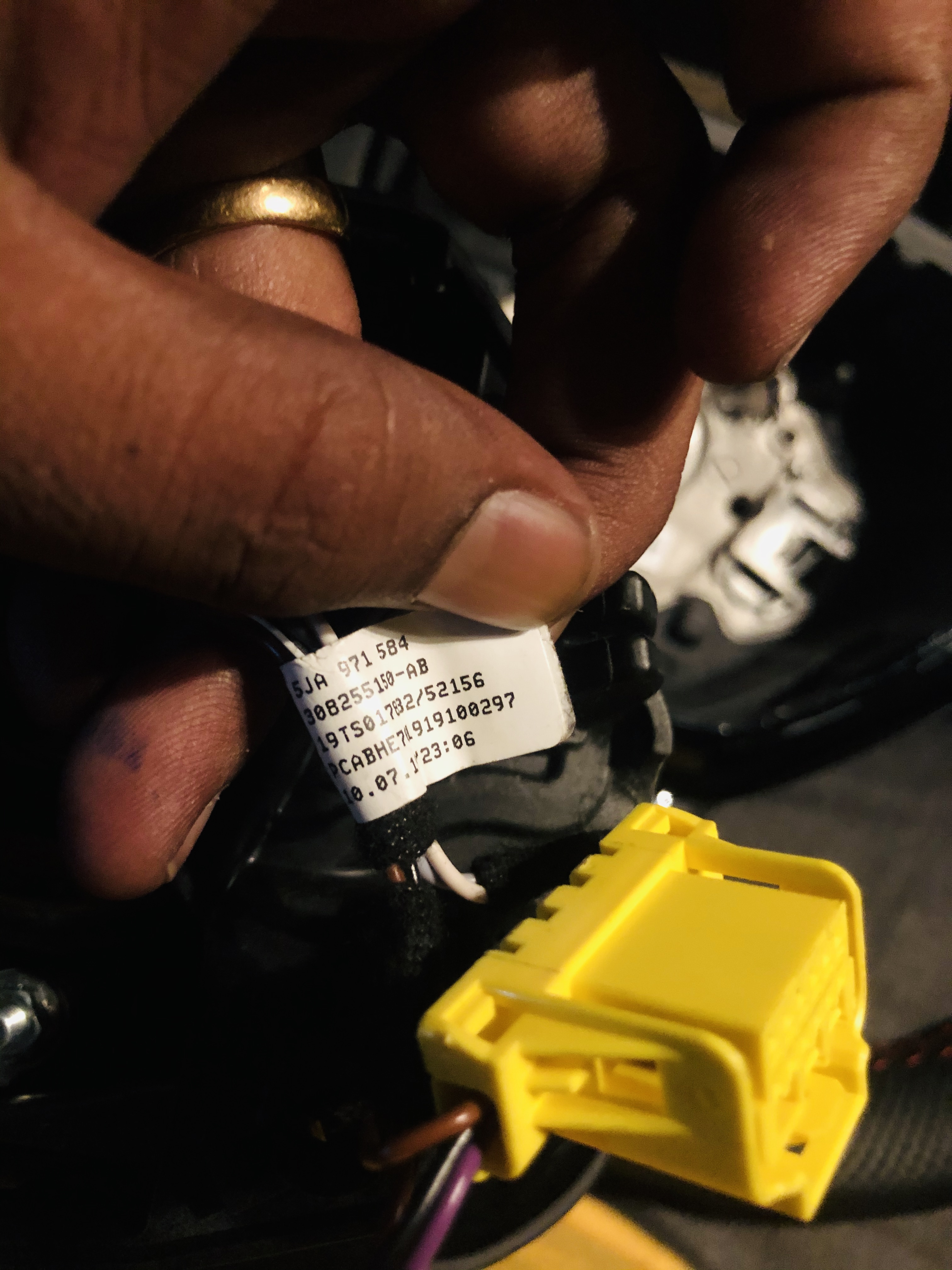

Re: NEED STEERING CONTROLS AND PADDLES FOR SKDOA RAPID PQ25

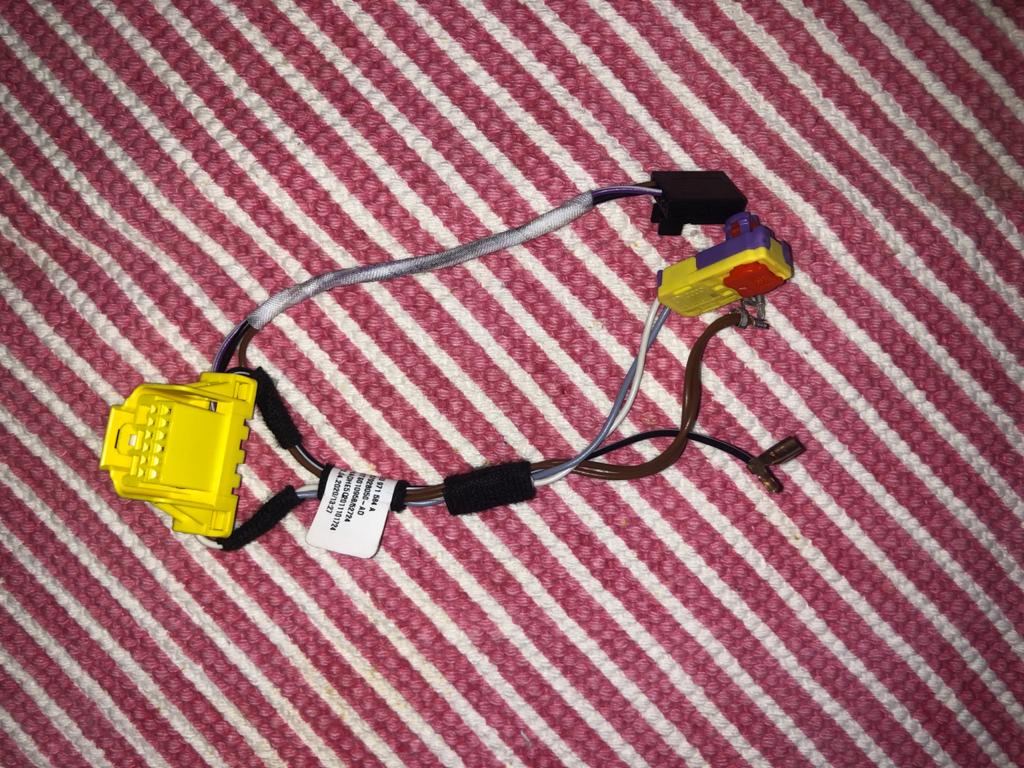

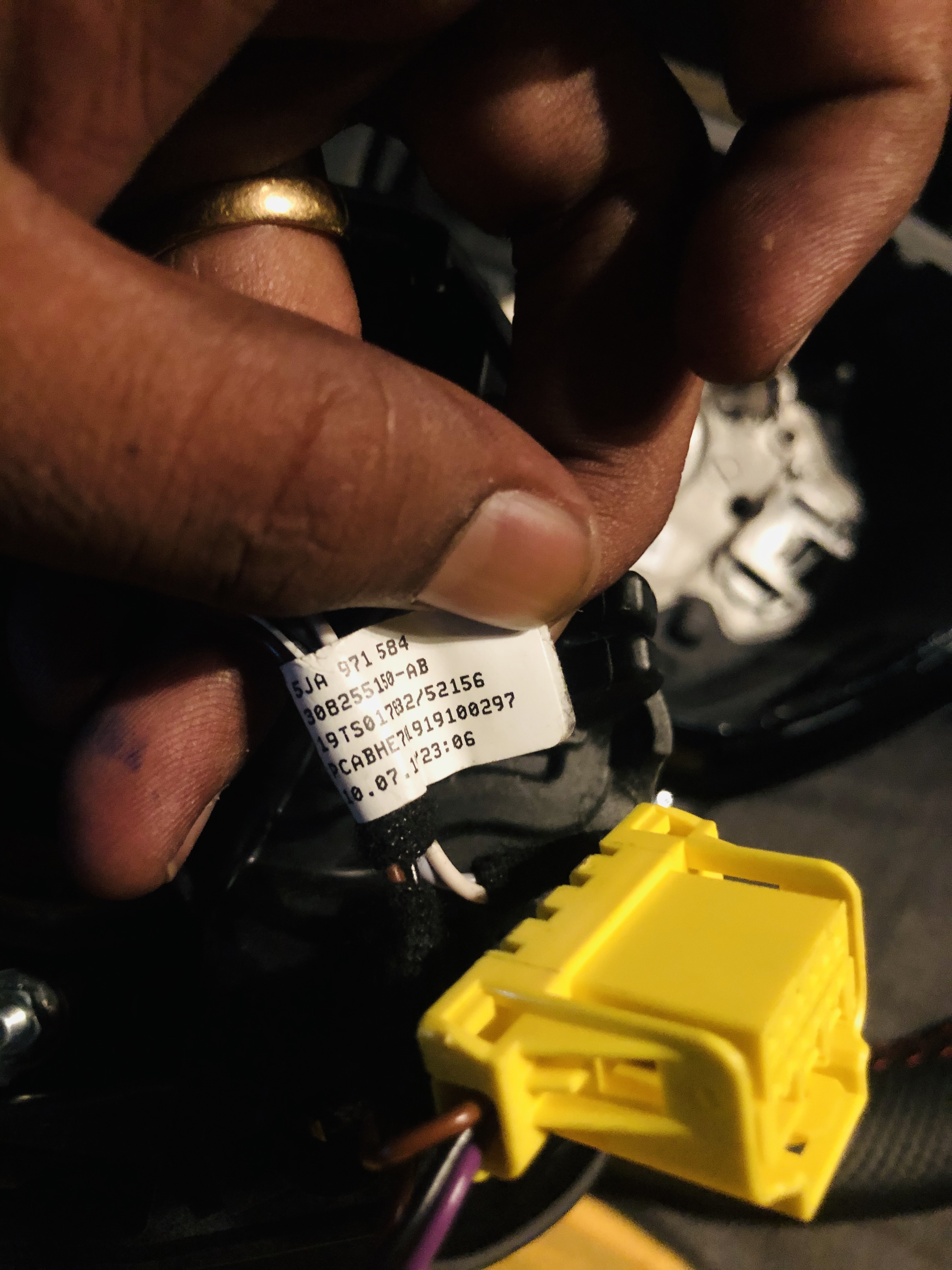

Could you please show an image of your airbag wiring harness? I suspect that there lies a problem for your horn not working.
- Posts: 8907
It is difficult to understand why the horn does not work with the original airbag and the original airbag wiring. Something is wrong with the airbag wiring ... check the connections.
Take several pictures of both wiring looms. (original and new)
Pay particular attention to the wires that arrive to the black connector for the buttons.
ciclo wrote: Tue Aug 11, 2020 7:56 am It is difficult to understand why the horn does not work with the original airbag and the original airbag wiring. Something is wrong with the airbag wiring ... check the connections.
Hello Sir
Please find the attached images as per your request , and also if you are not clear in the image I can send more but need to remove steering again.

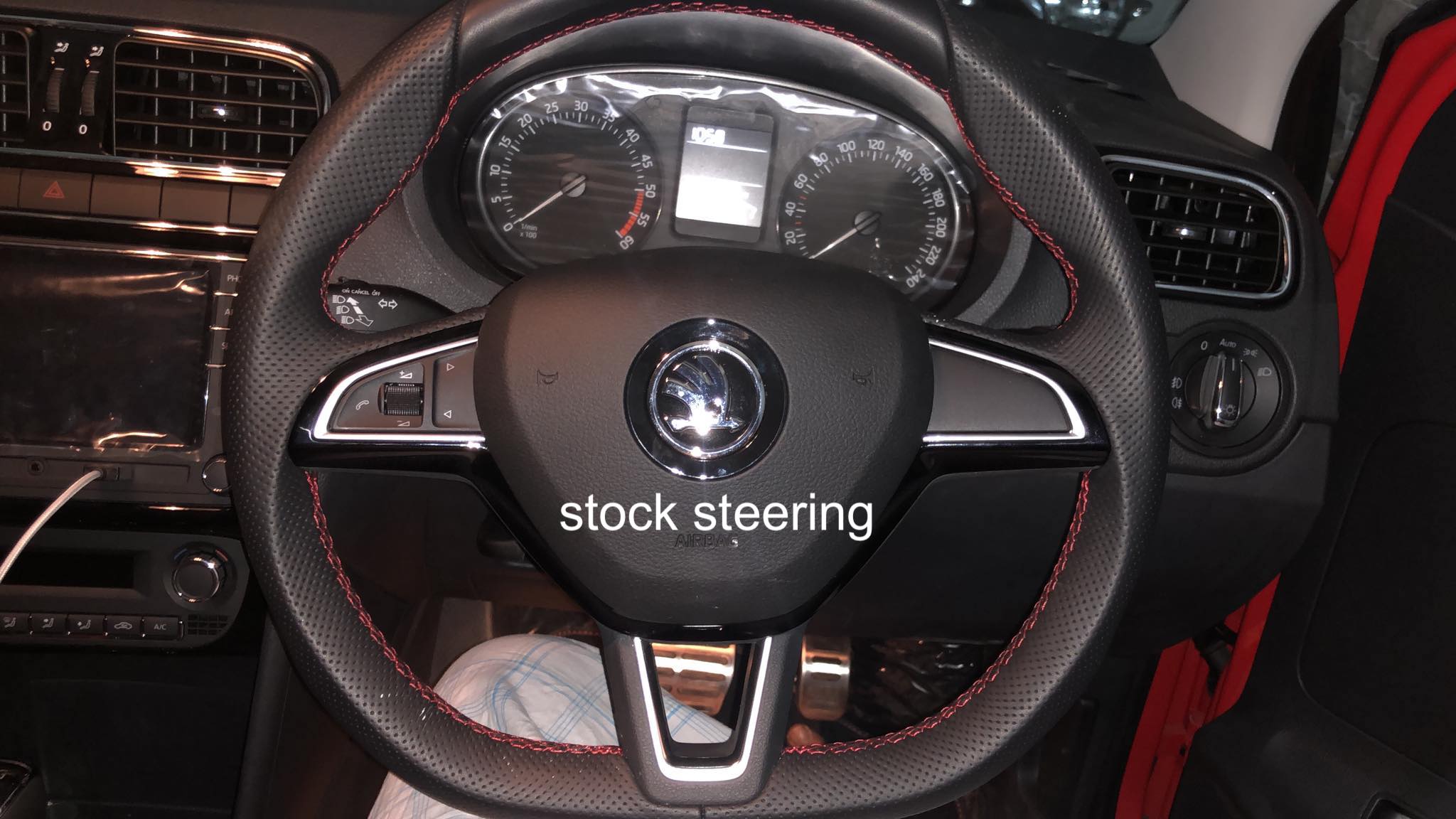

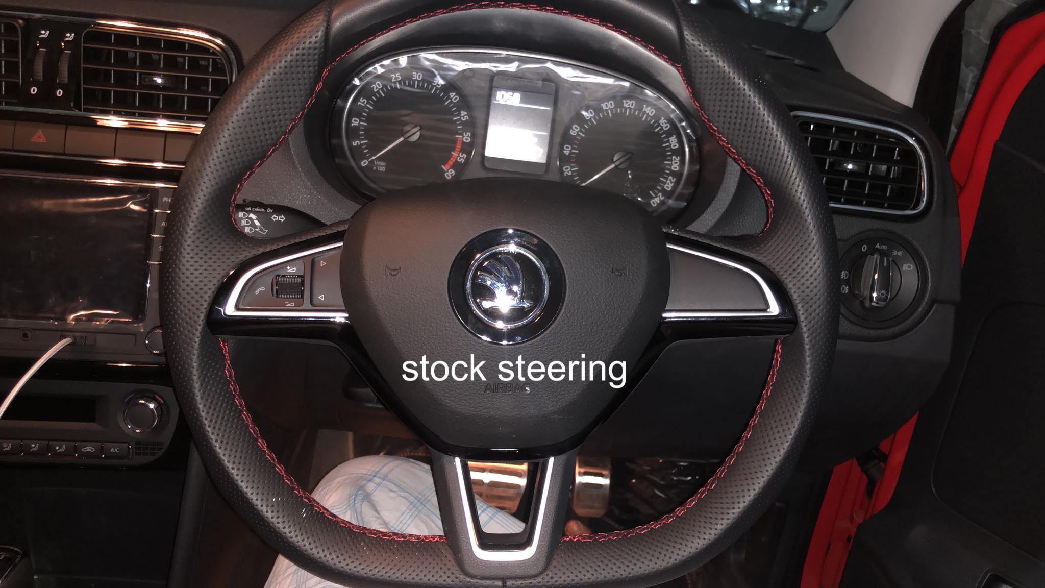

On your first post, you have two pictures. One of the car with mfsw buttons only on the left side. Is this picture from your car? If yes can you post the code from those buttons and the code for the airbag wire that came with your car?
Sent from my Mi Note 10 Pro using Tapatalk
Hello Sirexantas wrote: Tue Aug 11, 2020 8:08 pm On your first post, you have two pictures. One of the car with mfsw buttons only on the left side. Is this picture from your car? If yes can you post the code from those buttons and the code for the airbag wire that came with your car?
yes sir the mfsw buttons only on the left side is my stock steering.
buttons code : 5E0919719C
AIR BAG CODE : 5JA971584
THE ABOVE 2 ARE MY STOCK CODES

Mr. Ciclo will the below steering works well with my car.
seems to be pretty same like my stock with paddles.
https://www.ebay.de/itm/SKODA-FABIA-VRS ... 2#shpCntId
please check the link

As with the (2015-2018) 6C MFSW installed on the 6R (2010-2014), one of the keys was in the airbag wiring wires configuration.
There were more things to check (coding, ground points, etc), but this is the only one worth mentioning here at the moment ...
The airbag harnesses that Navein has are different when it comes to wires configuration. This wires configuration can be modified, ...but only by expert hands....
It is a pity that Navein did not take more detailed pictures of the wires reaching to the connectors. (colors of wires reaching T12, T5, and slot number of each wire)
To modify the wires configuration, the original wiring diagrams (elsaWin, or erWin) are required:
- from MFSW Skoda Rapid 2019 IND.
- and from MFSW Skoda Fabia / Octavia 2016 Europe.
I only know Govindsharma who might have them, ... get in touch with him and ask him to share them here or send them to my email (in PDF file
