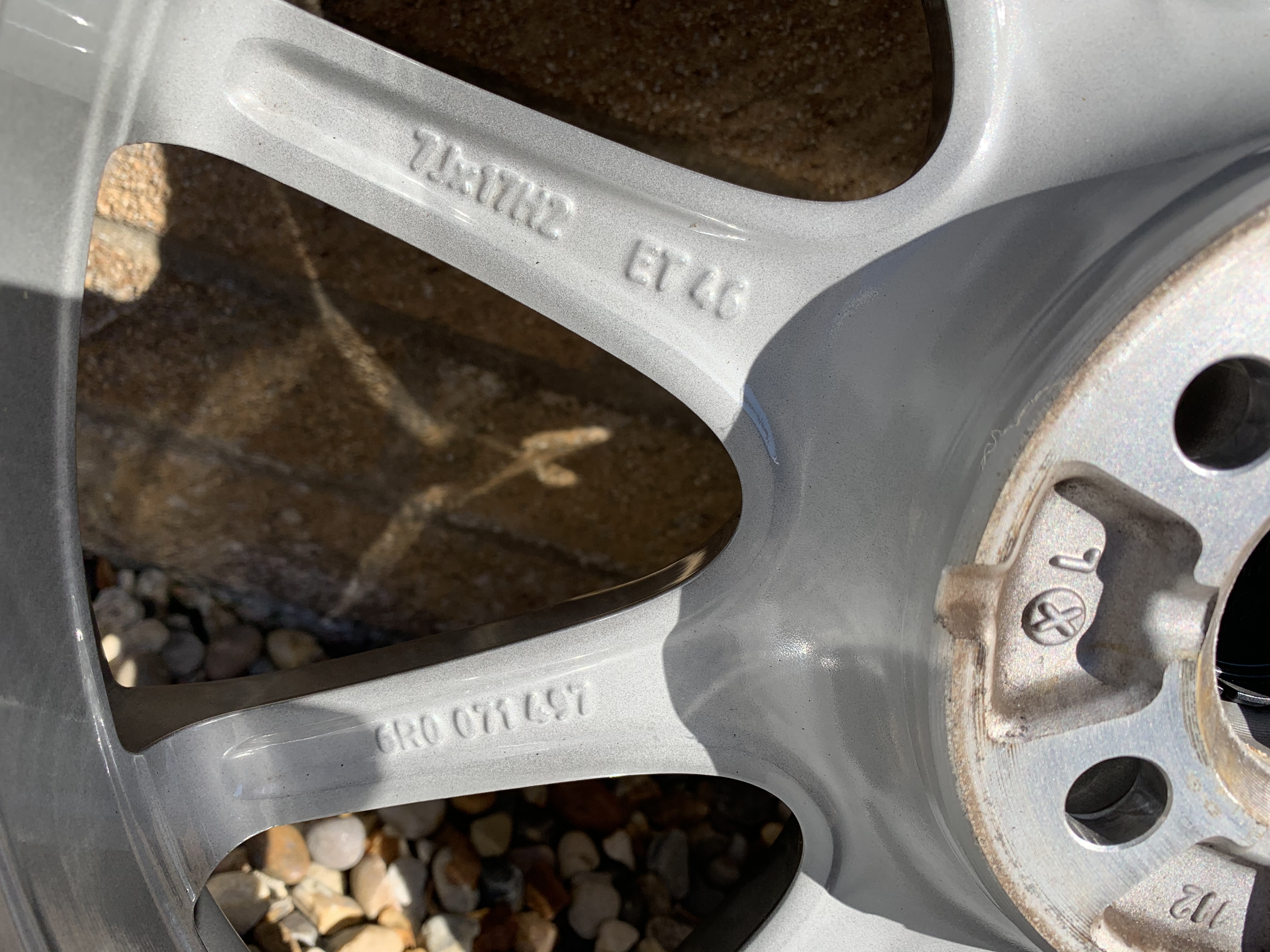

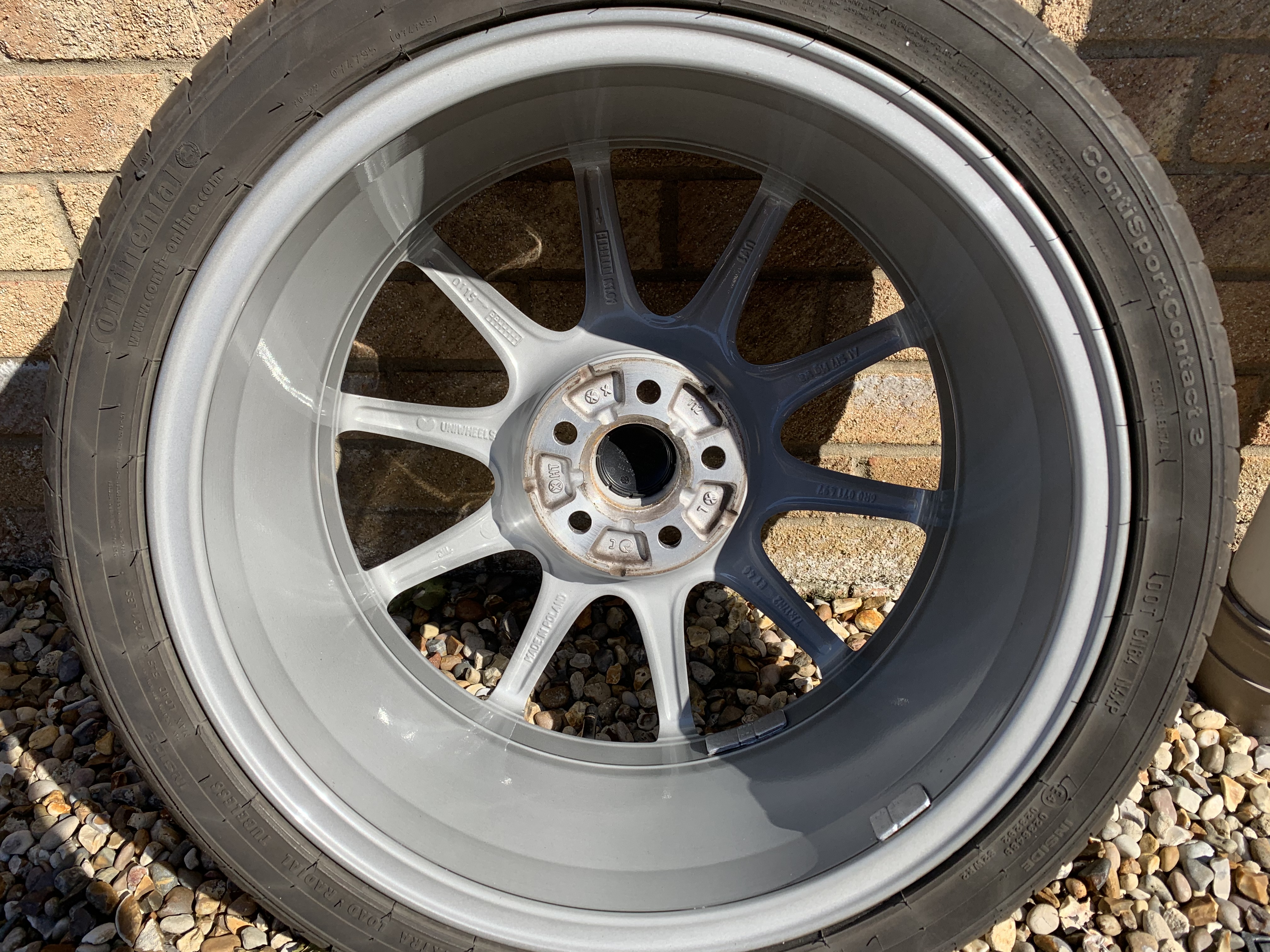

I doubt you’ll find a paint code on the reverse side of your wheel. The VW wheels I’ve just sold were available in three colours and when they are manufactured, the manufacturer would have needed to know which of the three colour options each wheel was going to be painted / powder coated in order to add the correct paint code for that colour at time of manufacture.
The details stamped into the reverse side of the spokes will include the following;
- part number (without paint code)
- wheel size (the width and diameter)
- offset
- certification mark (e.g. JWL, ABE, TUV or similar)
- manufacturers name
- possibly the VW emblem
Here’s a couple of pictures of the reverse side of one of the wheels I’ve just sold. You can see the part number (lower spoke in the first picture) but the additional three characters for the anthracite paint code (16Z) aren’t included. The colour of the reverse side of those wheels was much lighter (light grey) than the face of the wheels which was a mid anthracite grey colour.
