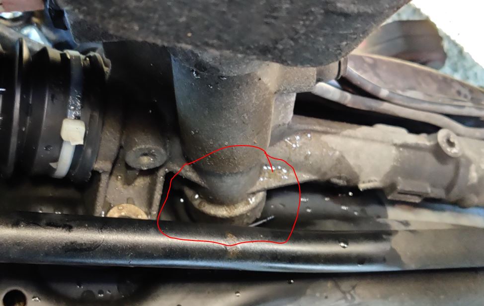

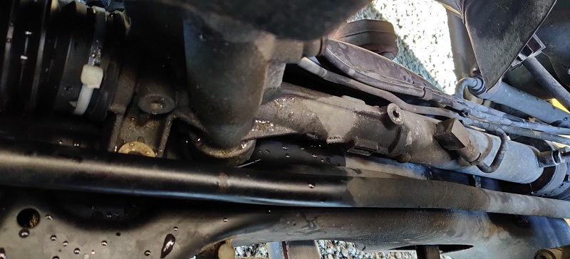

My 2008 polo N93 has a leak
the Driver side tie rod boot fills with steering fluid and then leaks out
The old Rubber boot was damaged so I replaced it trying to slow the leak to give me time to get it sorted the garage cant fit it in for another 3 weeks but no joy
It emptied the reservoir in 3 days of just going down to the town
So Im on ebay trying to find a replacement rack ( not just a seal )
Is there a way to find the part number from the Vin but when I go on the eKTA site and put in the Vin it says not found
Is there anyone can tell me the part number from the following
I was just out under the car to see if I could find a part number on it but its pretty awkward
wvwzzz9Nz8Y157369
9N3 1W4
Polo A04 comfo
51 4v M5F
BZG- JUS
Any of the Racks i have seen on ebay look similar but seem to lean more of an angle where the motor housing is ( where it goes in to the car
Steering rack.jpg (134.21 KiB) Viewed 4660 times
Steering Rack 2.jpg (107.47 KiB) Viewed 4660 times
Many thanks for any replies

So took a trip to the local breakers and had a look at a few
Picked up one that they said is same checked for play and opened the rubber boots and no oil / fluid
The rods seemed ok with no play ( not flopping around ) but rather than have to do them later i went straight to the motor factors and got some new tie rods inner and outer
and have swapped them out
Will update with the part number once It is in and ok for future reference
Re: Steering Rack Leak :-(
Posted: Sat Nov 14, 2020 9:31 am
by gerinemo
For future reference
The scrapyard steering rack is in and appears to be working fine :-)
The part number stamped on it is TRW 023 0080 050 001 which when googled comes up as polo 9N
Paid €90 for the rack
€40 for inner and outer tie rods ( even though I could prob have gotten away with the ones that were in it )
€180 for the local garage to fit it as our driveway is gravel and a real pain to do anything under the car ( + i'm just getting too old )
