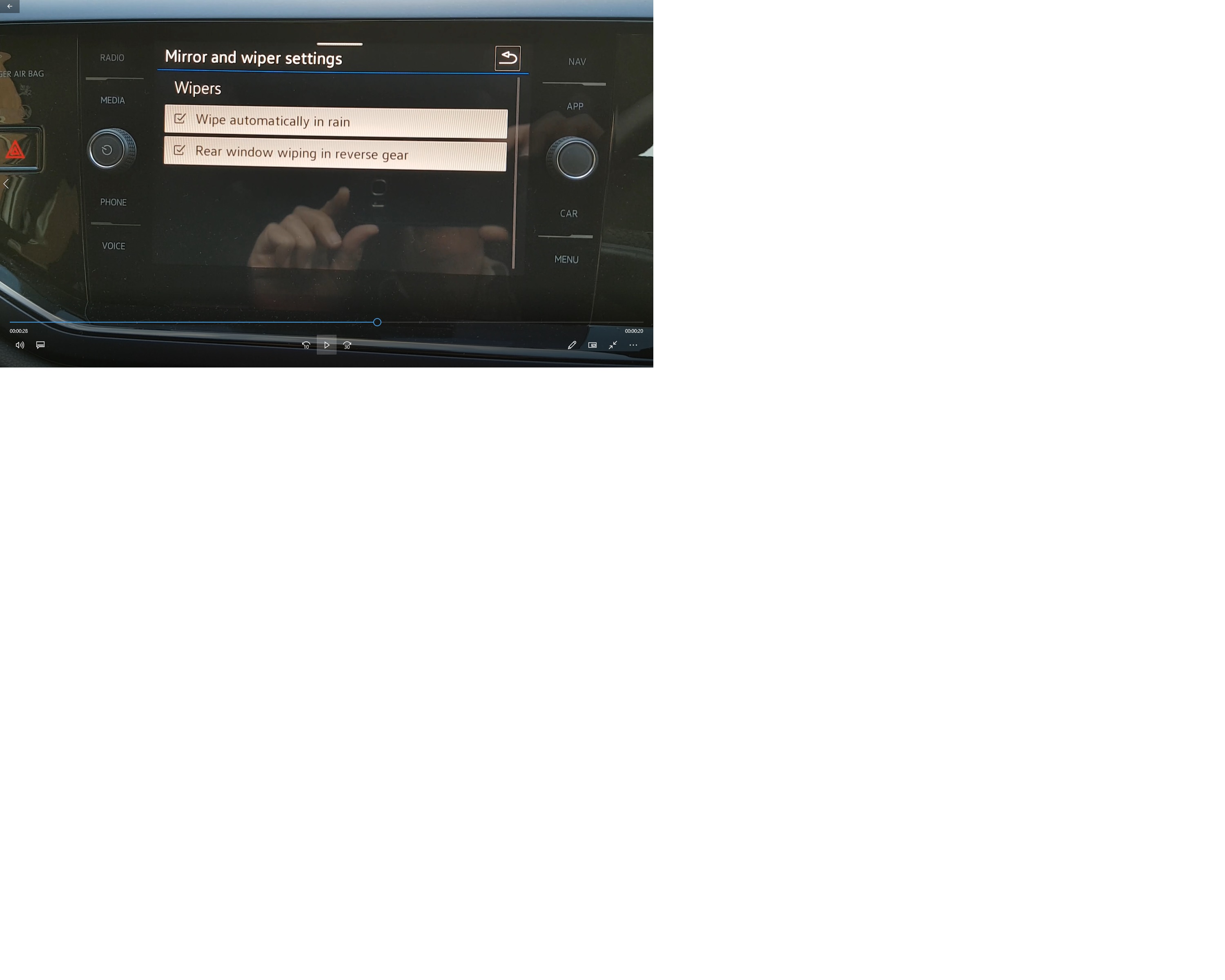

Our VW Polo is now about six weeks old so we thought we would try to alter the mirror settings to do the following:
1. Allow nearside mirror to dip when parking close to a kerb
2. Allow both mirrors to fold in when locking the car when parking in tight spaces.
(We do have the folding mirror symbol on the mirrors control knob)

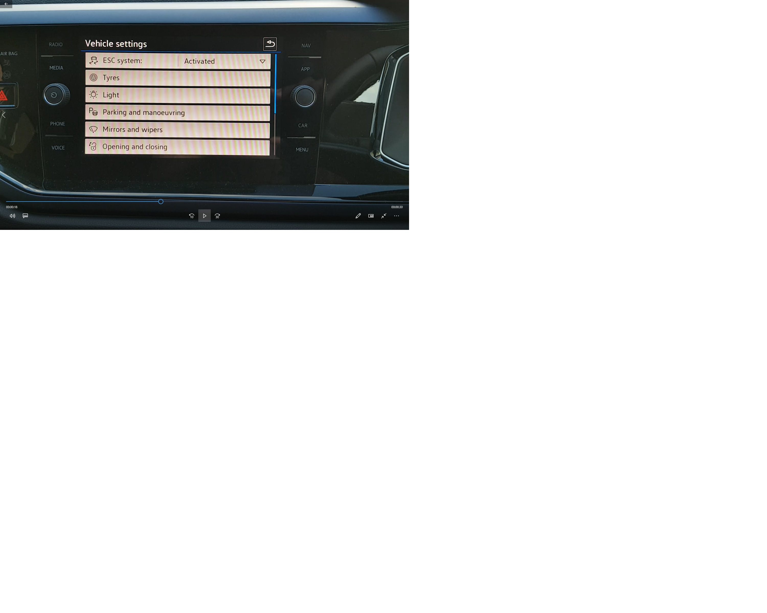

So straight over to Vehicle Settings and we chose the 'Mirrors and wipers' option
HOWEVER ONLY THE WIPER OPTIONS ARE DISPLAYED
Please see attached photos
Anyone got any idea where are my Mirror options?

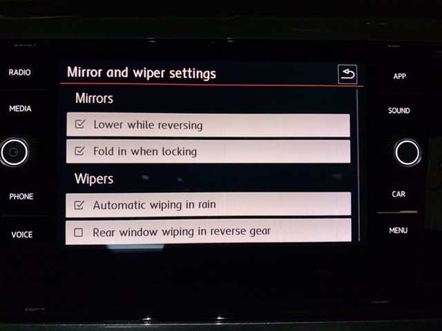

@silversurfer2020; I’ve just been and checked the ‘mirror and wiper settings’ menu in my car - Polo GTI+ which has electrically folding / dipping kerbside mirror as part of the standard spec. My car does have a separate ‘Mirrors’ sub-menu;
From your forum signature details I see that you have a Polo United. The United doesn’t have electrically foldable door mirrors or dipping kerbside mirror while reversing as part of the car’s standard spec, so this would’ve needed to have been added as an extra cost option when the car was ordered. I see from your first post on the forum in the ‘New mid range United spec’ discussion topic that you said the only options your car has is Pure White paint and DSG transmission.

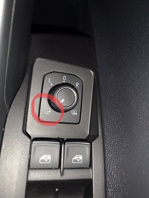

This is the door mirror adjustment control on my car - it’s the symbol circled in red that your adjustment control knob needs to have for you to have electrically foldable door mirrors;
If your mirror adjustment control is the same as mine, there’s always a chance that the factory installed the incorrect version when your car was built. However;

- as you don’t have the ‘Mirrors’ sub menu in the ‘Car Settings’ menus
- electrically folding mirrors / dipping kerbside mirror is an extra cost option on the United model and you didn’t spec that option on your car

I have a 2019 GTI+ with folding mirrors and just checked the menu settings. On mine I have a separate “Mirrors” pair of options just above the “Wipers” options shown in the picture above. The “Mirrors” options are “Lower while reversing” and “Fold when locking”.

Our Polo United does have the folding mirror symbol on the mirrors control knob, exactly as shown, circled in red on previous photo. It is strange that our Vehicle settings menu shows Mirror and Wiper settings when there are no mirror settings to set? Why not just state Wiper settings? The handbook supplied with the vehicle also refers to the folding mirrors. I have checked the list of optional extras for this car and could not see any options regarding the mirrors. Could it be possible that there is a software error on our car and that is why the mirror options are not shown? It would be useful if anyone else with a United model could post about the mirror options.
