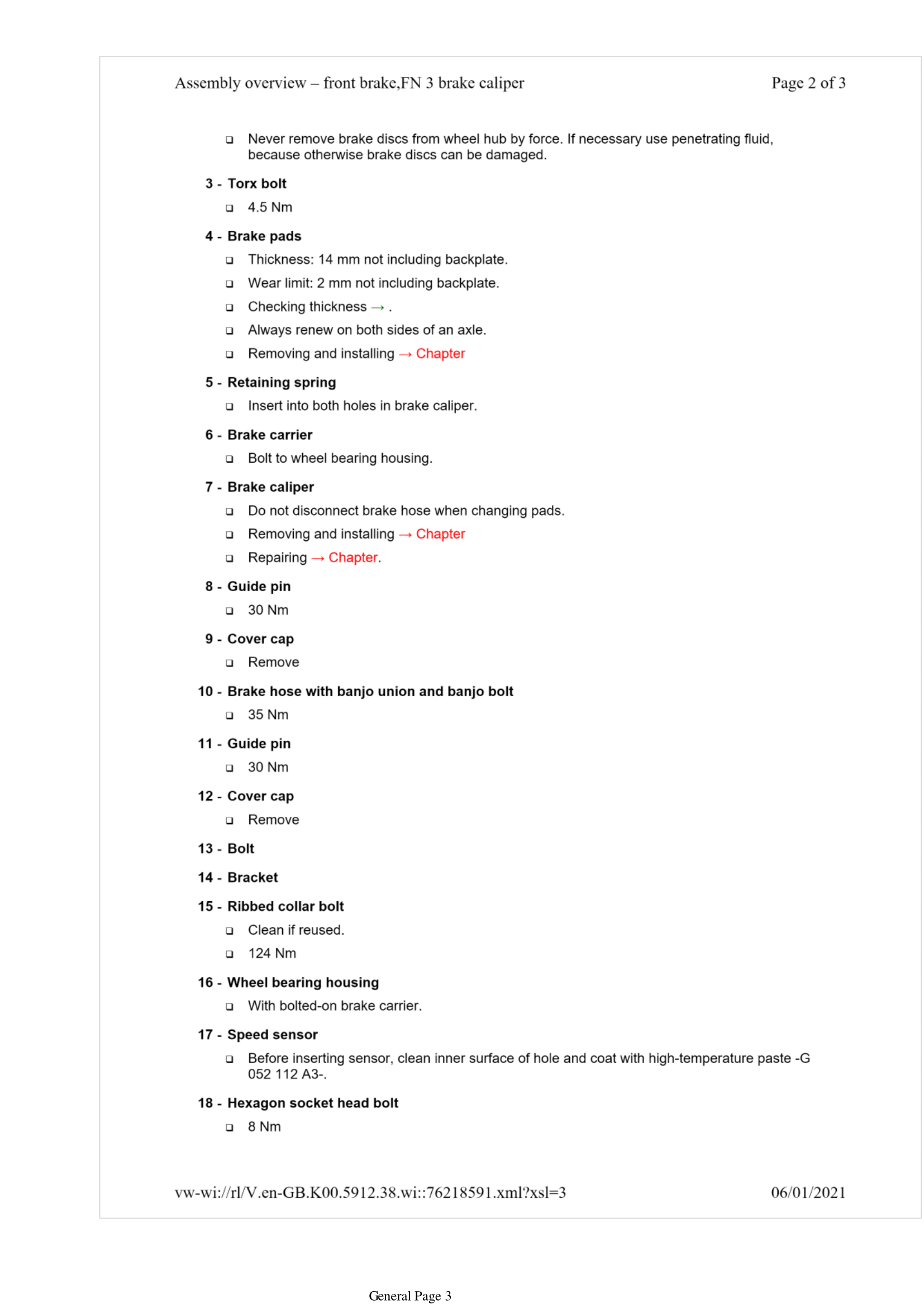

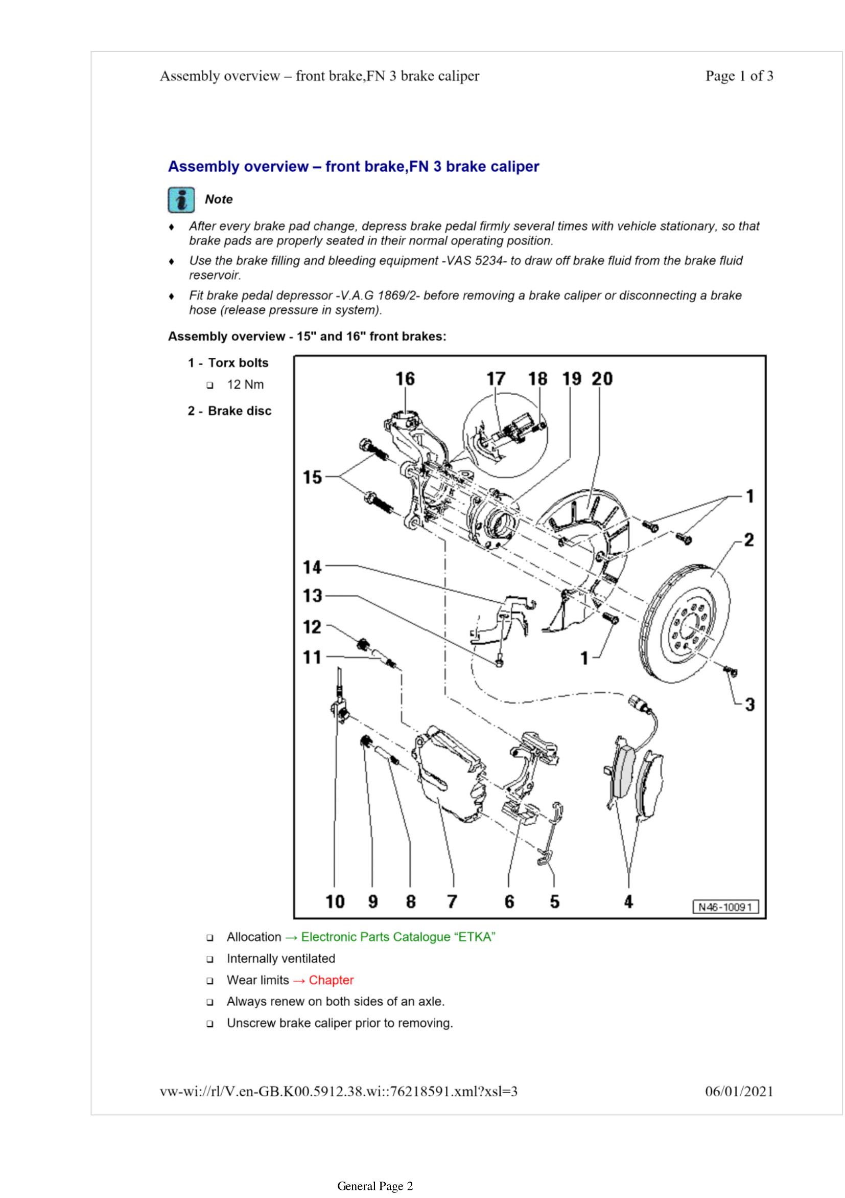

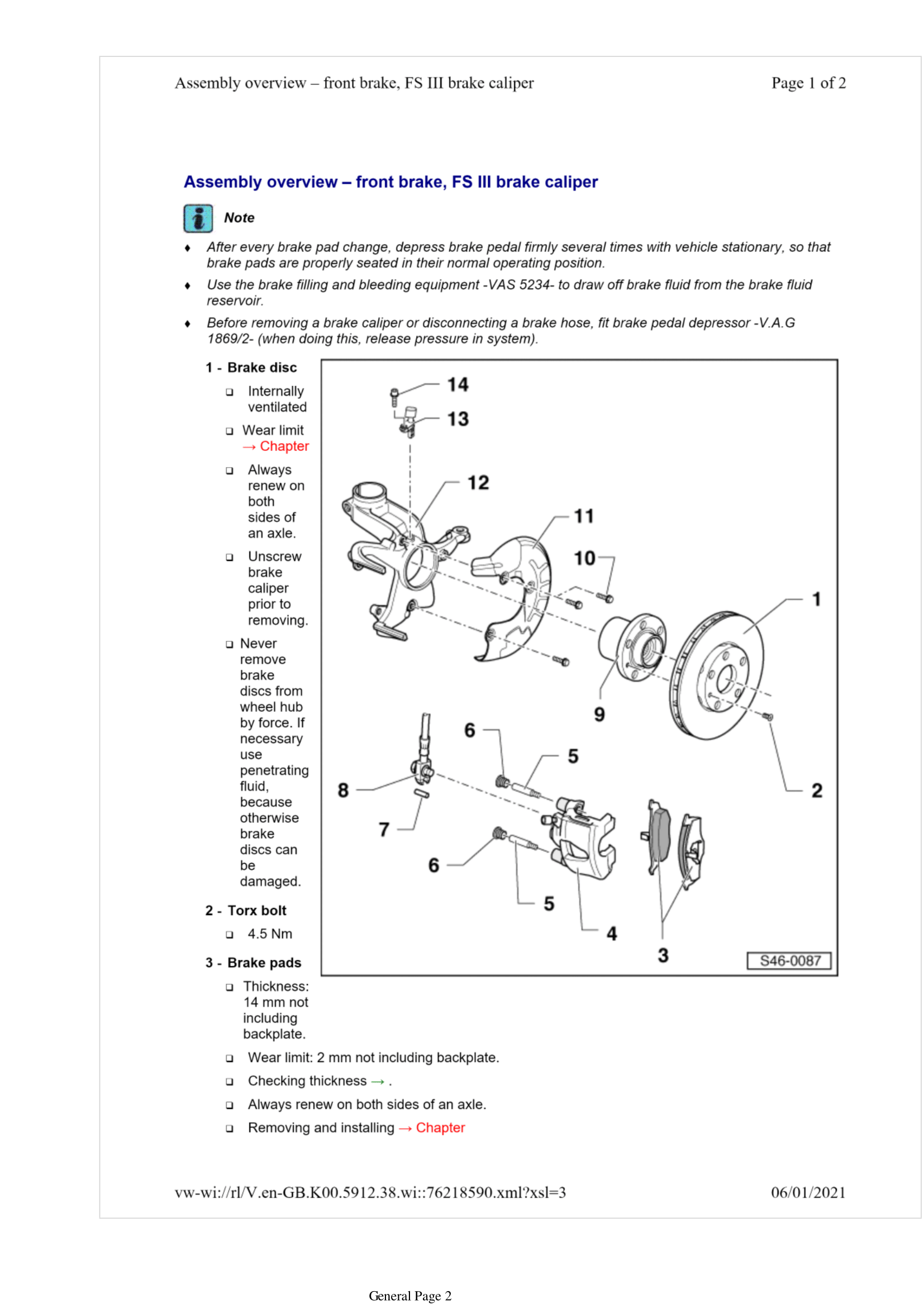

Hey there, so I have a 2016 1.8 gti and I'm going to change the discs/pads over the weekend (312x25 front, 233x9 rear) but for the life of me I can't find the torque settings for the calipers or brackets. Does anybody know them or how I could find them out? Thanks a lot.

You could buy a workshop manual from easymanuals it is just a copy of the official workshop manuals made available to non VW workshops. I did that for my wife's August 2015 Polo 1.2TSI 110 and my February 2011 S4.
Edit:- as a back up for normal jobs, the Haynes workshop manual is also helpful, though it is based on the earlier 6R Polo and will not include the GTI, but many suspension etc jobs will be similar.

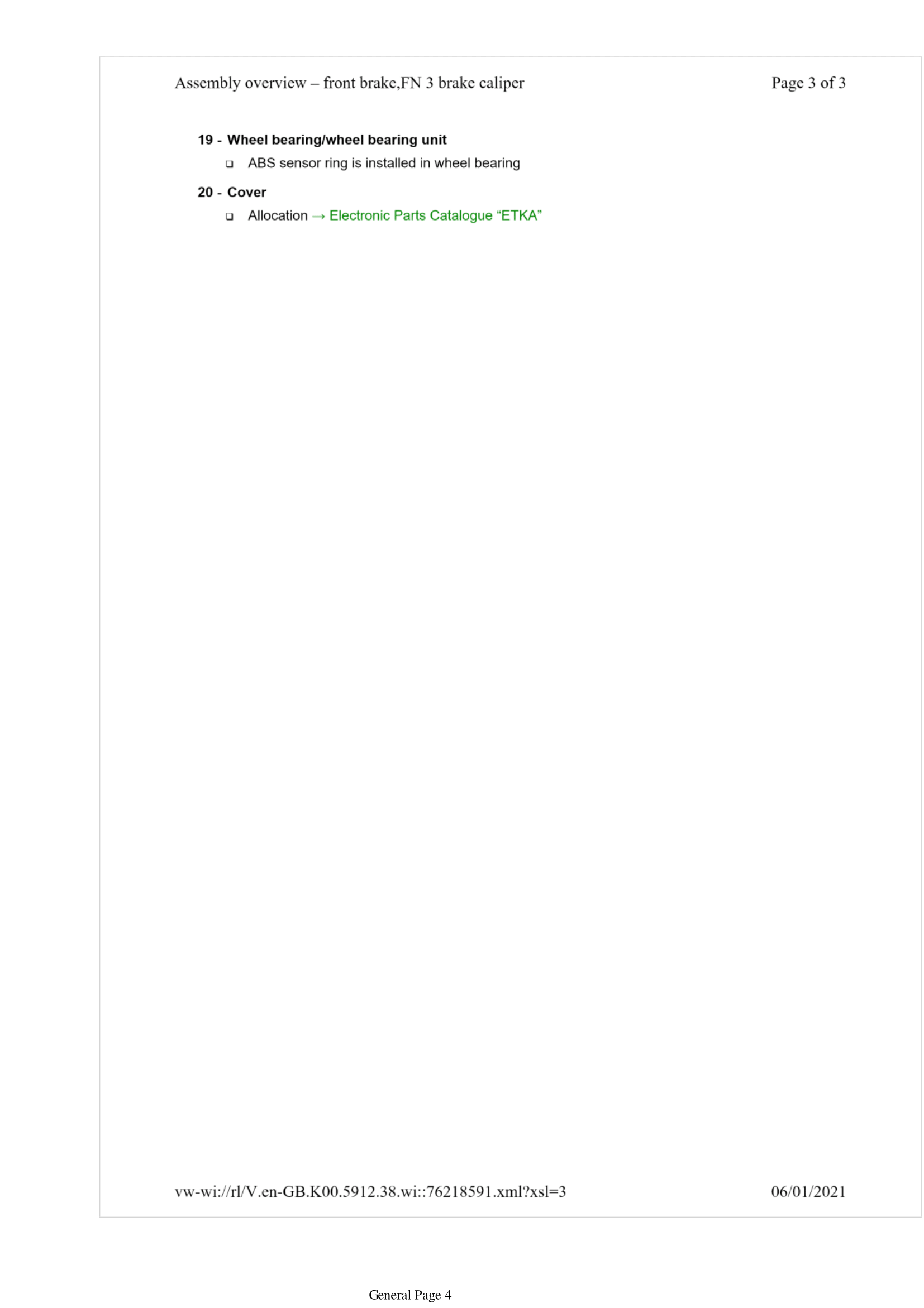

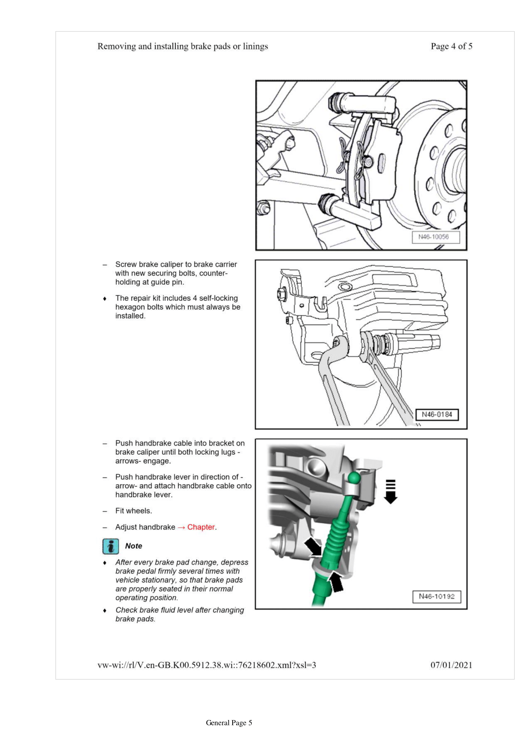

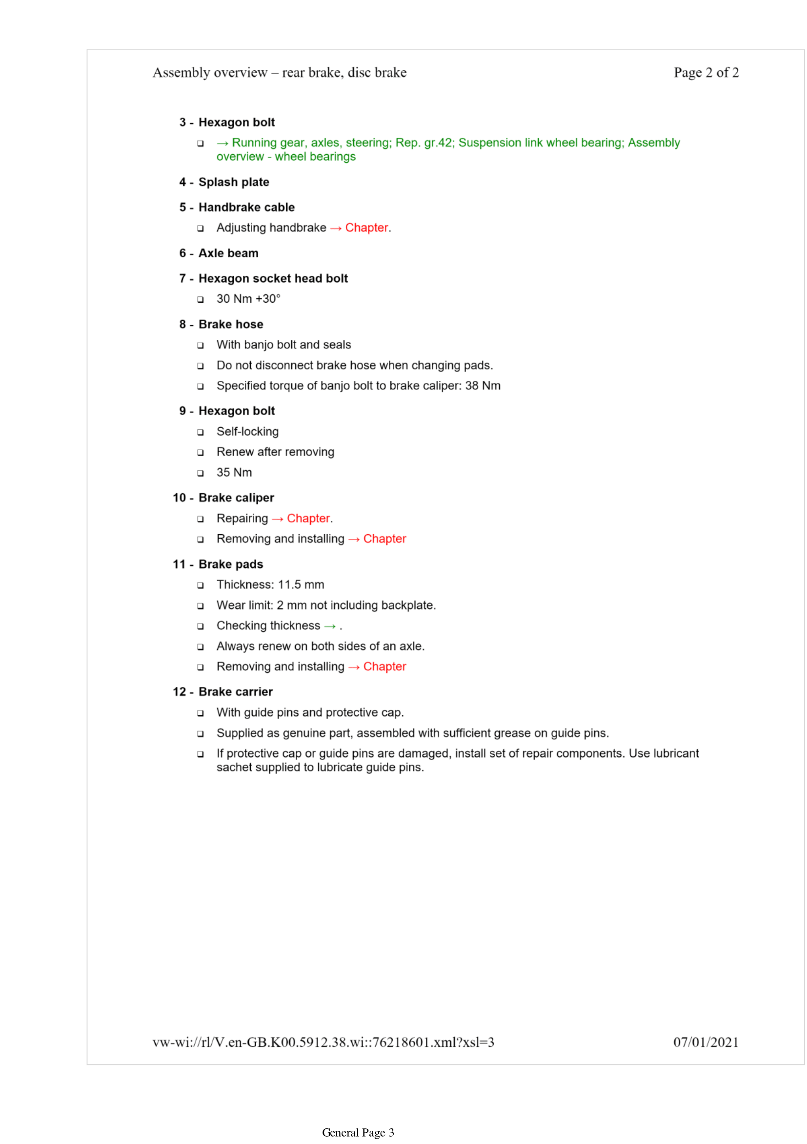

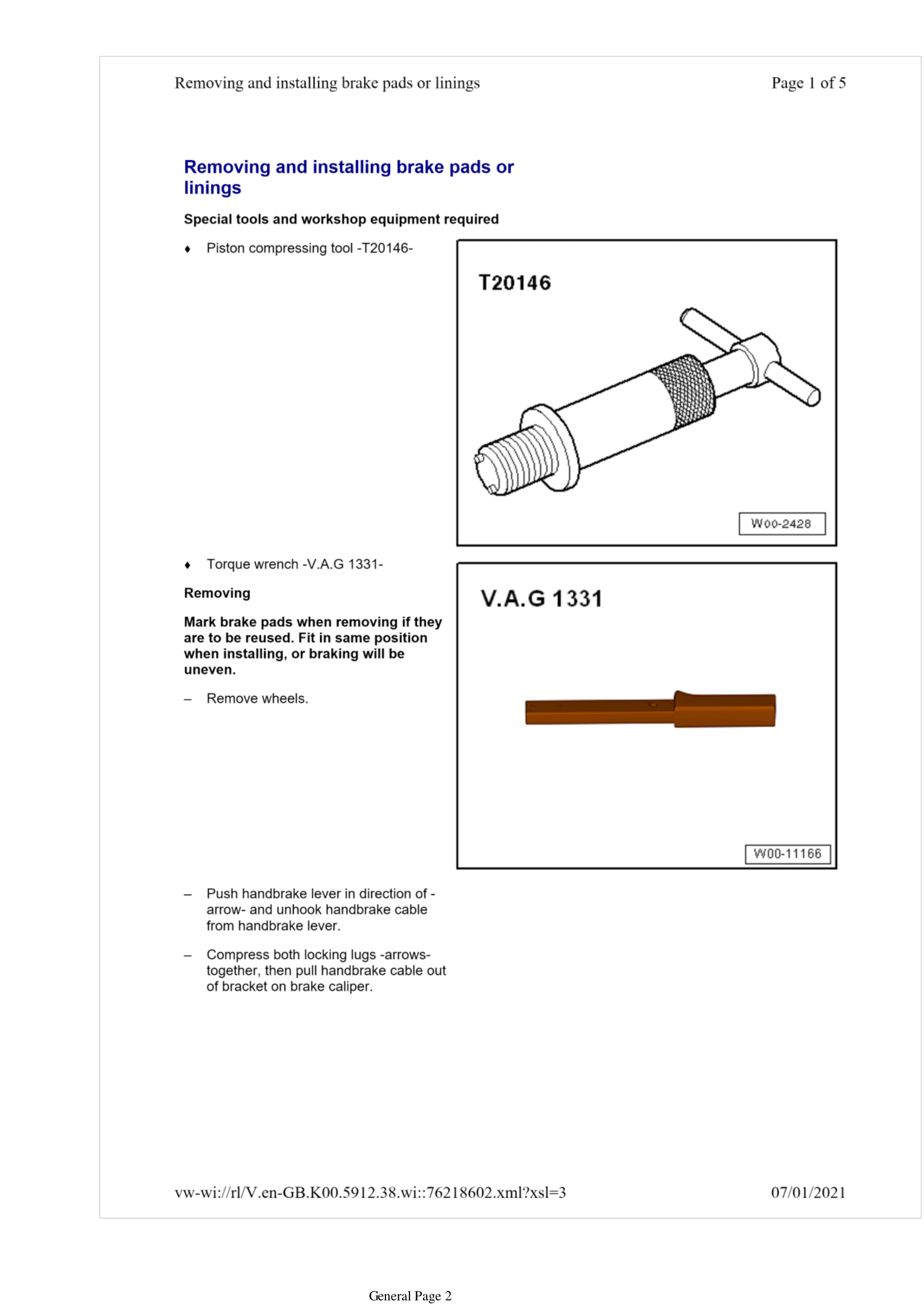

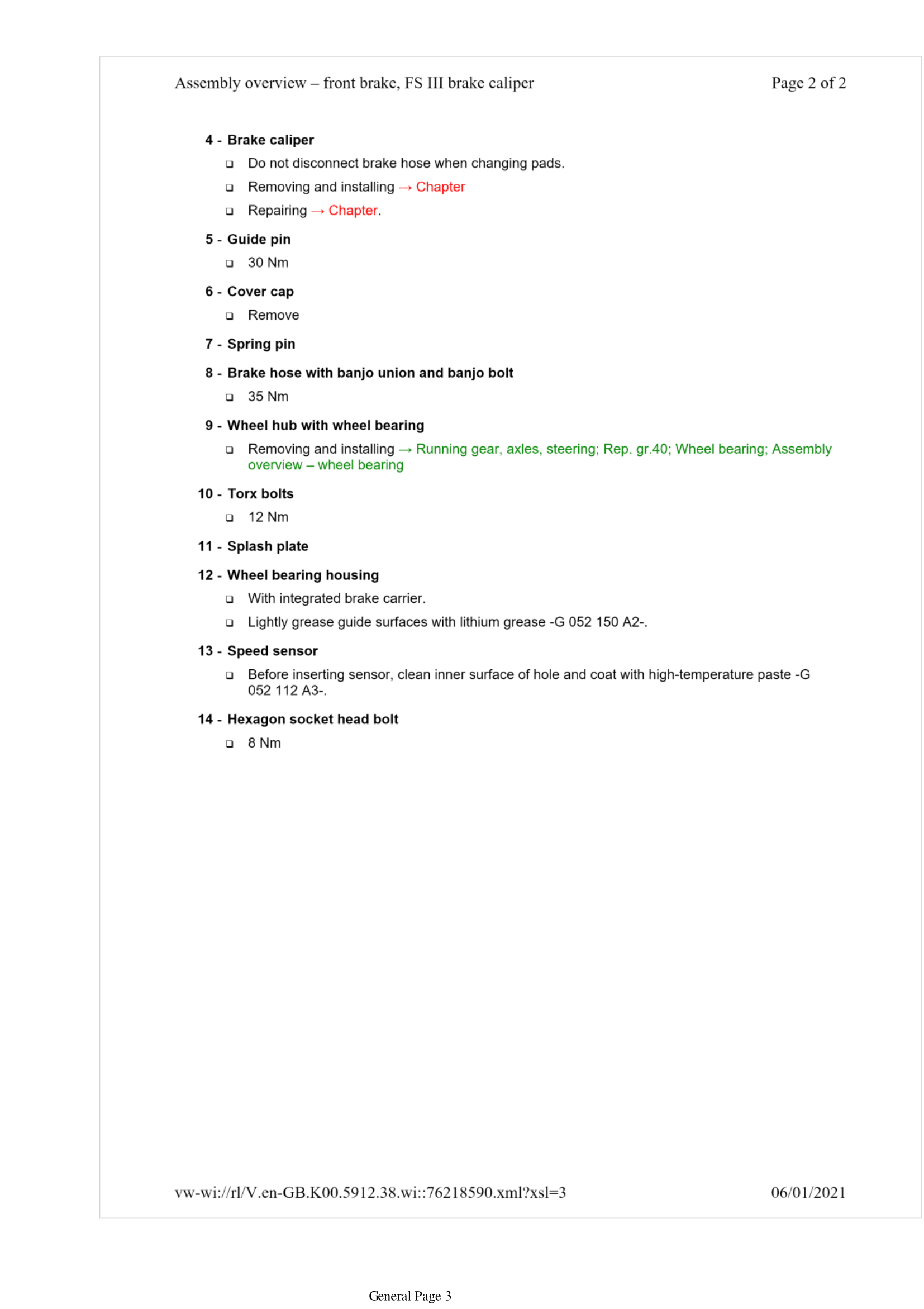

Cheers Amer, life saver. Do you have any diagrams/info on the rear discs as well? I'm doing an all round change. I reckon I'll get a manual eventually but right now I'm only after the torque.

Re: 6C gti brake change help?
Mikeymoomah
Posts: 3
Joined: Tue Jan 05, 2021 10:23 pm
Drives: 6C gti 1.8
Location: South West
Post by Mikeymoomah »
Fantastic cheers man. Mystery solved now! Looking forward to the weekend.
