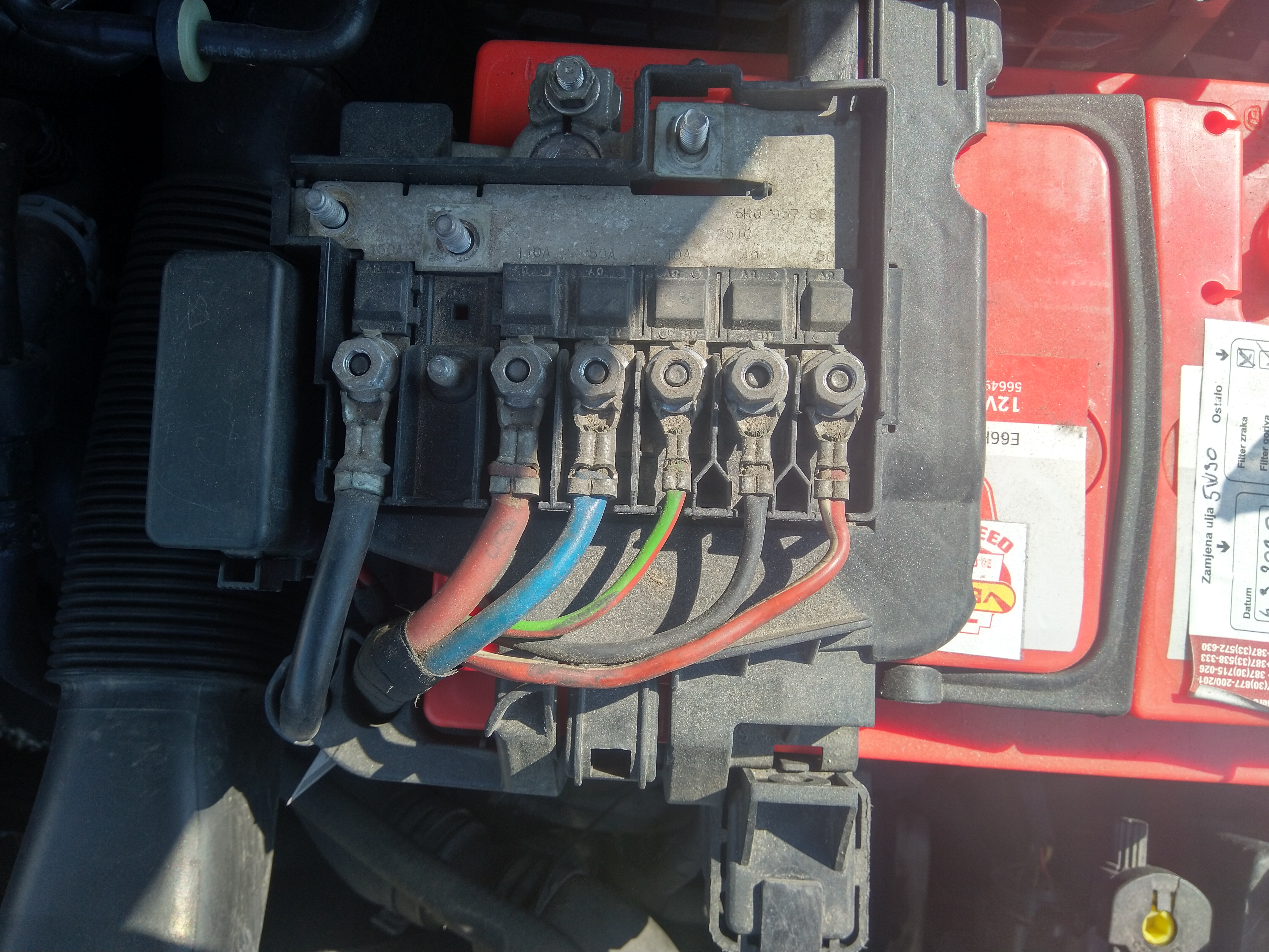

It seems the battery is fine, I have successfully pulled a DTC
00816 Power steering sensor
030 Open circuit/short to B+
My prediction is a torn wire on power steering sensor since it's periodic? This is the sensor on the rack? I know that rack is bolted to the subframe. Is there any way to get to it from the top, removing the batter, and air intake filter box?

by iichel
No this is about the blue wire to B+. B+ is the battery, not the blood type

Re: Power steering pump battery
Posted: Mon Jan 18, 2021 6:23 pm
by amer6R
Blue wire from battery?
I know that this wire leads to power steering pump, does it also split to the g250 sensor on the rack?
