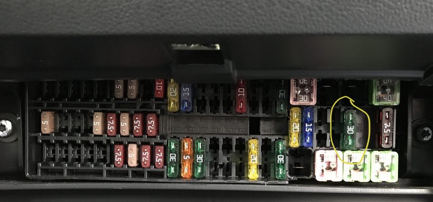

Goood evening,
Our polo windscreen washers have stopped spraying today and after searching online, I managed to identify the issue and locate the broken fuse(7.5 red on the right). While I was in the fuse box, I disconnected another fuse (labelled 30 colour green -circled in the image below) and I’m not sure if I put it back in the right place. Can anybody here advise please? Also, what is the purpose of this fuse? I couldn’t find description for it online.
Many thanks

Yes it's the right place but the wrong fuse. The purpose of the fuse is to burn before the wire burns. Now it's the other way around. Get a 7.5A fuse and it's all good to go. If you look here, there is an overview for all fuses of your Polo 6C: viewtopic.php?f=56&t=71052

Thanks iichel.
The diagram you pointed out is great.
