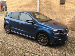

Ironically, even though the Serron’s were easy to clean, I swapped them for a set of VW Motorsport alloys in an anthracite powder coat finish as I don’t like diamond cut alloys. The Motorsport alloys were also easy to clean;
I kept the Serron alloys and put them back on the car when I sold it last year, and I sold the Motorsport alloys in the ‘for sale’ section of the forum.

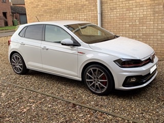

I’ve done the same with my new Polo GTI+ (swapped the factory OEM 18” Brescia diamond cut alloys for a set of powder coated alloys). I had to go for aftermarket alloys this time, as VW don’t have any painted / powder coated 18” alloys with a PCD of 5x100 and an adequate load limit for the current Polo GTI. The Brescia’s will go back on the car when the time comes to sell it.

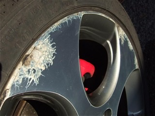

  • the durability of the diamond cut finish isn’t great on a car that’s used as a daily driver. The shiny diamond cut finish doesn’t provide a good ‘key’ for the protective lacquer coat to bond to, so if it gets damaged by, say, a stone chip, water, moisture and air can get under the lacquer where the lacquer’s been chipped away causing oxidation (white worm corrosion) on the polished alloy surface, which then spreads over the face of the wheel. It looks unsightly, and to remove it requires the wheel to be refurbished. It’s pretty common for white worm corrosion to appear on diamond cut alloys between 2-3 years old (sometimes sooner). For those who don’t know what it looks like, here’s s mk5 Golf GTI diamond cut alloy with white worm corrosion in a pretty advanced state;
