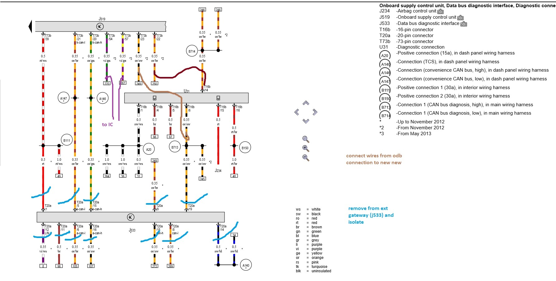

by jiimien
Hi ciclo!
Thanks for guidance :D
Is this correct understood then?
wiring for new bcm.png (561.27 KiB) Viewed 2359 times
Re: Upgrading BCM to MAX
Posted: Thu Feb 11, 2021 8:30 pm
by ciclo
It is right.
However, verify that the convenience and powertrain CAN lines reach the white connector of the BCM, add the diagnostic ones and the new ones from the IC.
You must also connect the LIN wire for alternator - battery monitor (violet-white wire T20/12 GW) to T73b/37.
For interior lights you must also change the position of the wire T73b/1 to T73b/4. It is a different terminal, they are both MCP, but different in size.
For this, I recommend adding a new wire (1.10 m of 1.0mm2) from T73b/4 to T6/3 of the Dimmer. Isolate current terminals, T6/3 and T73b/1.
easy... :)
