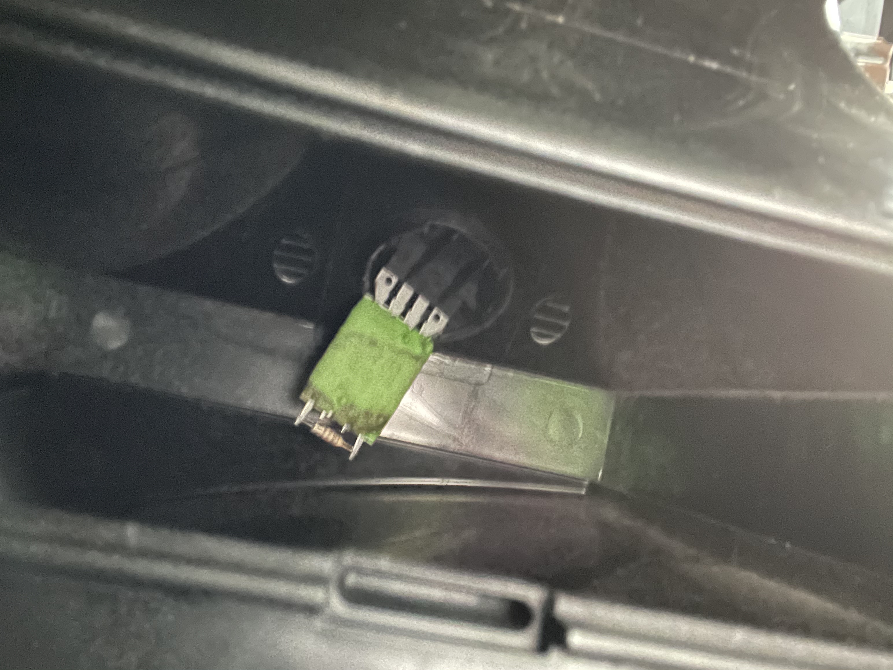

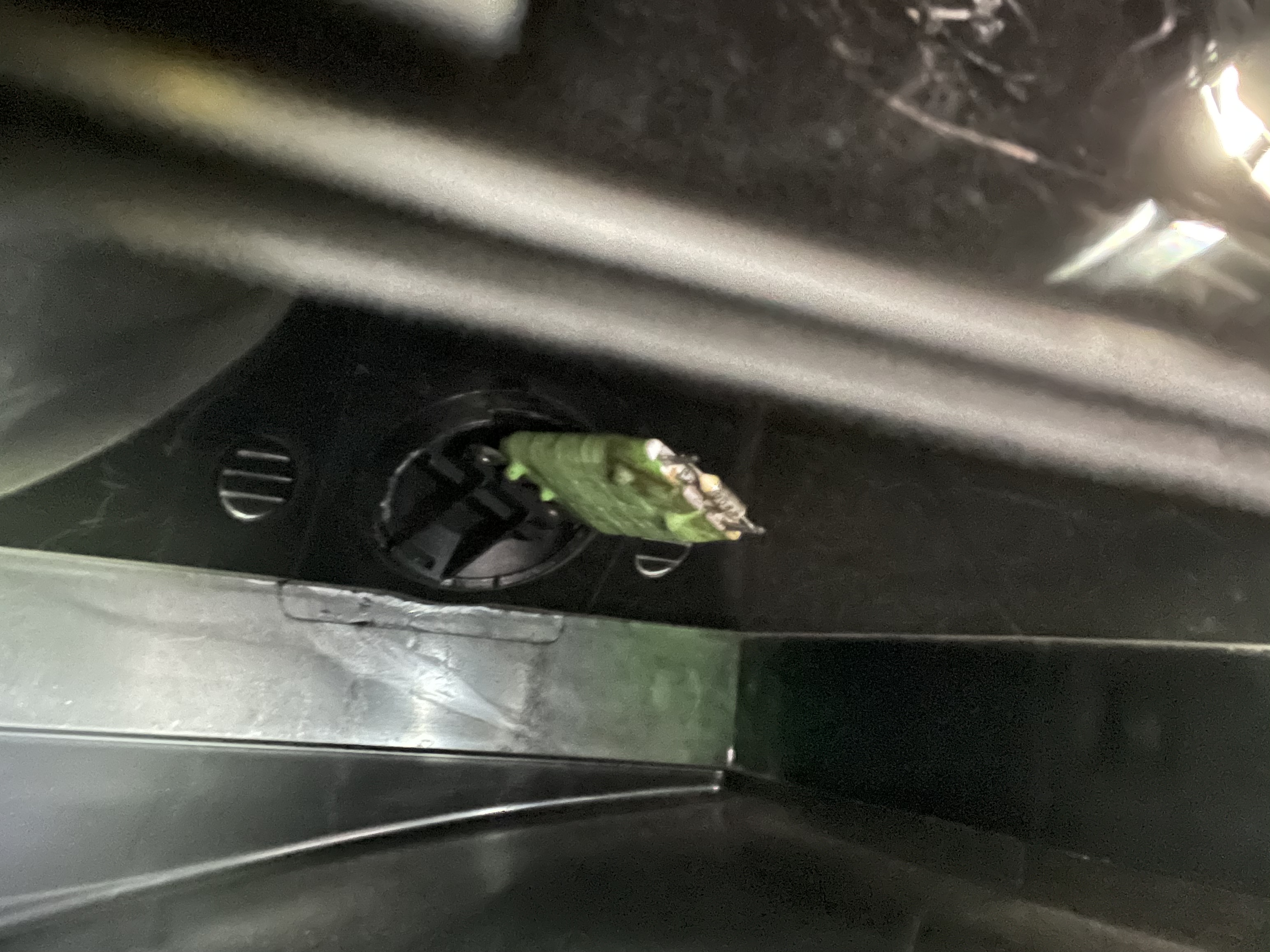

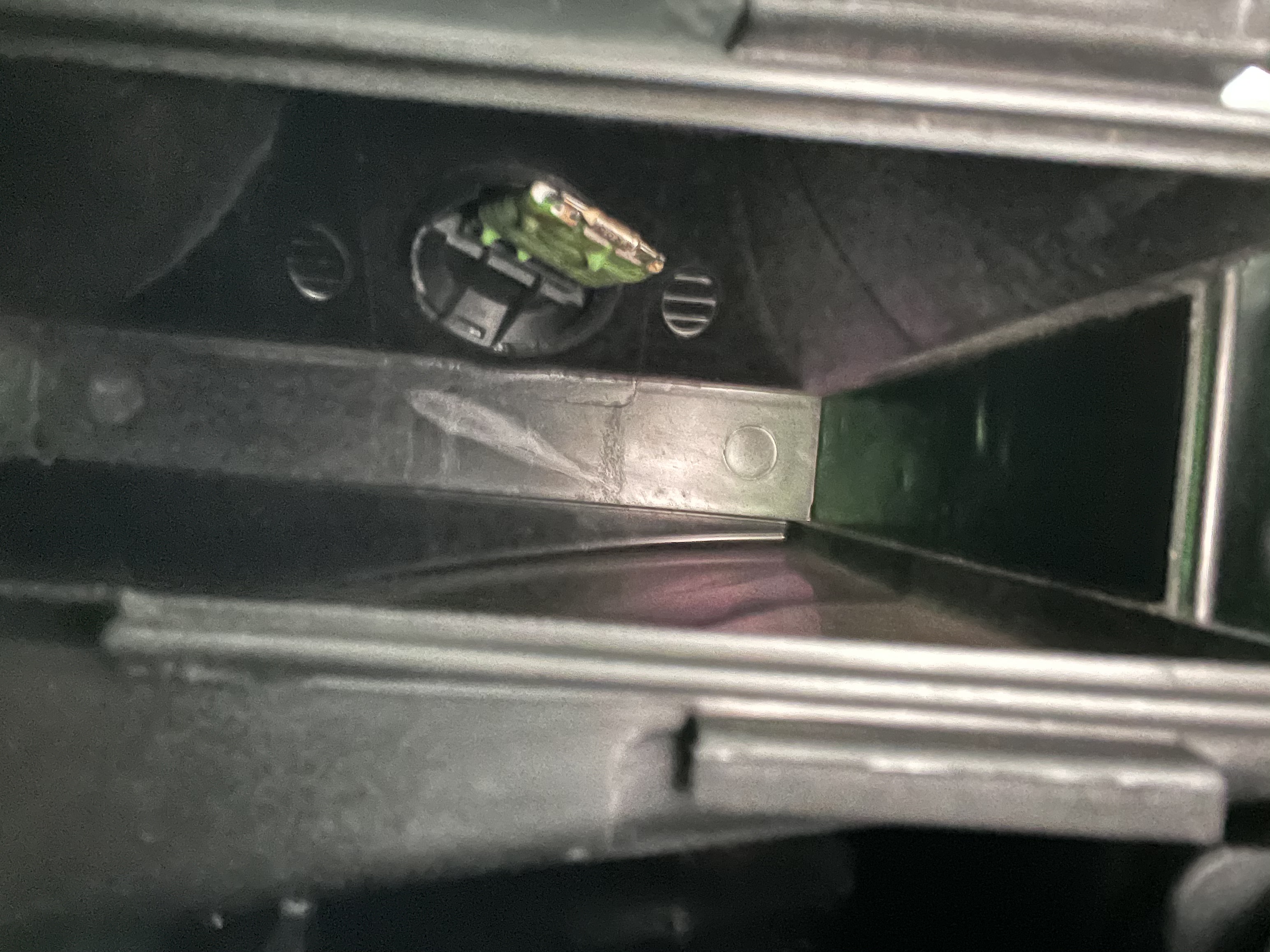

could be the resistor ? , i replaced mine & it all worked fine again, but whatever you do dont put it the new one back in wrong as it burns the pollen filter , i didnt realize it went in a certain way , the bottom pic is the wrong way coz it sat across the edge of the pollen filter , luckily it didnt set me car alight, tho other pic shows the resistor in a parallel position for when the filter goes back in .
its a fiddly job & without realizing you can easily put resistor in wrong so i would advise gettin ya phone camera underneath so you can see how youve put it in .
