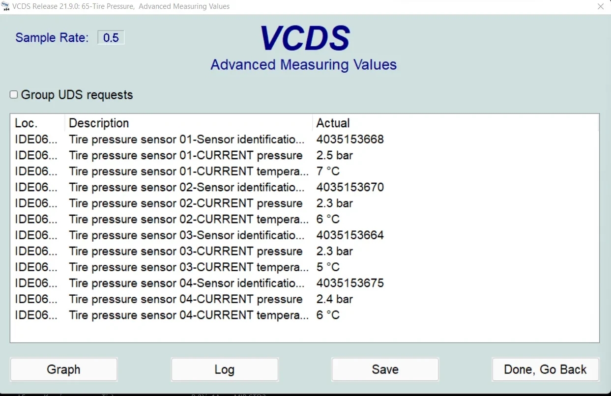

Any advices ?
Re: Seat Toledo 1.6 TDI - PQ25 BCM Max Upgrade
Regarding TPMS, it might be worthwhile to see if the sensors are still OK
Regarding PDC, perhaps there is a Jetta or Beetle dataset for the USA versions, the Jetta low has a PQ25 platform as well. Just like Beetle 5C.

Just checked measuring data this is the picture I get.
I will check whats available for PDC datasets on vcp, do you think that's why I don't get the PDC menu ?
I don't know. I have never seen the PDC menu on PQ25 but I'm not that familiar with the Seat family either.

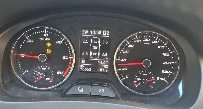

TPMS worked !
Just had to reupload the dataset and everything just worked!
Now I just have to deflate the tires :D
tmps toledo.jpg (212.66 KiB) Viewed 5306 times
patil
Posts: 577
Post by patil »
til3tsio wrote: Fri Jan 14, 2022 6:56 pm
But had some time last week and installed 8k PDC.
5Q0 unit flashed to 1K8 919 472 C with the golf 6 dataset that vcp has. I get the expected error for a missing message but everything works. I think that I need to find a more suitable dataset though.
I didn't get the PDC menu on the dashboard.
I guess PDC menu on cluster is related to SW version cluster is running. On 6R Polo maxidot cluster with SW version 805, the PDC menu appeared automatically after installing 1k8 module. Not related to dataset of PDC module I think.
You should check the SW version of your cluster, may need to edit necessary byte in eeprom dump to activate PDC menu in your cluster.
Congratulations on successful installation of TPMS.👍
