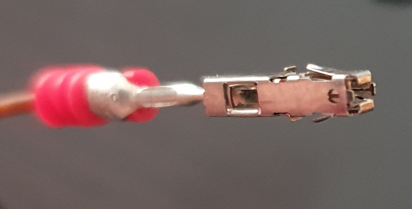

Would these connectors be good for the job? While waiting for the wires I ordered to come I thought of pulling these from a broken plug I had laying around.
Posts: 6693
Re: What wires do I need to retrofit stalks with TRIP/OK
No you need the micro quadlock system
