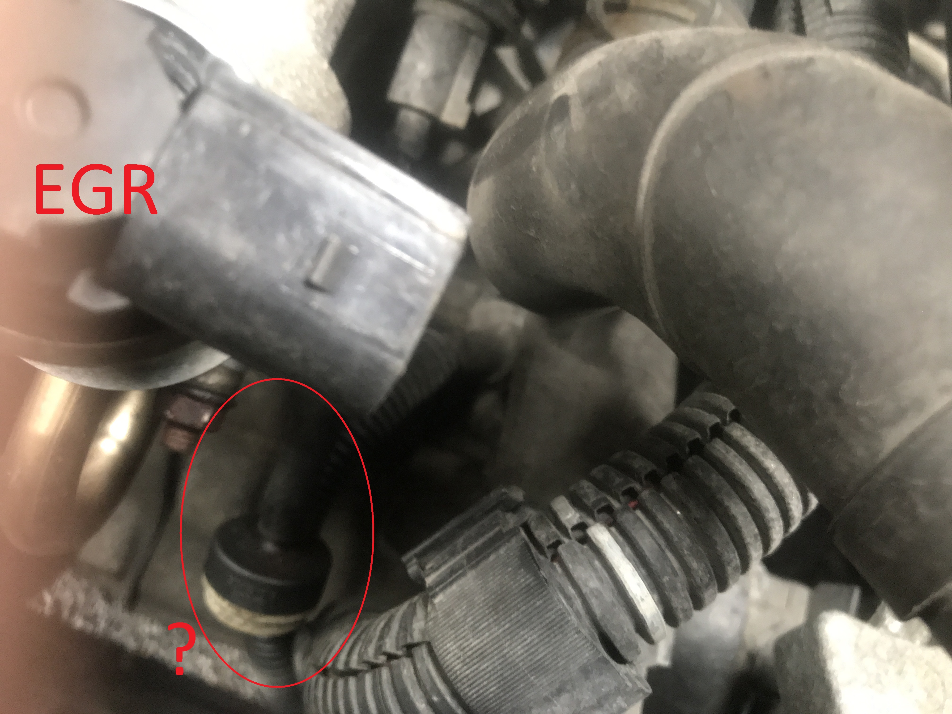

I have just changed the EGR valve on a 2002 1.4 16 petrol. I re-attached the breather hose, but wondered the plastic end piece(valve?) is OK or if a cover is missing?

Found a part catalogue drawing (https://ifinterface.com/ under Free Services, CarProg2) which denotes the end part as Air Filter. From the drawing it does not seem to have a cap, so this is probably OK :D

Yes, that is okay. I use that parts site a lot!
Edit:- did you check that the pipe that goes into the Throttle Body is clear, it usually gets chocked at that end leading to reduced flow.
Also you should perform basic settings to let the engine ECU know the voltages for the EGR plunger end stop positions.
