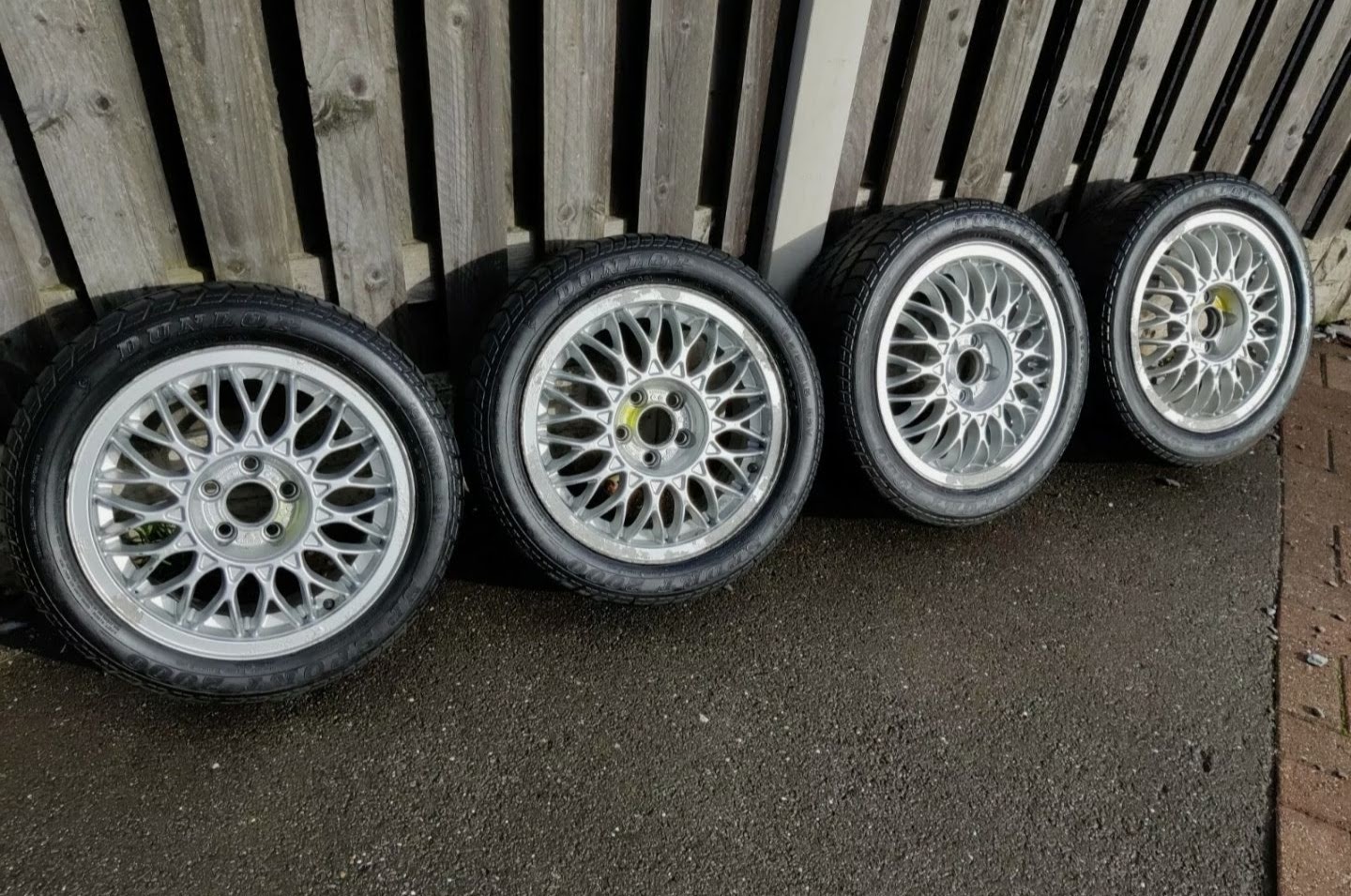

Just purchased a set of 15" BBS wheels, which are in need of a full refurbishment. Corrosion all over the wheels and 2 wheels have flat spots on the rear outer lip but nothing that can't be fixed.
The plan is to take them to Demon Wheels on Walton Summit in Preston for refurbishment and colour change from silver to either gloss black or dark bronze. Finally, wrap them in 195/45 Toyo Proxes TR1 tyres.
