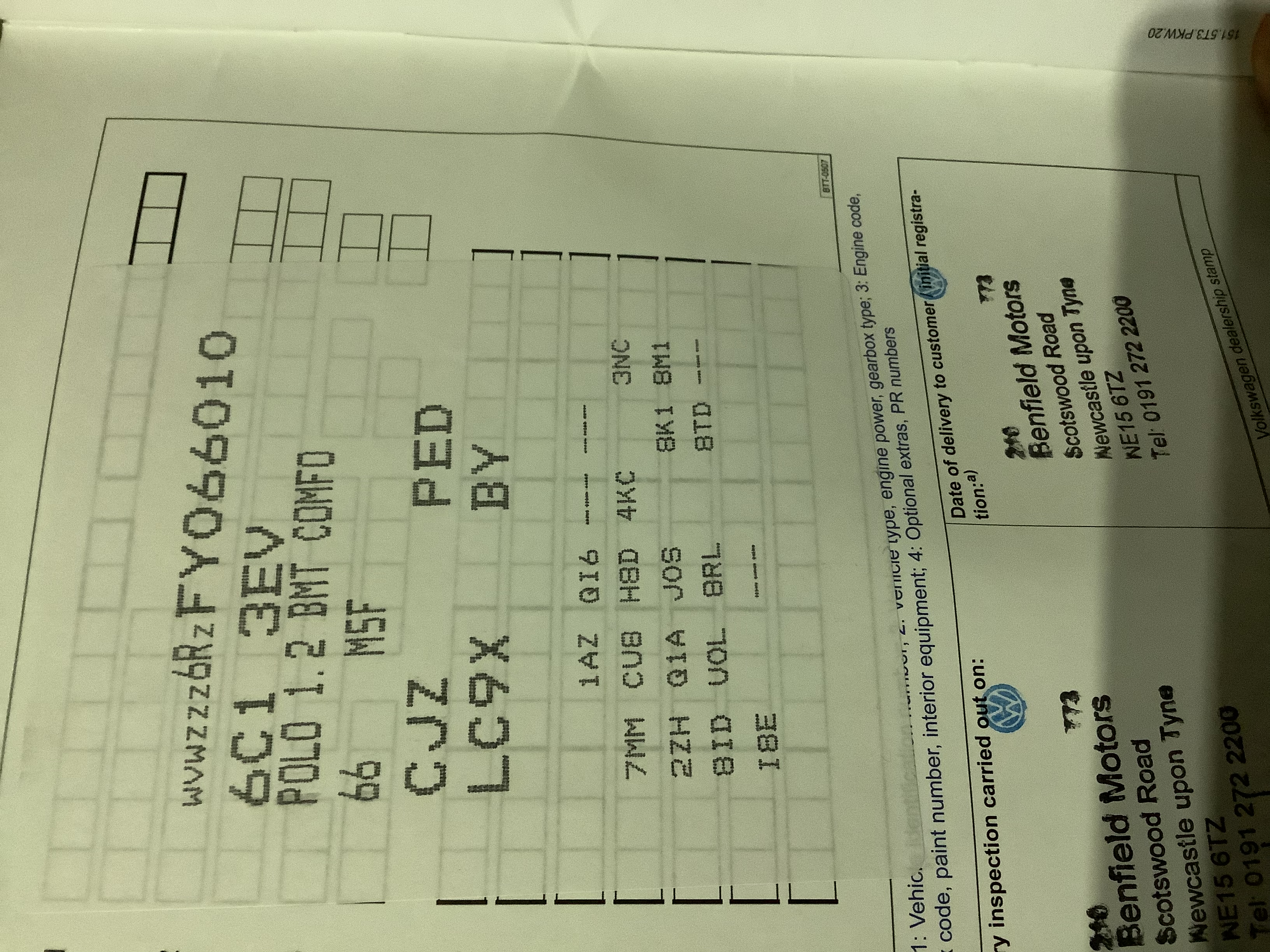

As a new owner, and member, I’m trying to find out as much information on my car as possible for future reference.
I have shown a photo of the information placed inside the service book so hoping that someone can tell me if my car has a belt or chain, my research to date is a bit misleading as some say belt whilst others equally say chain.
So my question is this,,,how can I tell for sure?
Also from that information is this car a 6R or 6C, and am I right in assuming that the engine type is a CJZ?
Lots of questions there in one post.
Many thanks
John

by iichel
The CJZ engine has a belt

by RUM4MO
If you need a second answer, I agree with iichel, the full engine code will be CJZC as it is the 90PS engine.
Statements about cam belt replacement times differ:- any/most UK based VW Group dealership will when asked, recommend replacing that belt at 5 years or maybe 60,000 miles just as they recommend for all other belt driven cars with engines built after round about 20078, the official VW workshop manual will define "checking that belt" at every service after year 6 or so, ie giving it a visual over its entire length, and replacing it when it shows signs of wear or damage. Note, one of the comments made in the official workshop manual is "this belt type is fitted for life unless it shows signs of damage/wear - it is not a periodic/scheduled service part" - or words close to that.
