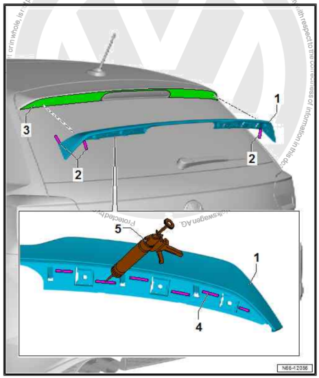

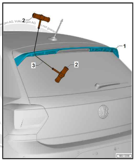

by Dark_cze
I believe service manual stated to use glue
//found it in VW Polo 2018+ - General body repairs, exterior - Cardiagn Service.pdf page 320
removal:
installation:
