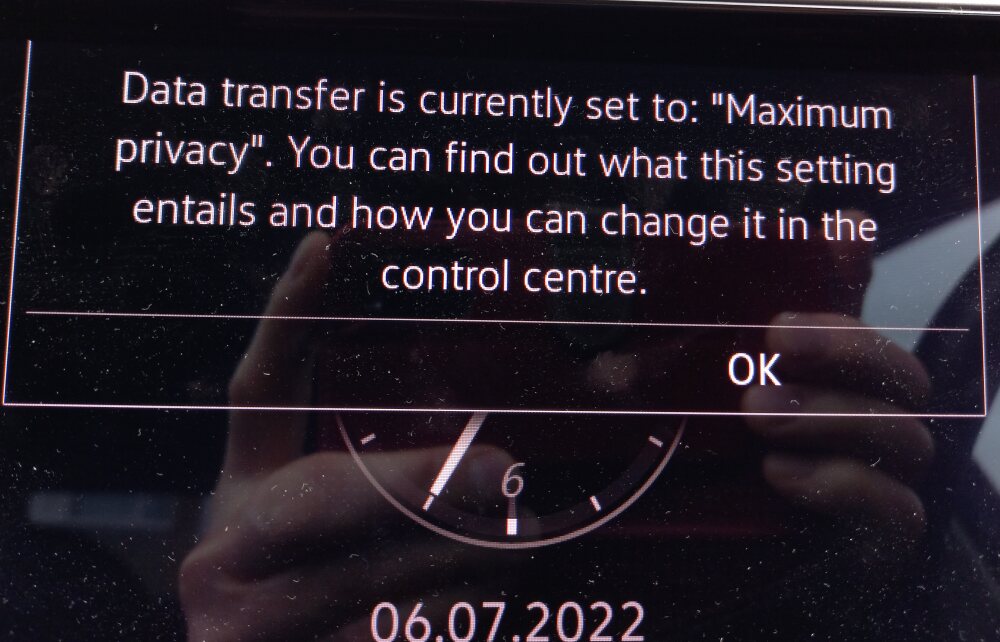

I have had this message on screen at start up for for months. I have to cancel it every time. The car has had its first service recently, at which I told them to sort this annoying issue out or at least explain how I could do so. They failed to do so. I naively thought that the "campaign Number 91CL software update to the onboard control unit" would have solved the issue. (exactly what was the update for anyway?)
The workshop manual does not explain how to change the settings to get rid of the message (Privacy Settings page 166) Many pages go on about "privacy" which are a nightmare to understand.
So how do I "change it in the control centre" (which isn't even refered to in the manual!)
Software update 91CL and how do I get rid of the "maximun privacy" message?

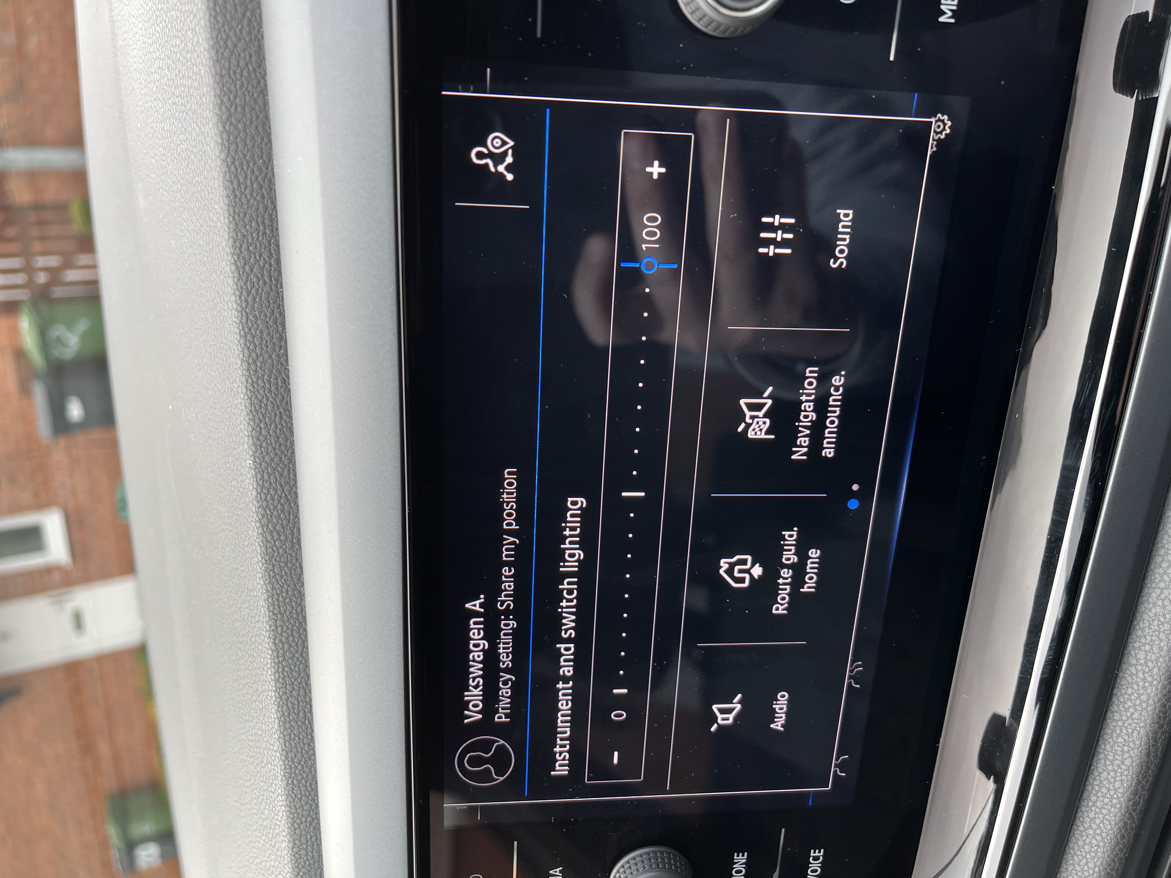

Re: Software update 91CL and how do I get rid of the "maximun privacy" message?
Pull the screen down from top (swipe down) and I’m sure u can change it on there
CLIFFORD2K1
- Posts: 45
- Joined: Tue Feb 11, 2020 9:26 am
- Drives: 1.0 115 sel dsg
- Location: Cumbria

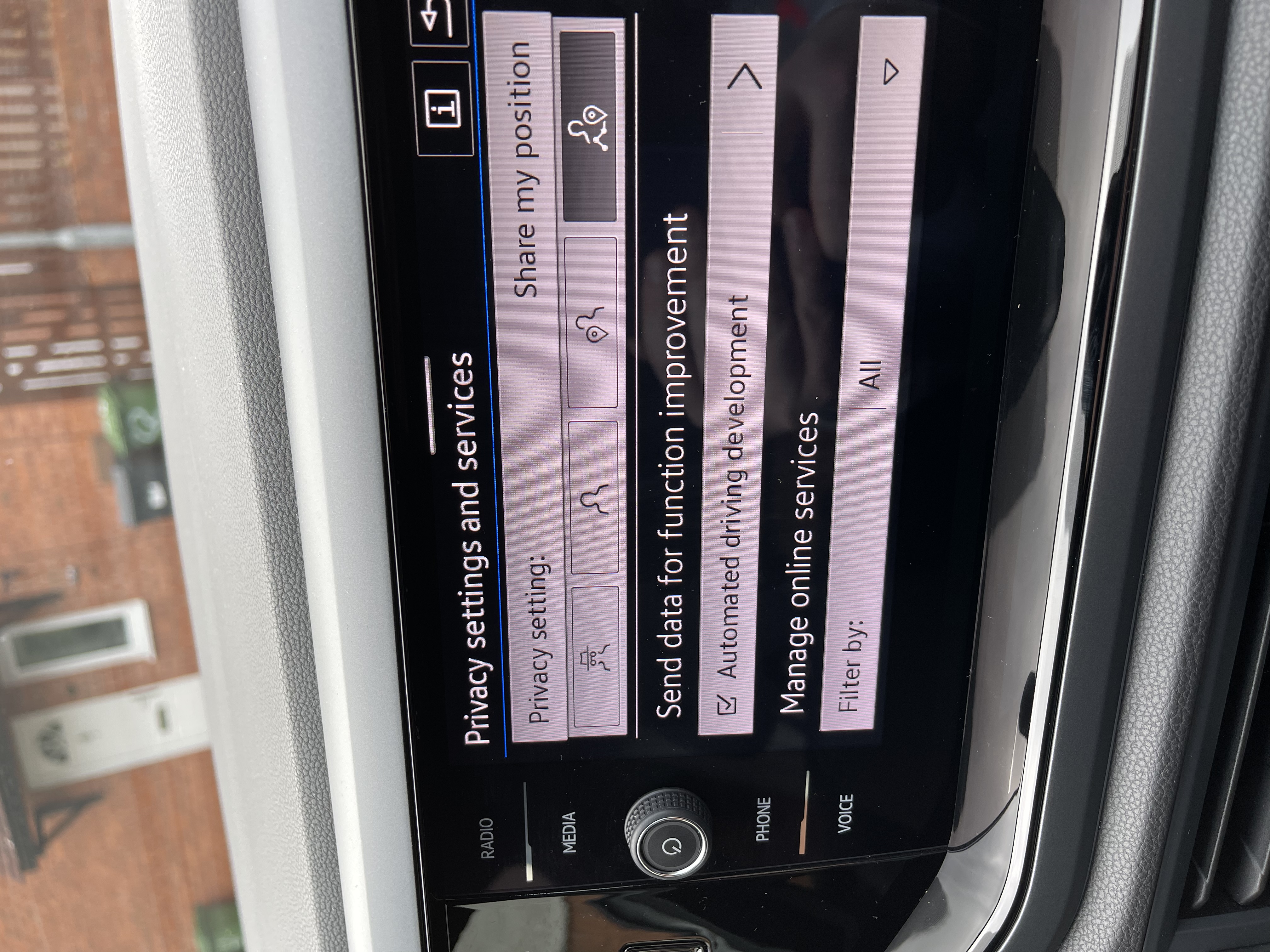

Press the right corner on this screen (the swipe down screen) to change it
- 4C9AA278-8DE8-4990-BDF6-C5BD88ECC6FD.jpeg (3.17 MiB) Viewed 5082 times
- 1B2EF217-731E-4813-B199-46CDF8965F47.jpeg (3.5 MiB) Viewed 5082 times
Thanks, I've got to the first screen by swiping down, but I can't proceed further as it seems I need to "log in with Volkswagen ID"
Is this the case please?
