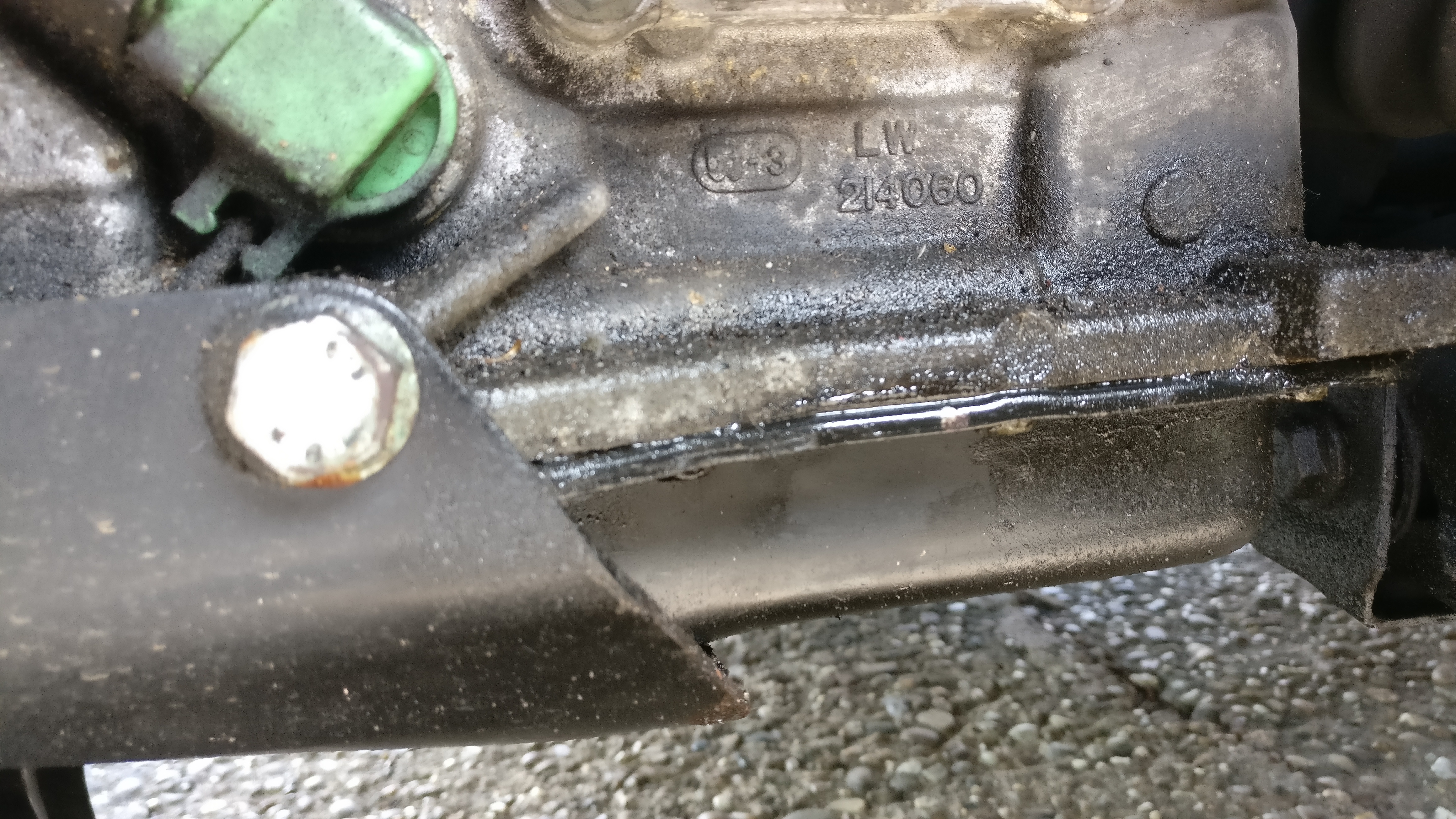

I've been trying to pinpoint the problem that causes transmission snatch after slowing/stopping and then taking off again. It's worse in the warmer weather, for some reason. I did read some comments about the ECU cutting fuel but the engine picks up and revs freely from slow/standstill whereas the transmission does not - so not sure about that as a possible explanation.

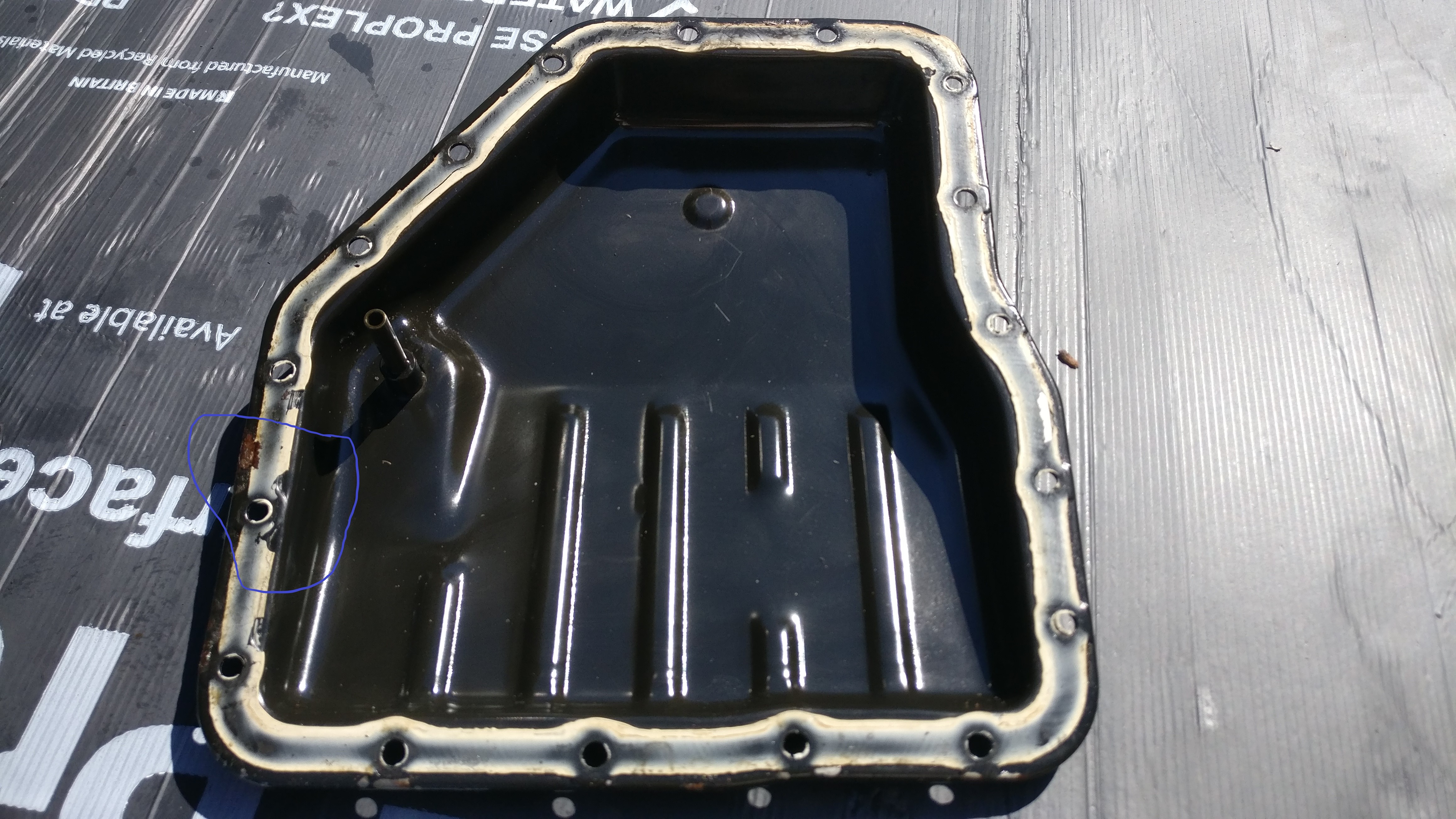

While doing some other repairs recently, I did notice 'oil' around the transmission as per photos. I'll have a closer look to try and determine if the oil is indeed oil or if it could be ATF fluid. Unlikely that engine oil would be deposited on the outside (near side) of the transmission case? On the inboard side, maybe?

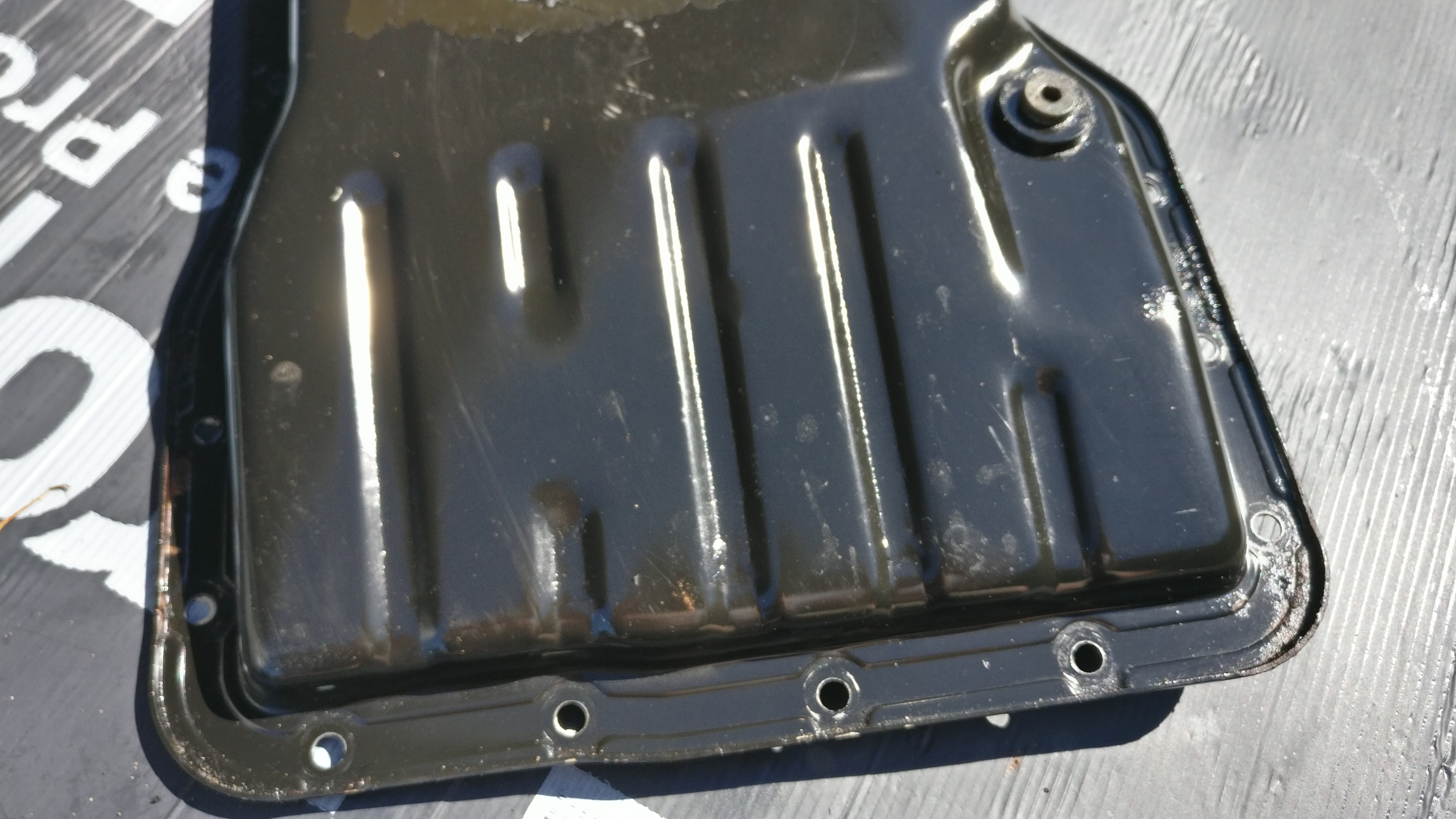

Started the job and found the ATF to be dark in colour with an odour that is not fresh.

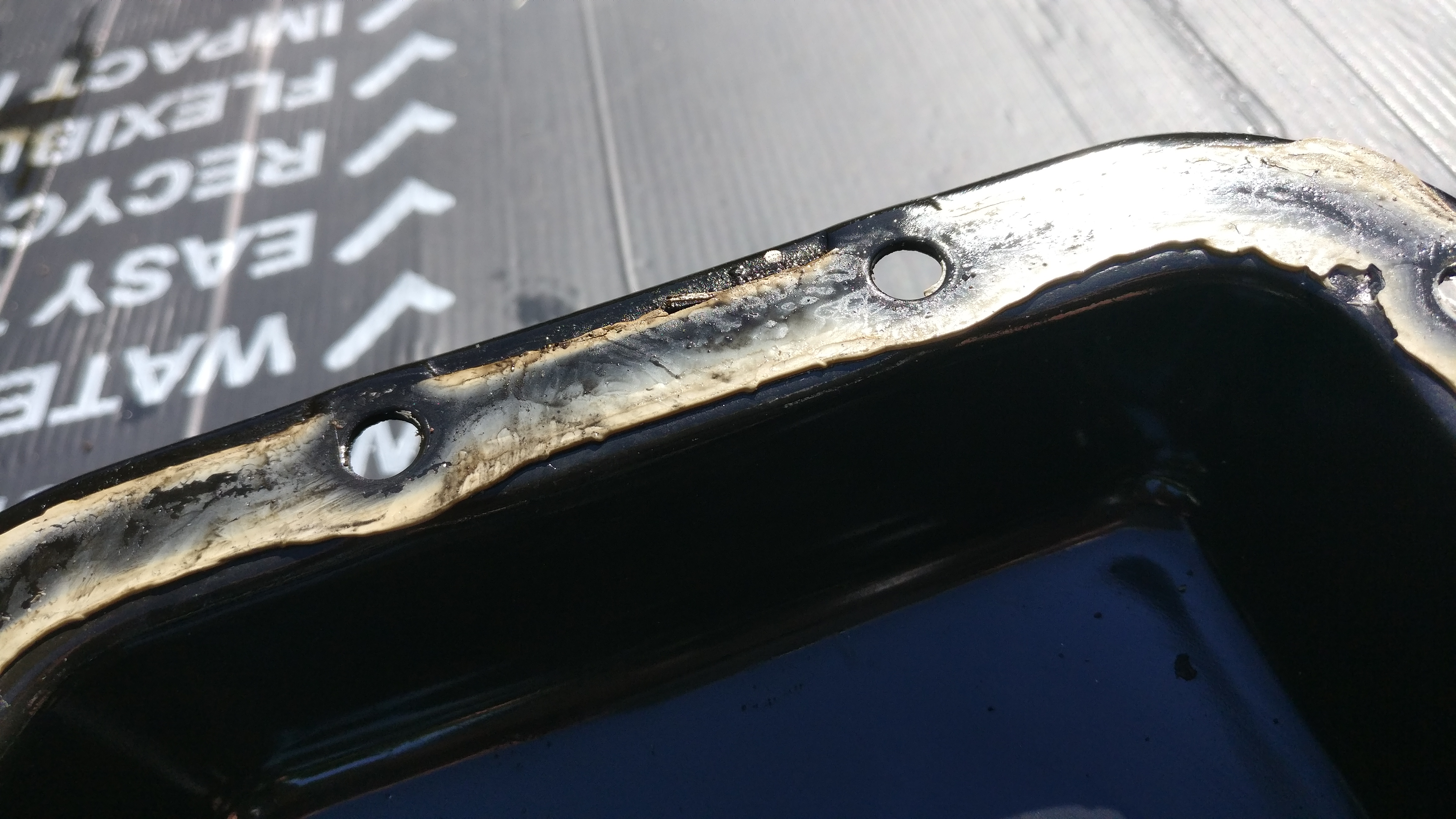

I'm not sure there is a leak from the sump but the sealant around one of the bolt holes looks a little suspect. I was surprised to find sealant as I had purchased a rubber seal for the job and it's not correct. Does anyone have an idea what sealant/mastic is needed for this job?

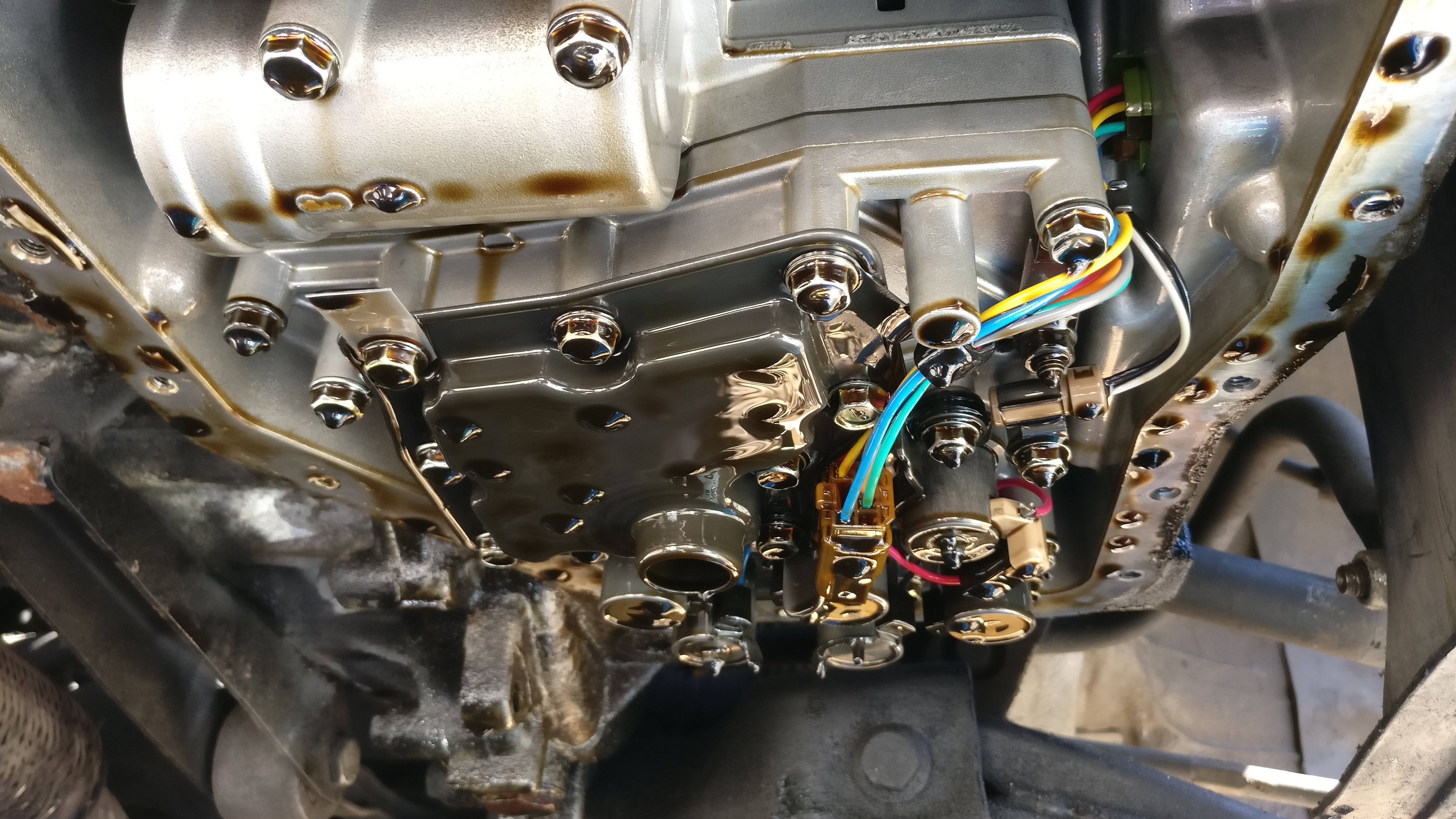

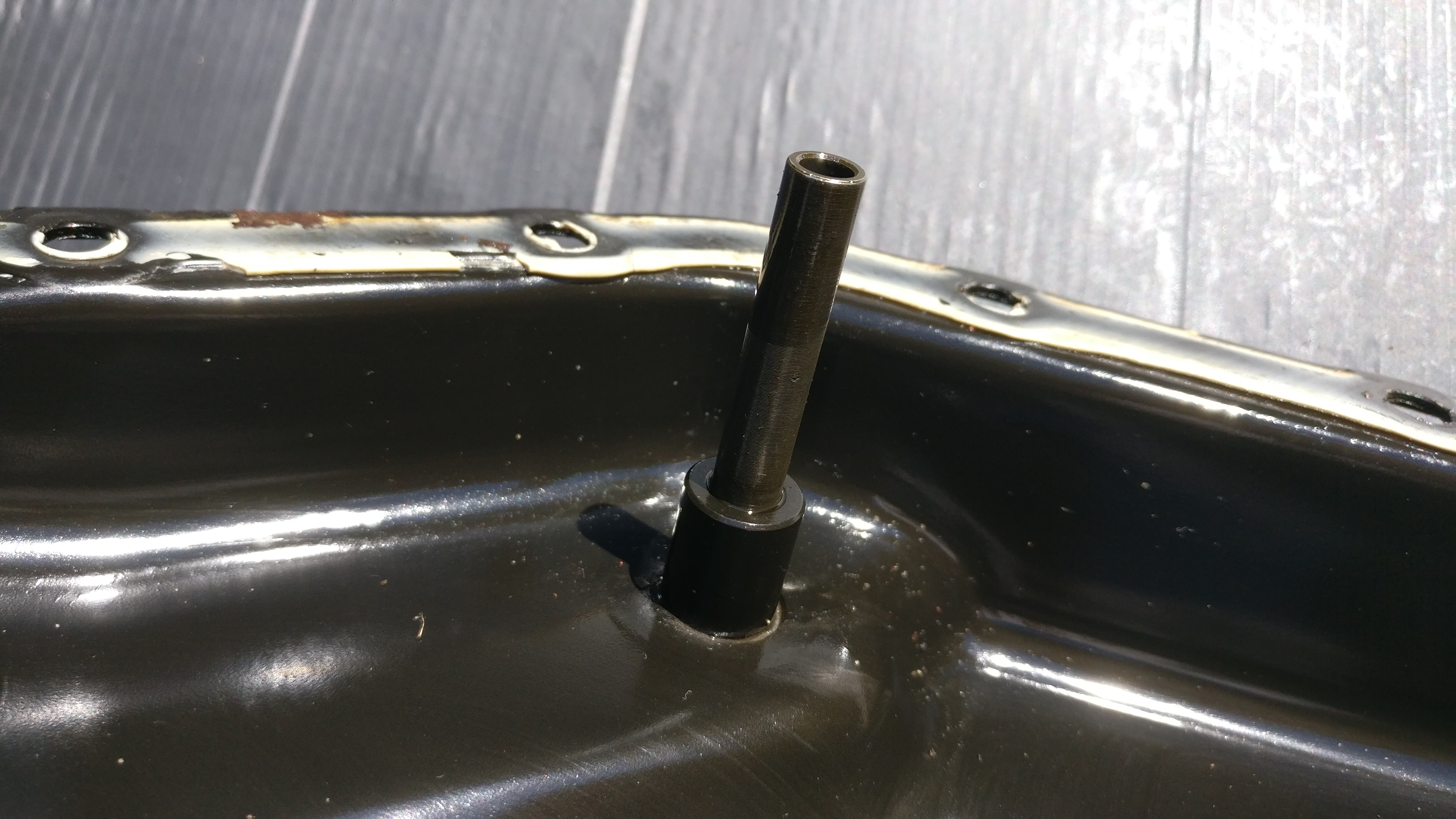

I dropped the strainer and more fluid came out. The strainer itself looks OK, though I have a new one at hand.

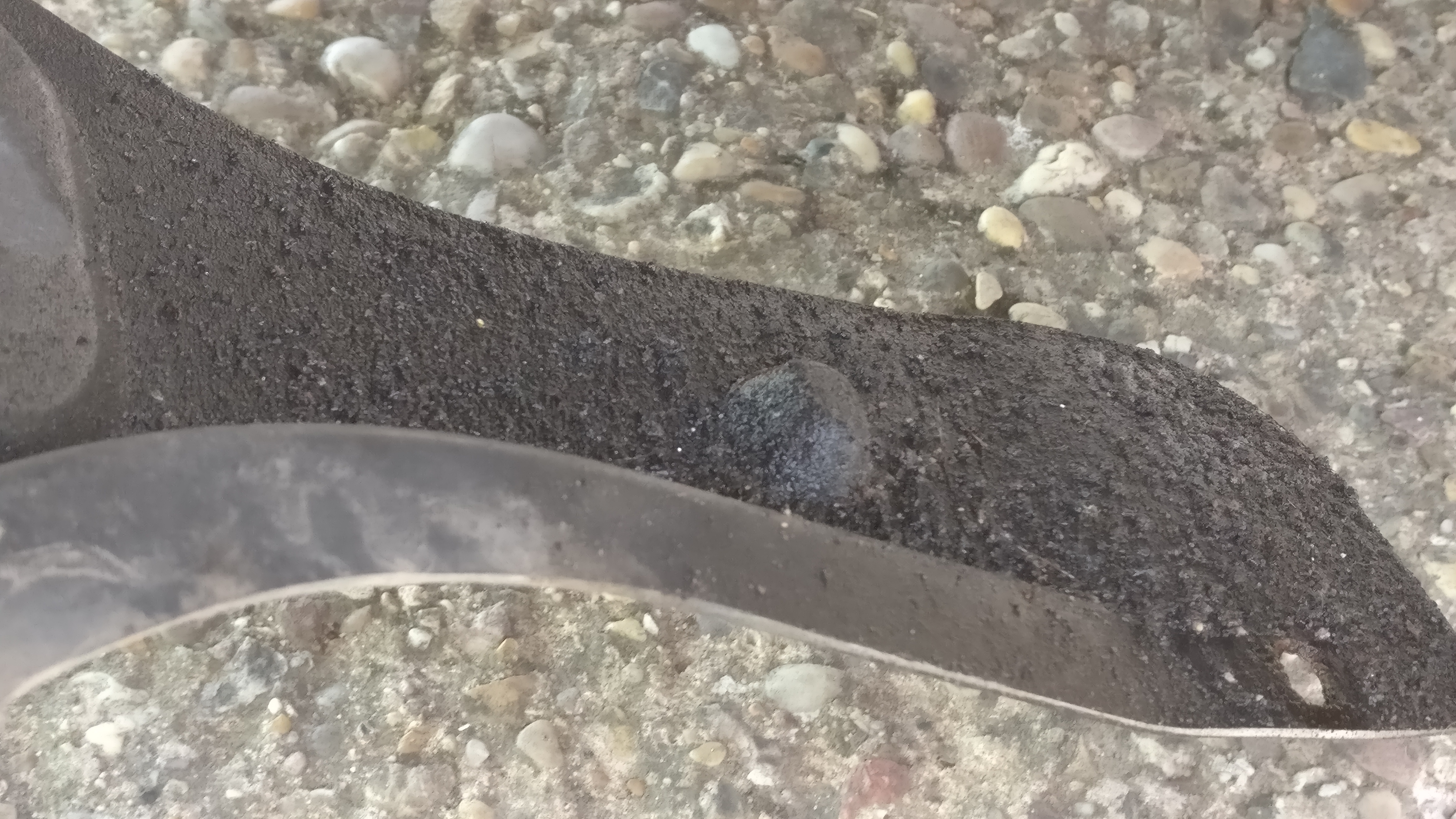

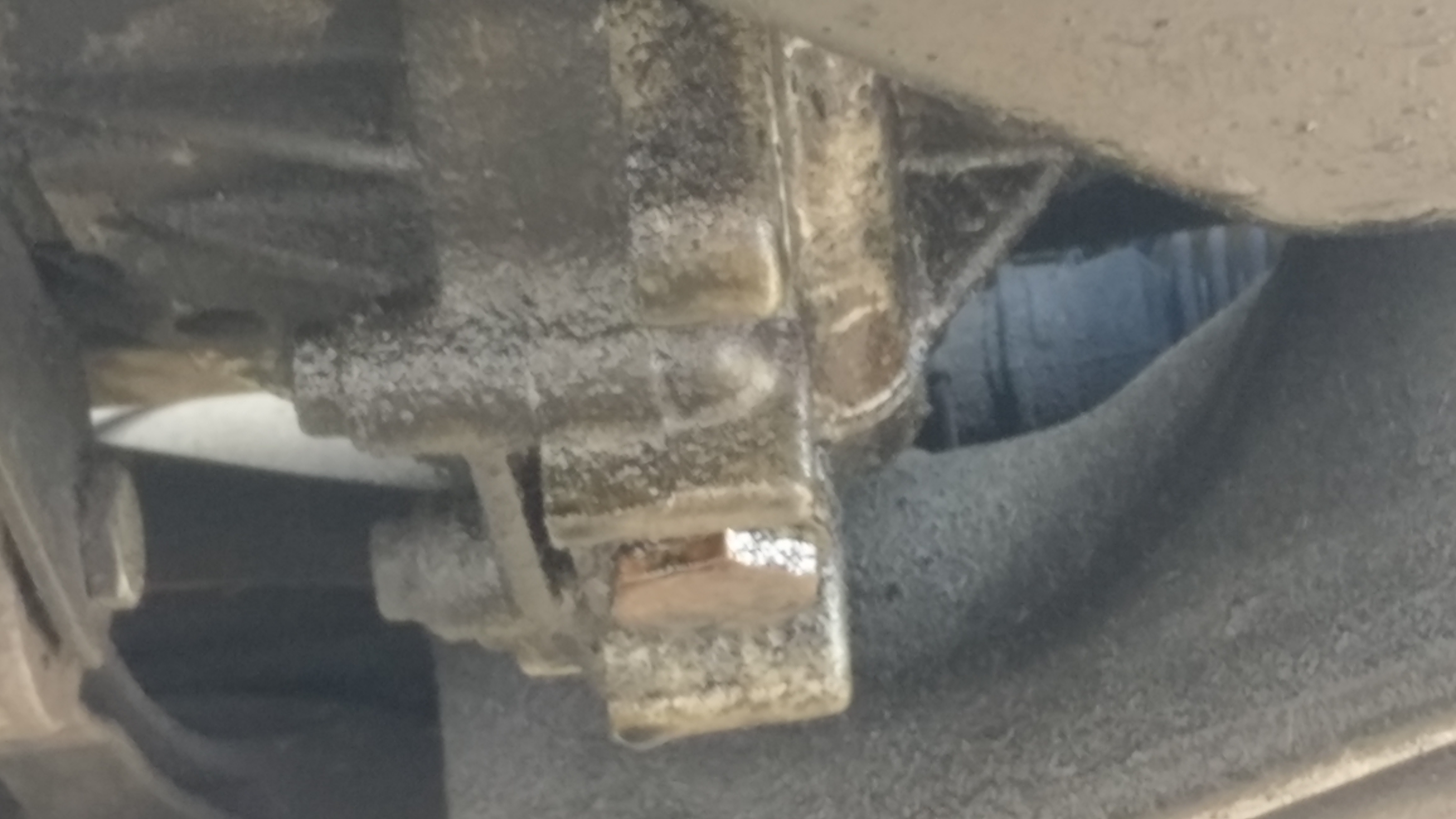

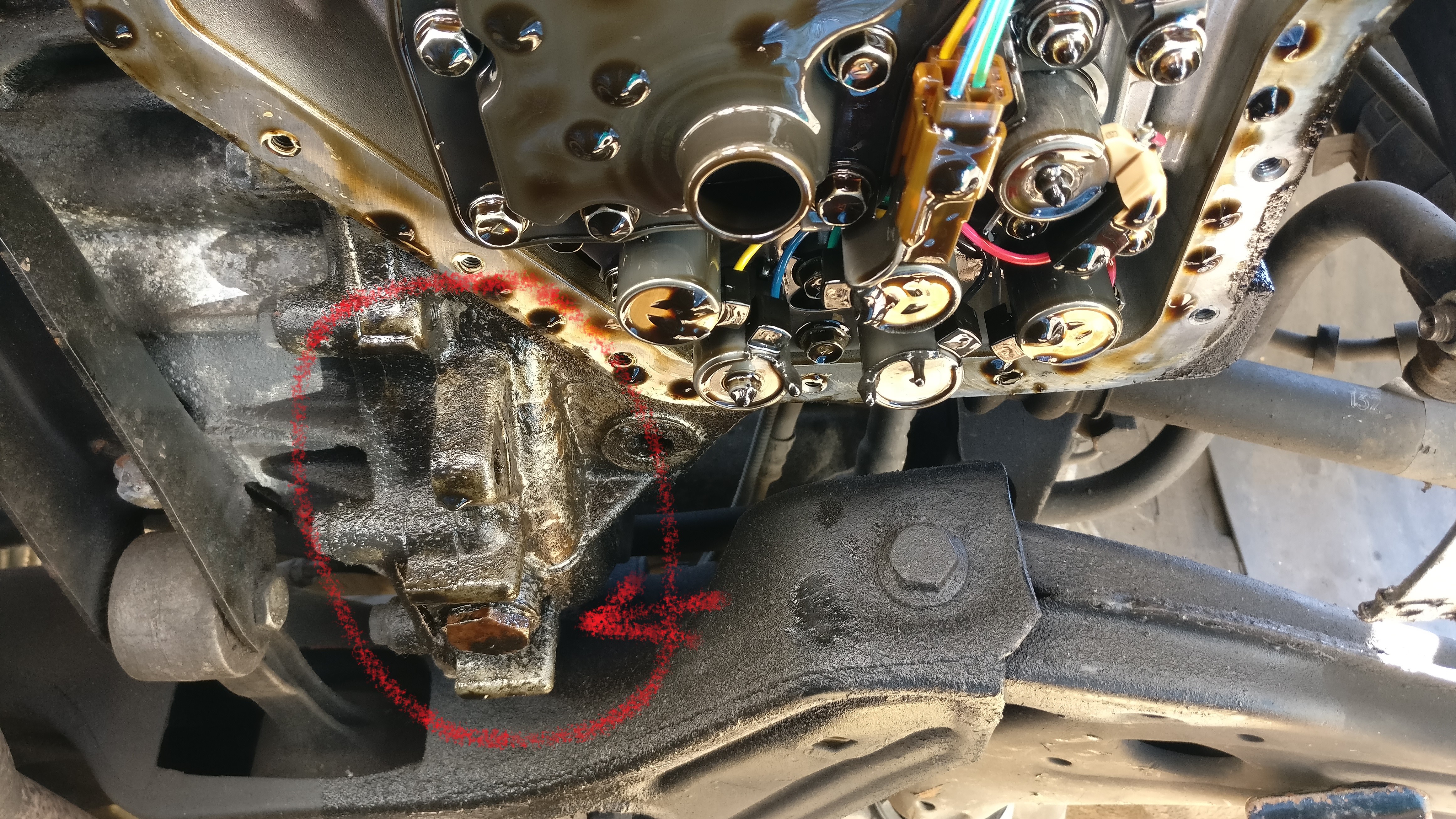

There is a deposit aft of the auto box and I wonder if there is anything leaking around there. Will clean it up and try to find out. Does anyone know what the big nut/plug seal is back there (see photo below)?

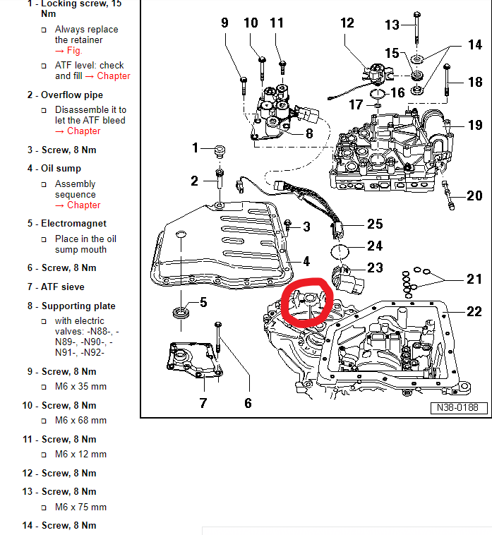

Posting this which might help anyone doing this job with torques!
Interestingly, the schematic shows the 'plug' I spotted from the underside. It looks like this might well be the final drive/differential drain plug? Since, like the auto box these are 'sealed for life' I can find no information at all on what it is, or how to drain and refill the final drive, or the gear oil specification.

For anyone doing this job, the hex plug is the lowest drain point for the ATF. Another 100ml or so of ATF dropped when I opened this.

Just in case anyone ever takes on this job, I used Dirko HT (red) to seal the transmission sump pan after cleaning and refitting. I had a tube of Dirko grey at hand from when I did the top end overhaul back in Dec 2018/Jan 2019 but did not want to risk it being up to spec. I think there is only 20C difference between regular Dirko and the HT version (so of no import here). It's not that difficult a job really, just a bit messy. Also, you don't need a computer since you can use an IR thermometer to check the transmission sump pan (which will likely read a degree or two low from outside). The temp range is 35C to 45C and I went for 40C. I would not measure out and refill fluid if it has not had a service before, especially when the overall volume could be low like mine was!
