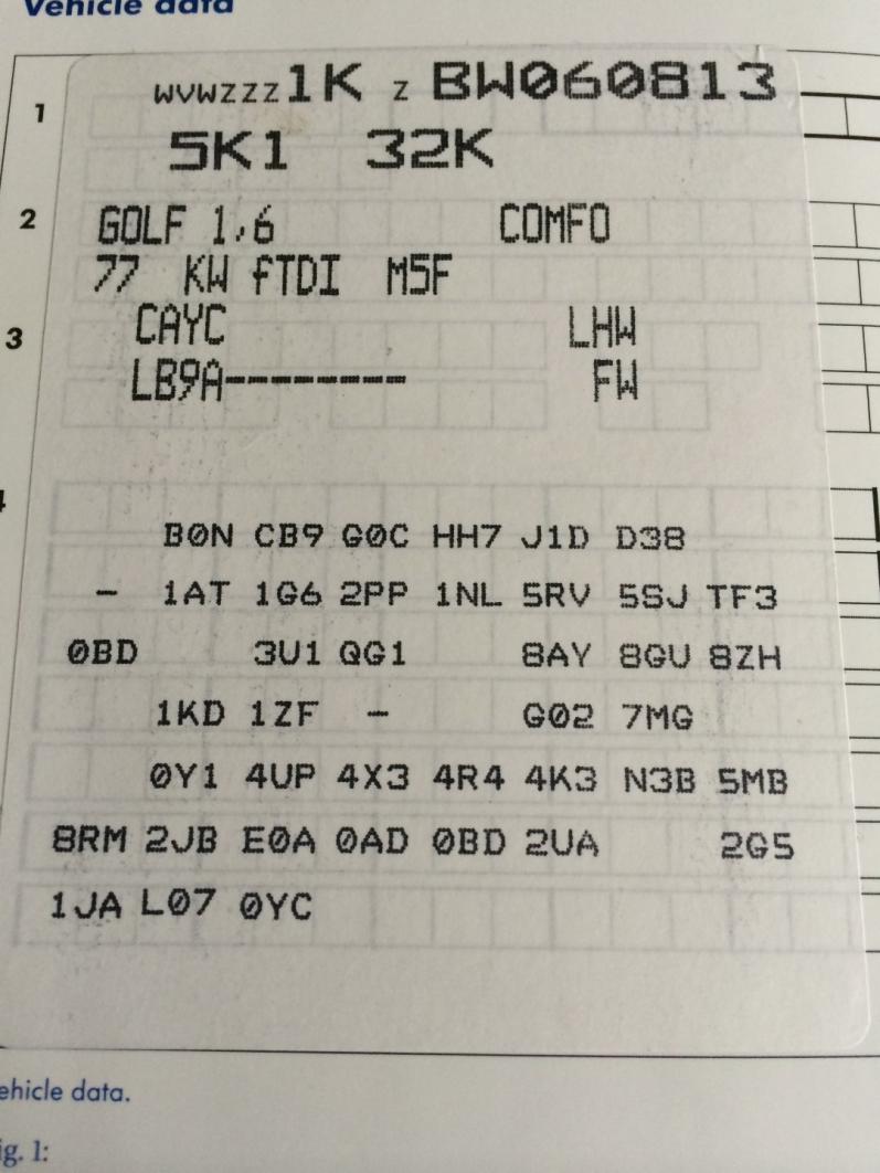

Vw’s come with two stickers from factory, one goes in the boot floor area , the other goes in the front of the service book.
Look there first, the vin plate will not give paint code.
Re: Location of paint code label.
Posted: Sun Oct 09, 2022 11:45 pm
by CarbonChaos
Your looking for something like this
This golf’s paint code is LB9A which is candy white
