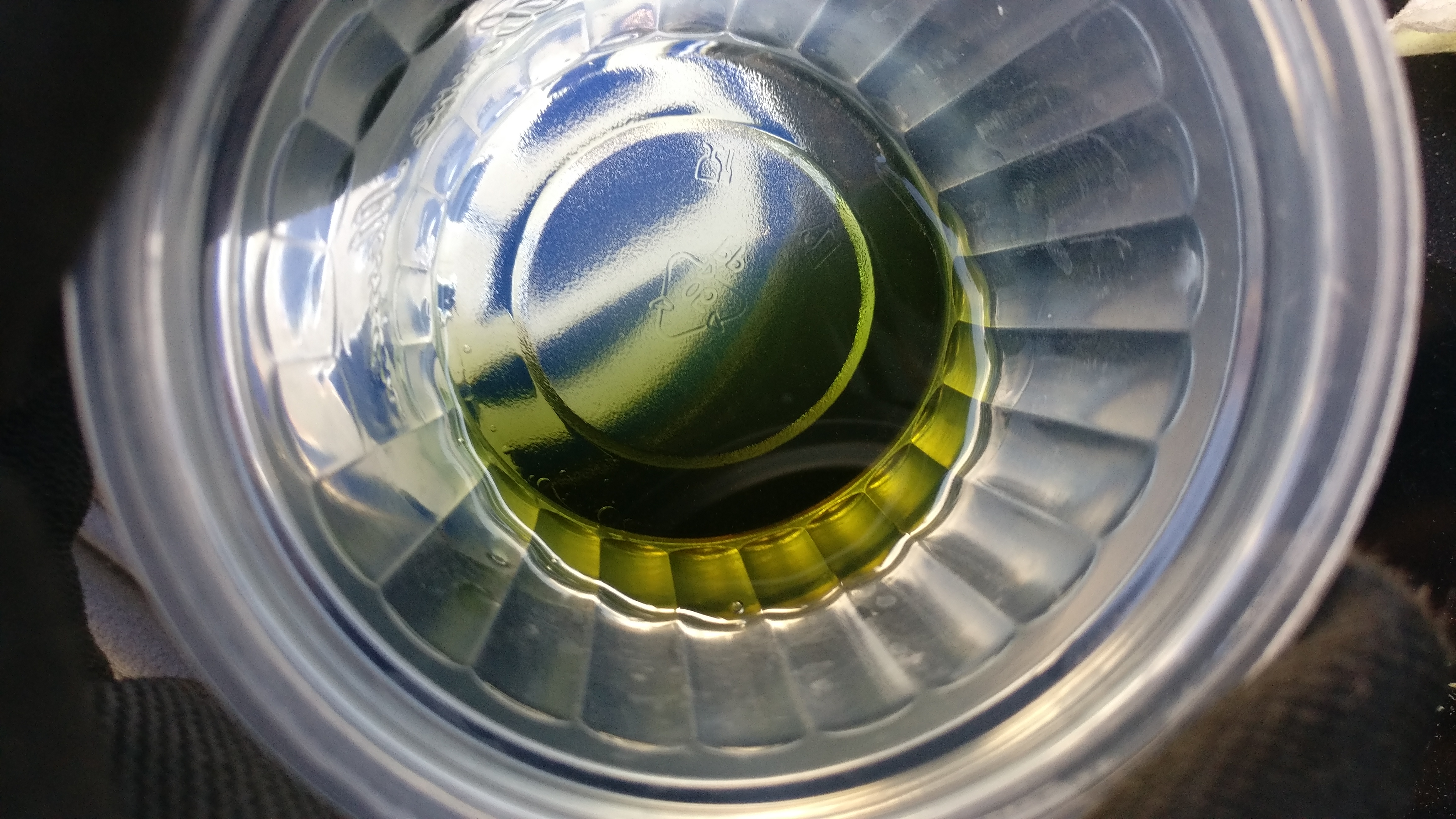

I was surprised to see the fluid as below. I've owned the Polo for 12 years now and since around 29,000 miles.
It seems to be clean?

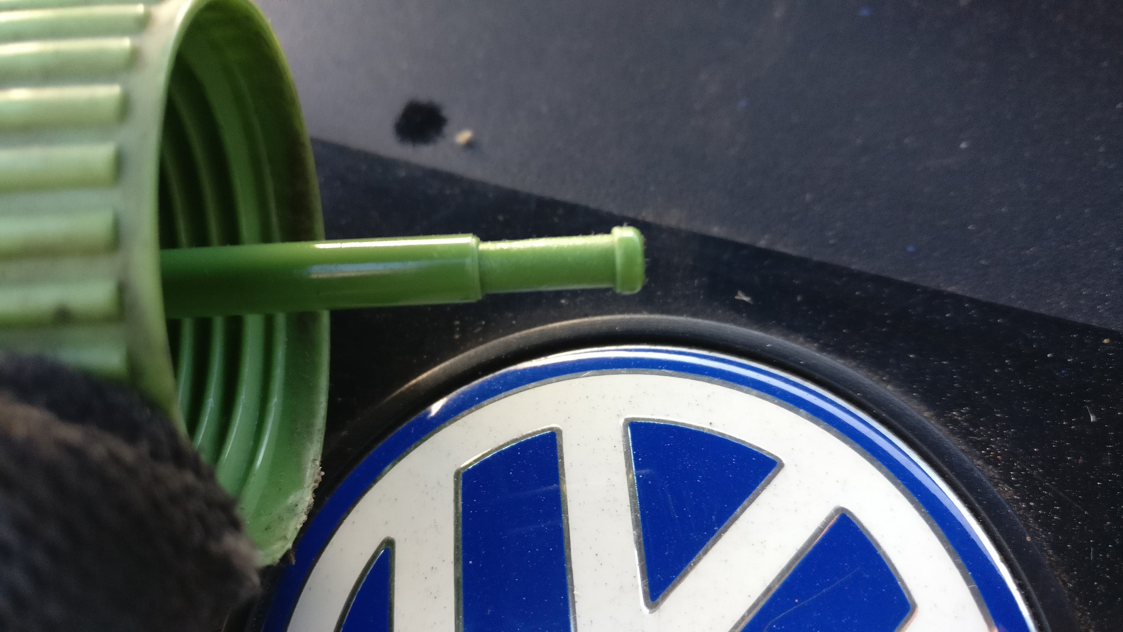

The level appears to be low as there's no indication on the cap/dipstick (dry).

Fluid seems okay to me....maybe compare with some fresh from a bottle. Not sure about the level...as you say, not an obvious fill level mark on the 'stick'.
Does the reservoir have a high/low marker on it? Is it possible to see it?

Plumbers pliers! Used a large syringe and removed about 13ml. Fluid looks darker in the syringe and waste receptacle. Whilst the fluid is in fairly good condition, decided that after 20 years it's time to replenish using the syringe/decant, and top up and dilute method! A fair bit of work done over the years, including a 25K top end, to keep it running nicely.
