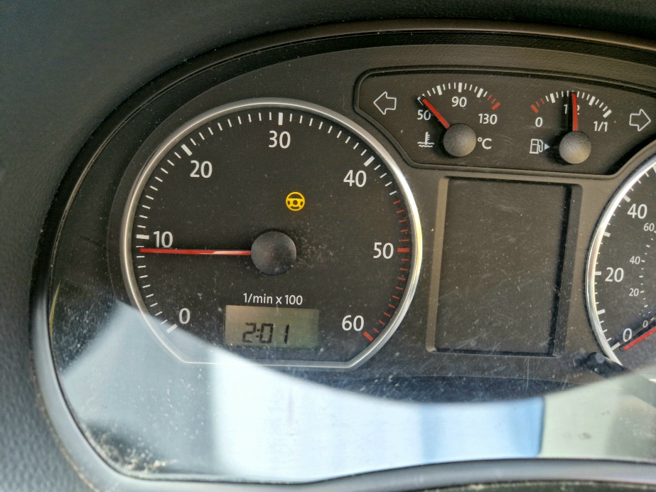

OBD says no fault stored in ECU
Fault light just came back on, rechecked but no fault showing on OBD
- Fault light
- 20230319_135936.jpg (205.67 KiB) Viewed 3215 times

Nothing in adress 44?

A basic obd reader will ONLY read the engine ecu
Re: Power Steering Warning Light
Posted: Mon Mar 20, 2023 7:24 am
by Maarten
I did not know that.
Power steering fault should not be stored in the engine ECU memory.
Usually in adress 44 Lenkhilve/steering aid
I would suggest to go to someone that does have a full OBD2 scanner/reader.
Faults like this will most certainly be stored in the controle module as at least intermittent fault
