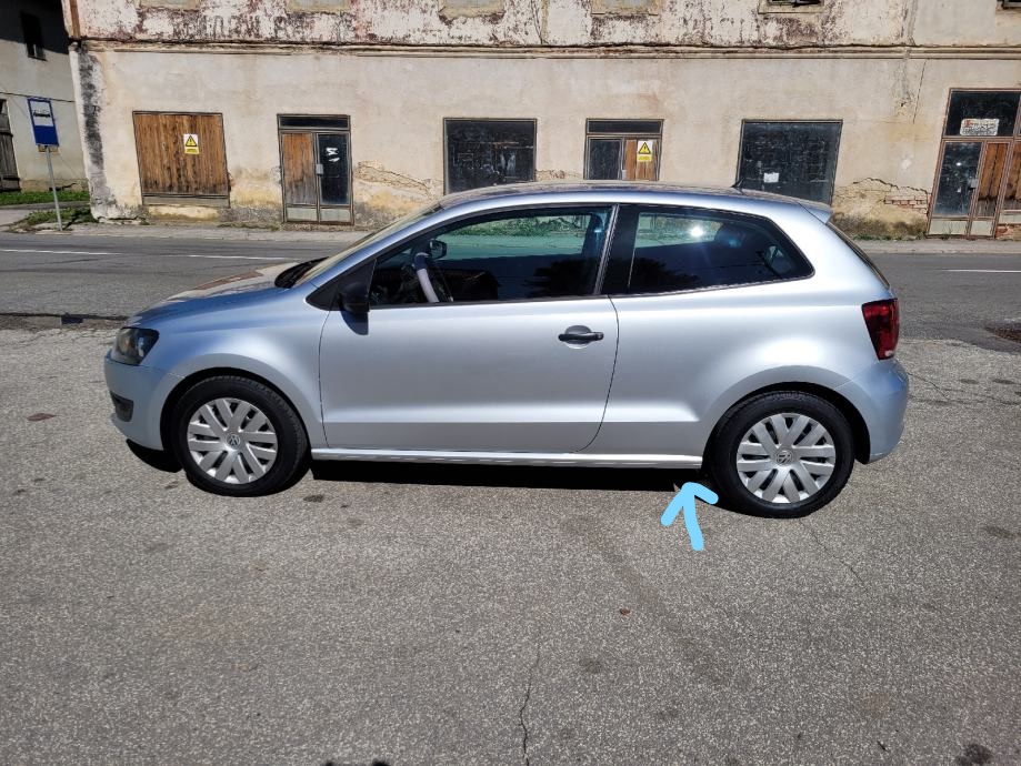

I was cleaning today my car, a bit more detailed way. And I found out something shocking. Rear wheels, when you undo the bottom tx25 bolt (the one thats under the sill) that holds the inner fender, and you move it away so you can look in rocker sill direction (bottom) it's OPEN :shock:
Does you car have some kind or grommet or am I missing one??
I was shocked, because dirt, water, salty snow slush can get and travel all down the rocker (towards the front wheels) and eat it inside out.

Guys remove this bolt, and move the inner fender towards the tire.
Get your self hand of this
and spray inside the sills. They are open, and dirt, water etc will run inside your sills. They will rot from inside
ps- if you are going to r
wash them first, open the large grommets on the front and back because it will fill up with water.

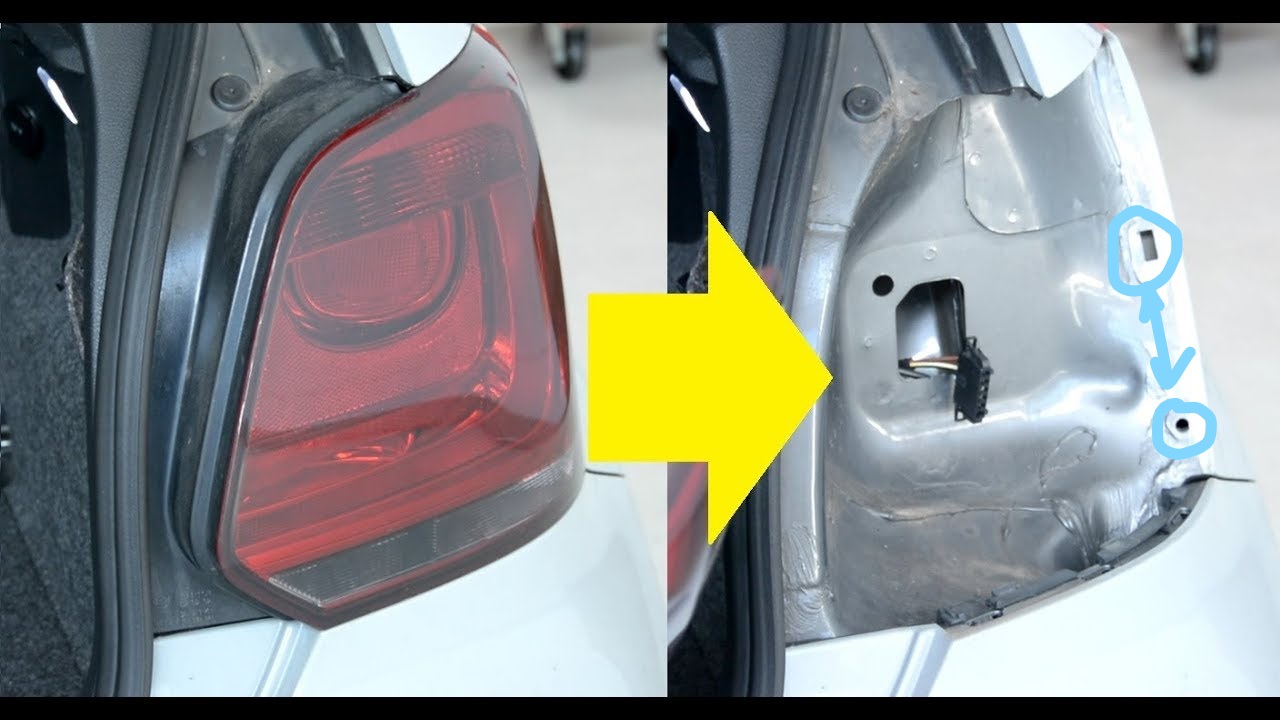

Rear arch rust prevention
spray cavity wax in those holes, easier than removing rear inner fenders, and removing the plugs at the top (12 o'clock)
