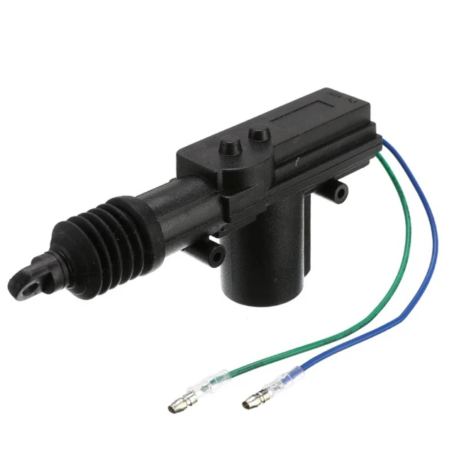

Yes - mine has got the electrically operating centr. locking system (It is the "Joker" model - meant only for German inner marked as i have read: 1.0 AER, manually operated windows, key operated door locks (on both fwd doors, locking fuel cap, every lock (incl. the tailgate) operated via the same, i.e. ignition key), sunroof and power steering, but for example no saloon light switches on aft doors and no boot light at all ?). the actuators are very similar to the universal ones (except mine are different colour - whitish/beige, "MES / Swiss made") :
Perhaps the "Joker" didn´t have vacuum, so the original owner got an electrical kit installed (and the fitters could not think out the mechanical fitting solutions between the tail gate lock and electric actuator? This was the original reason toi write here to find out any info about installing / pictures , etc of the tailgate´s el. actuator , but this may not have been the factory cas at all, then ...

... Anybody to share knowledge, pictures, info, about possibilities/how to install this (pic in previous post) universal type elec motor actuator into hatch lock (5D, 3D models) ? Even pics/video about the vacuum operated factory solution would be helpful, i guess...
