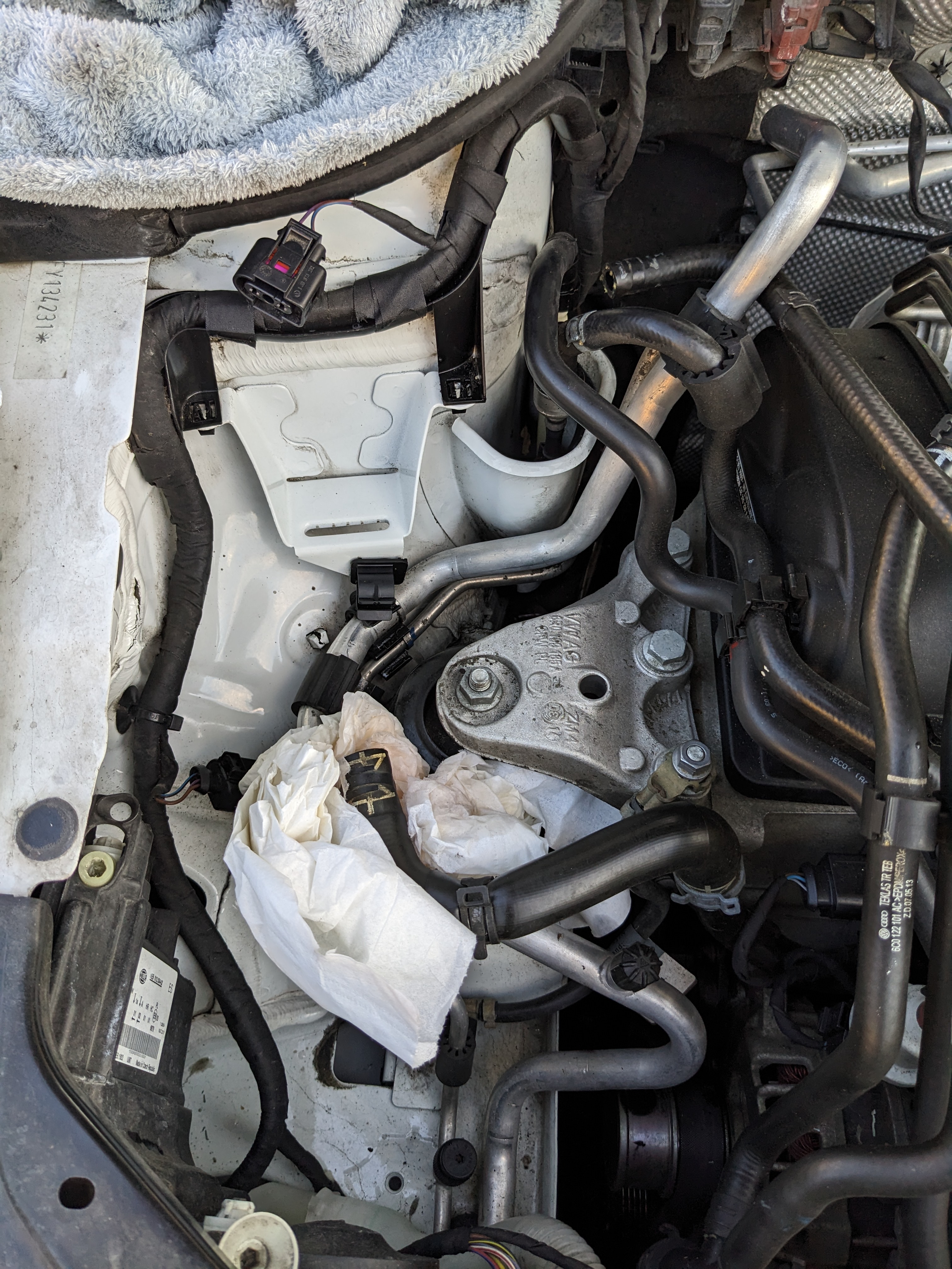

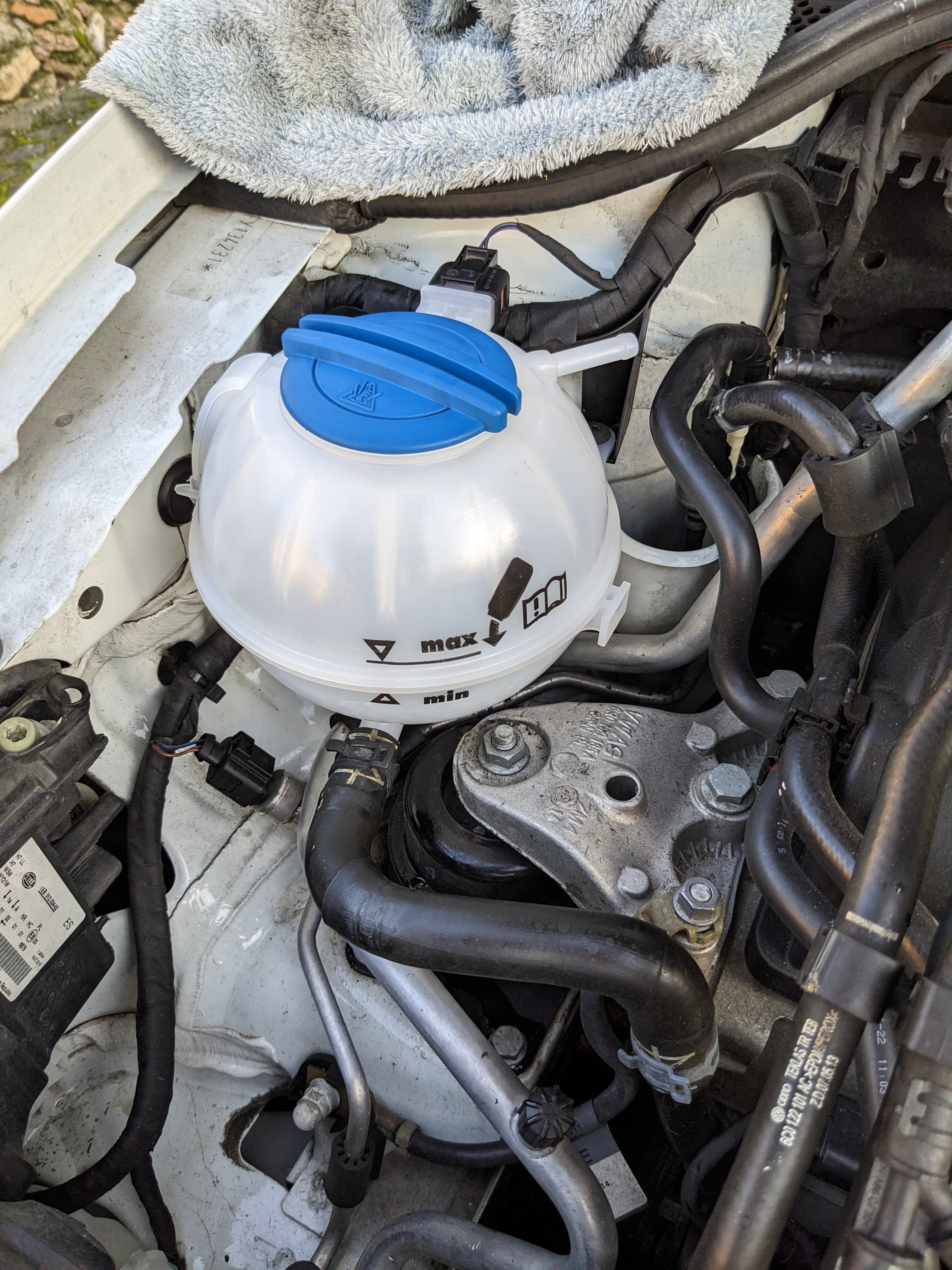

Could someone tell me the inner diameter of that pipe ?
I want to buy something to connect in it for the refilling process.
Le_Combattant i hijacked you picture. If there is any problem please tell me to delete it immediately.
Re: Refilling coolant system with vacuum kit
Posted: Sat Dec 16, 2023 6:30 pm
by ciclo
Posted: Sat Dec 16, 2023 7:24 pm
by Le_Combattant
giannis20vt wrote: Sat Dec 16, 2023 1:02 pm Could someone tell me the inner diameter of that pipe ?
I will send you in jail for that !
Ahaha I'm joking man, be free. But IDK why, picture doesn't show up.
Posted: Sun Dec 17, 2023 4:50 am
by giannis20vt
ciclo wrote: Sat Dec 16, 2023 6:30 pm Maybe it's 6.3mm (new unused coolant hose). https://www.oemvwshop.com/6c0121447-coo ... e-p313874/
🤔... :arrow: viewtopic.php?p=598431#p598431
This is the information i want, thanks.
So i need a coupling with 8mm Outer Diameter.
