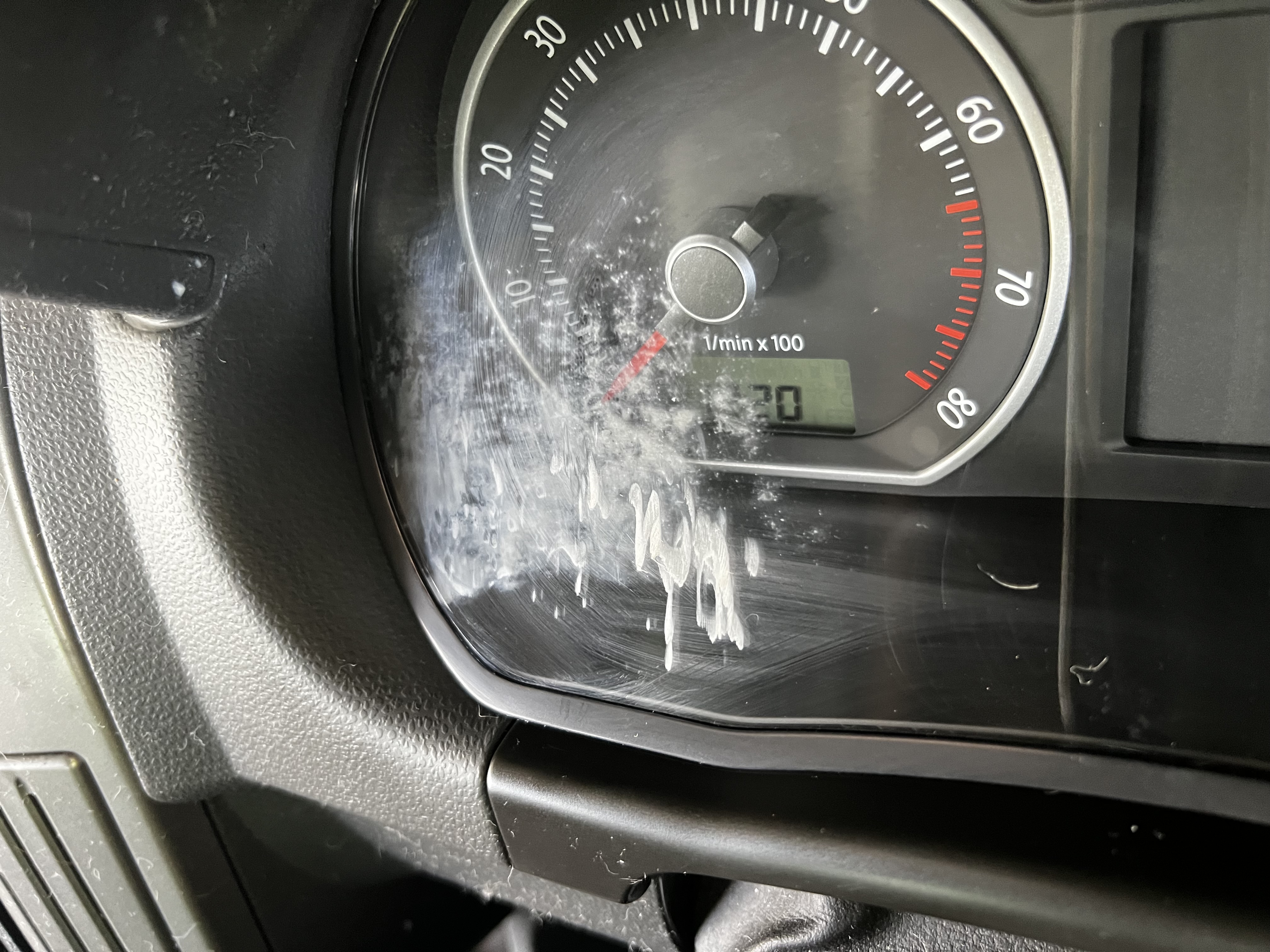

Putting our red GTi into storage for a while and noticed the plastic cover for the instrument cluster has these marks on it. I tried headlight sealant spray (no difference) and then buffing the plastic with a Dremel - no improvement. I'm assuming it was caused by some solvent we used for revitalizing the trim; possibly even sunsceen.
Anyone have clever ideas or am I off to the wreckers for a whole cluster?

You can switch out the transparant front.
Just pay attention that you buy one with the mattsilver rings.
The one without will also fit but than you won't have the rings around the speedo and rev counter.
Replacing is easy.

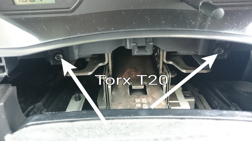

Loosen the 2 torx screws (T15 or T20)

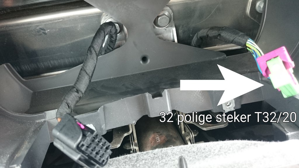

Release the 2 wire connectors on the back left and right

Look on Ebay, buy the cheapest one with the rings (from factory on it) and make sure that the transparant part is pristine.
Doesn't matter which version you buy, they all fit.
Search for 6Q0 920 82x x (the xx are only for version of the options of the cluster and they are of no concern to you)
All fit of 9N and 9N3 (2001-2009) 6R does NOT fit!

These pics I made a few years ago
