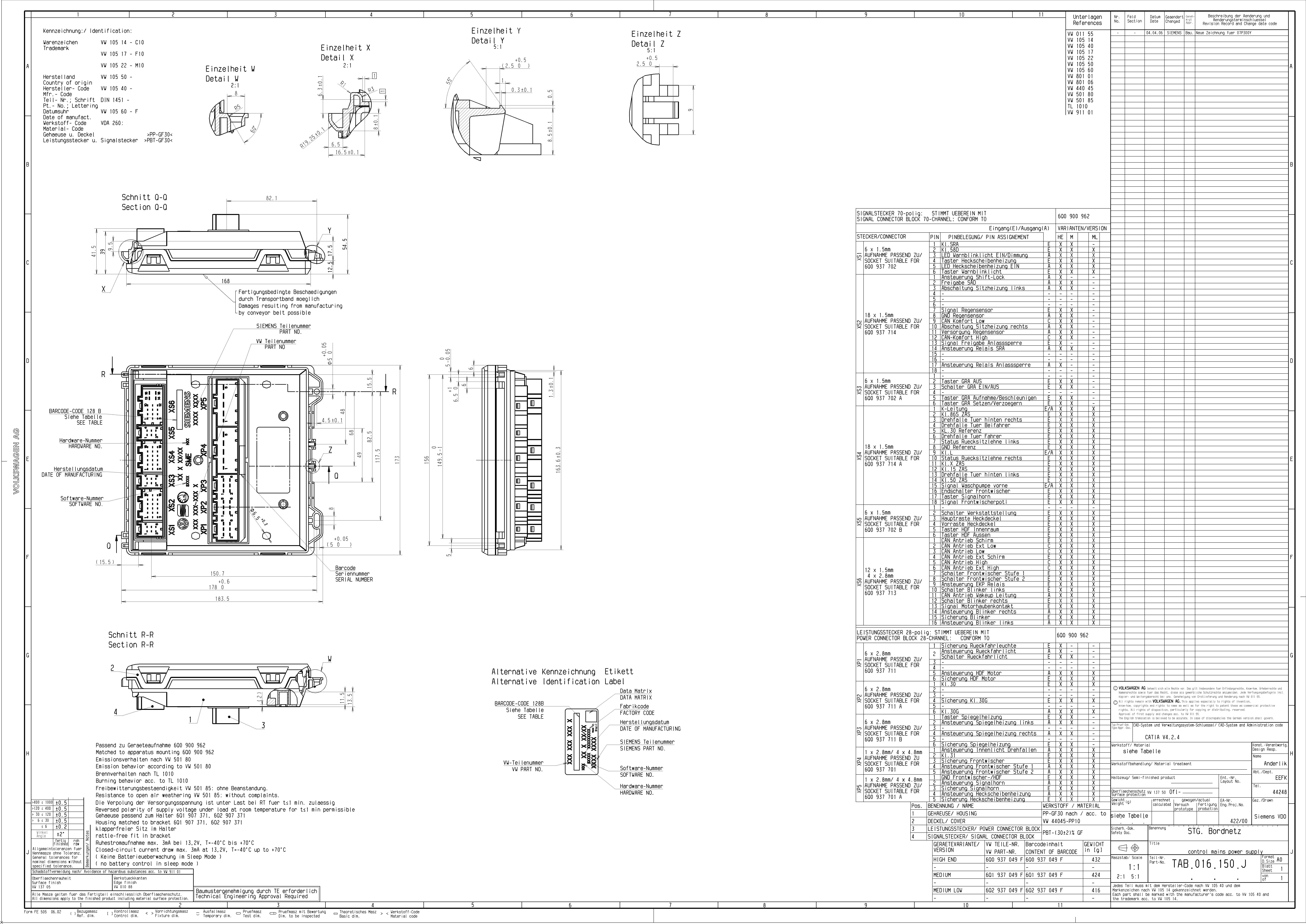

I purchased an Android head unit that uses an ISO harness. In addition, There are a couple of wires that I need to tap into as follows:
Pink - reverse signal from vehicle (for backup camera)
Brown - parking brake (disable/enable video display)
I had a look in the DIN cradle and I can see only the ISO connectors, and wires for the powered DAB antenna (I fitted a while ago) and similar.
Is there somewhere near the centre console that I pick can up the signals for the pink and brown wires above pls?

In the BCM you can find the wires needed
Look at this overview
PIN bezetting BCM Polo 9N 9N3.jpg (3.57 MiB) Viewed 18211 times

Backup light is rückfährlicht (rueckfahrlicht)
Handbrake might be the Anlasssperre

Thanks, I'll have a look. It should be possible to trace from there.
