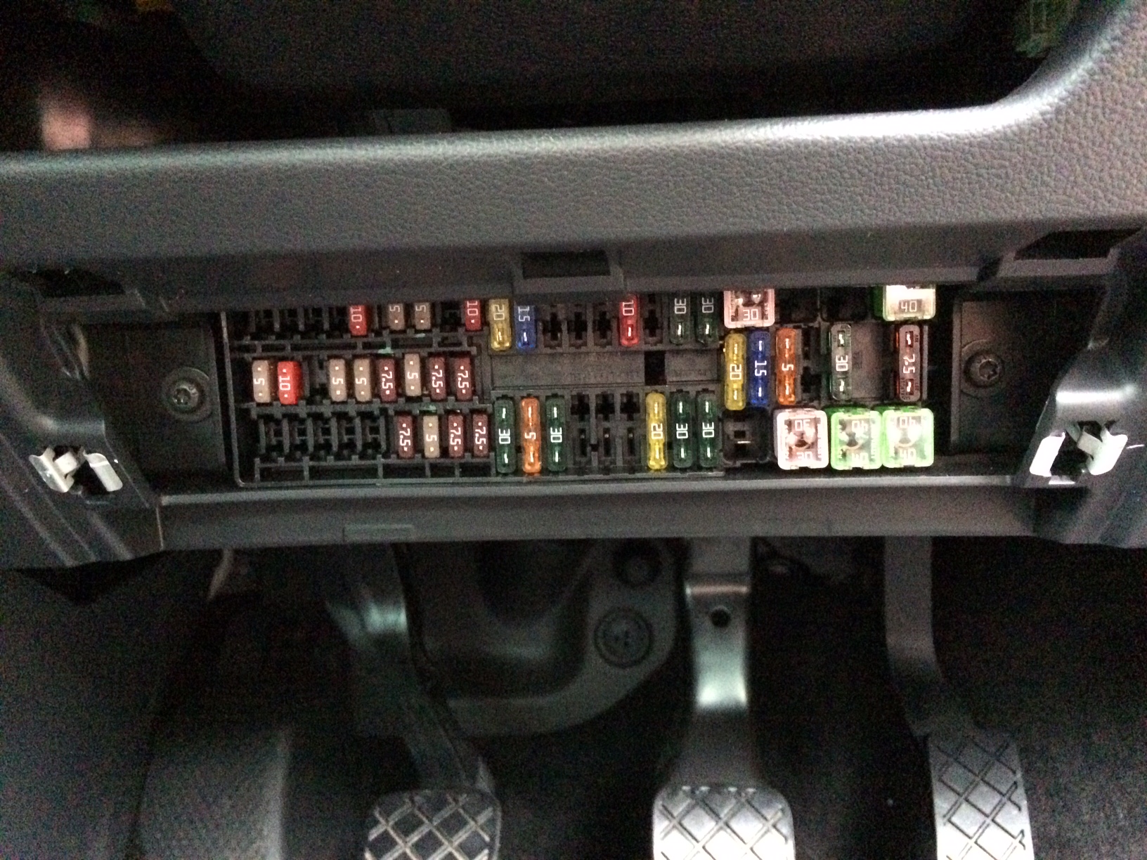

I did eventually take a photo yesterday to compare with the multiplicity of diagrams on the internet so I've attached that

I've been through the list of fuses on this site and compared to ours. The only that looks to me somewhat odd is 30A in position 8 which is for a dual clutch gearbox. The rating is right so maybe that's a red herring.
I've borrowed an OBD and it gets a code P025C related to the fuel pump module controle circuit low. According to the list Fuse 49 is used for this but that is present and correct.

Check that the SC8 fuse slot is empty, then replace the 30A fuse to the SC13 fuse slot.
The SC13 fuse is for the +15 power supply of various systems.

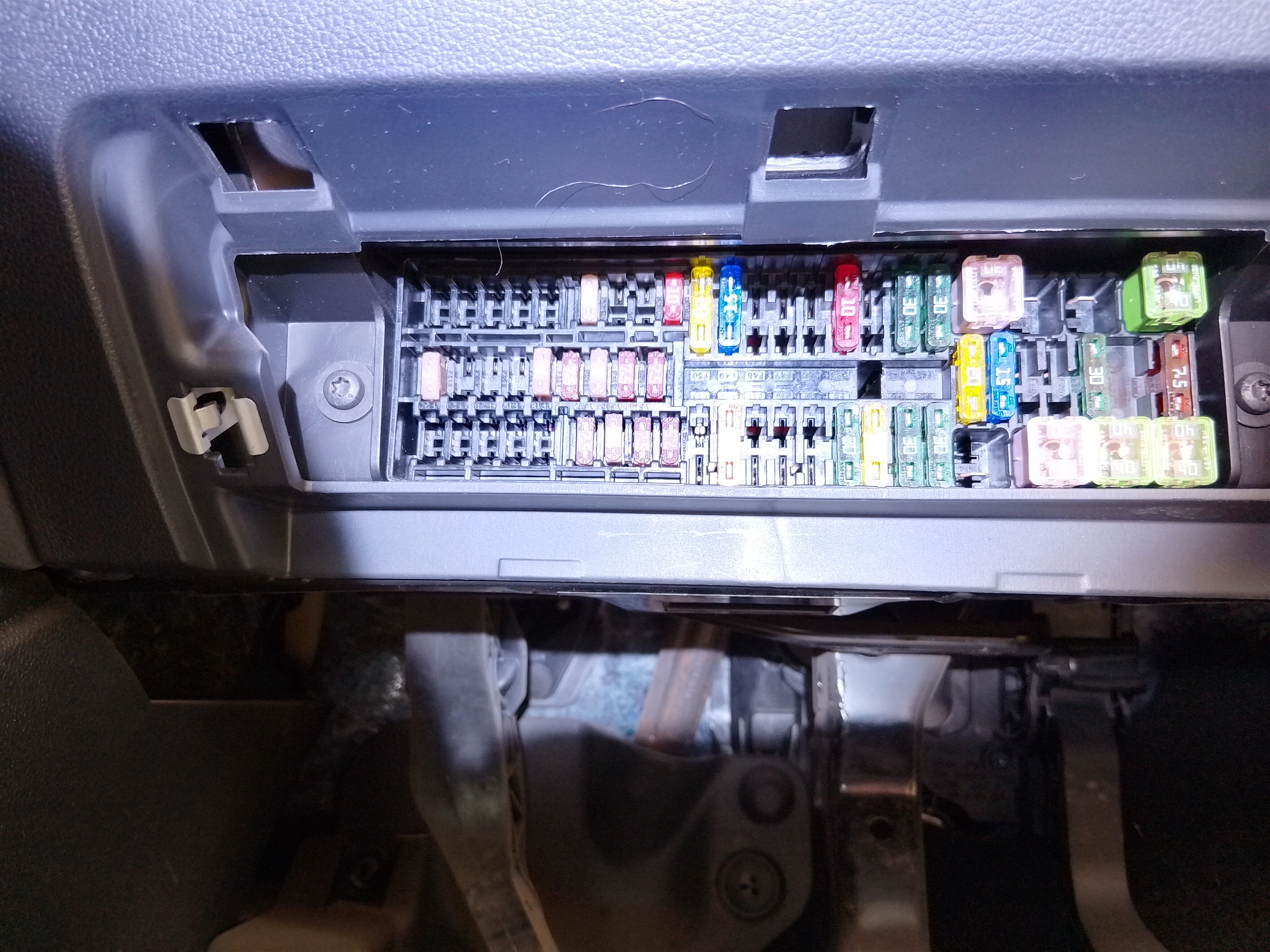

Ah, so at least you know that the fuse boxes on RHD cars is a rotated version of what LHD cars have - thanks VW!
I tend to take a picture of the fuse boxes when the car is new, can help later on in the car's life.

Picture of my wife's 2015 VW Polo 1.2TSI 110PS 6MT 5Door SEL with winter pack

Thanks for the information on those fuses - will try that now.

Thanks, that was it and that was the first fuse I removed to check but it wasn't the one I intended to check - never mind, too long a story. Thanks so much though.
