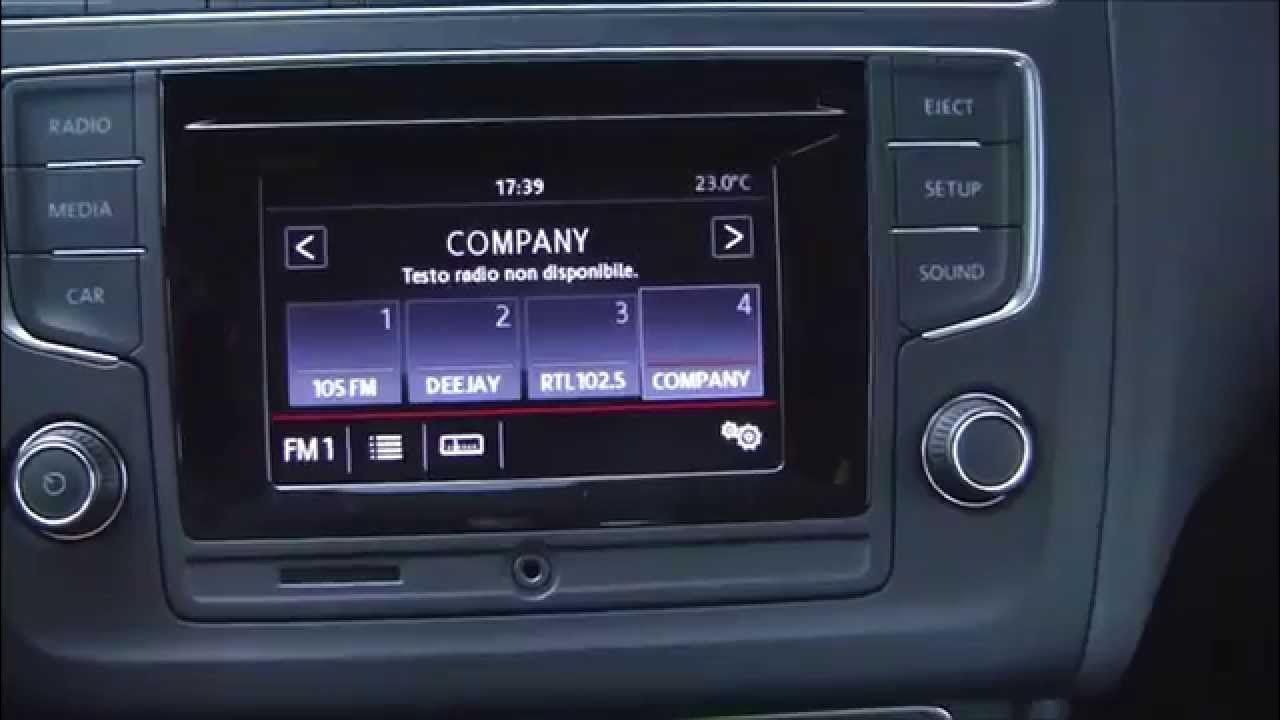

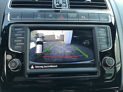

Hello everyone, I have an option to buy a Composition media from polo 6C, the screen and the glovebox unit. Currently i have composition color in my vw polo, without bluetooth, the most basic one. What is the process of retrofitting the composition media? Here are the pictures of both headunits. Thank you.

If the new Composition Media has NAV and 2 SD cards then you're in luck; it can be installed using the SD card slot.
From your pictures, looks like you have the correct unit for that.
