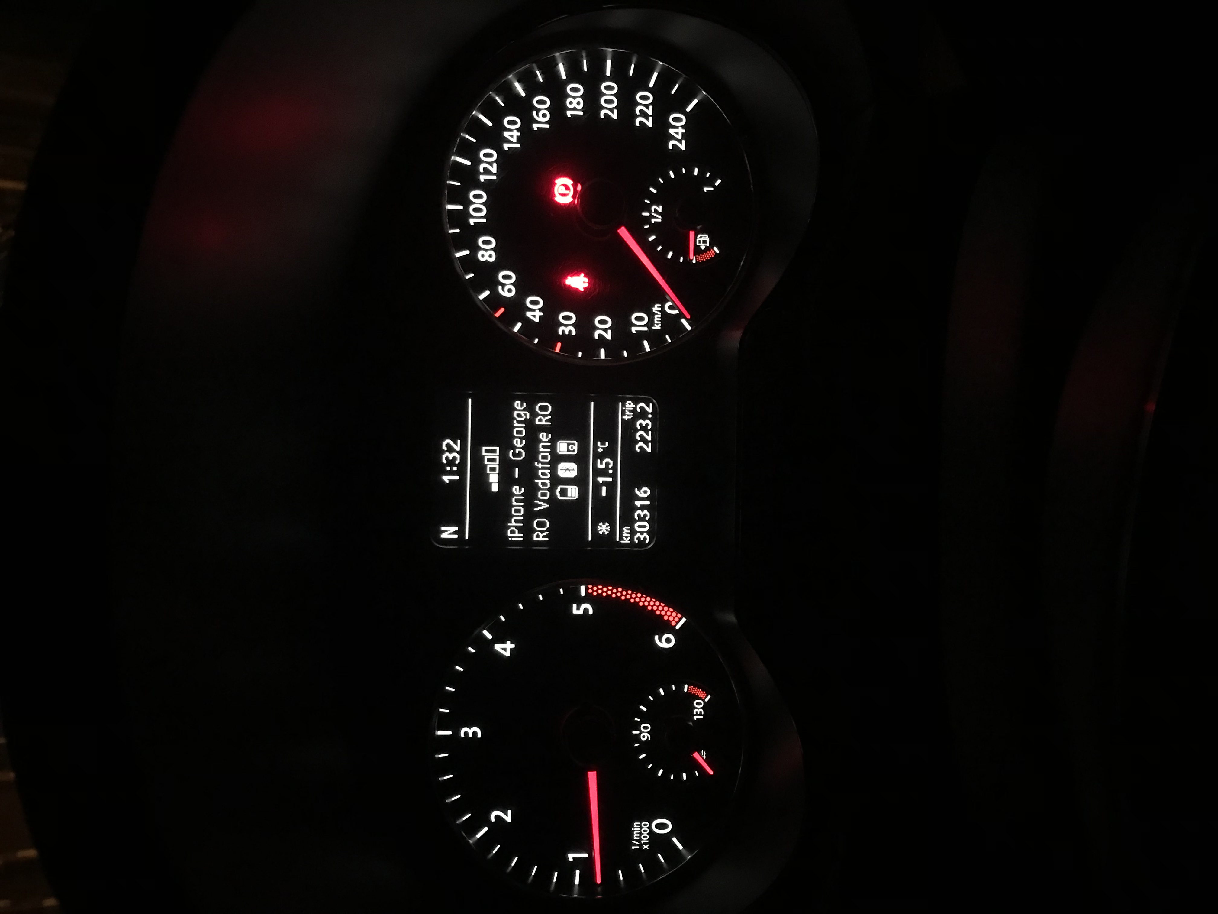

Post by georgenis »
Tonight the car arrived home. The instrument cluster is also working. Tomorrow I will post some photos.
