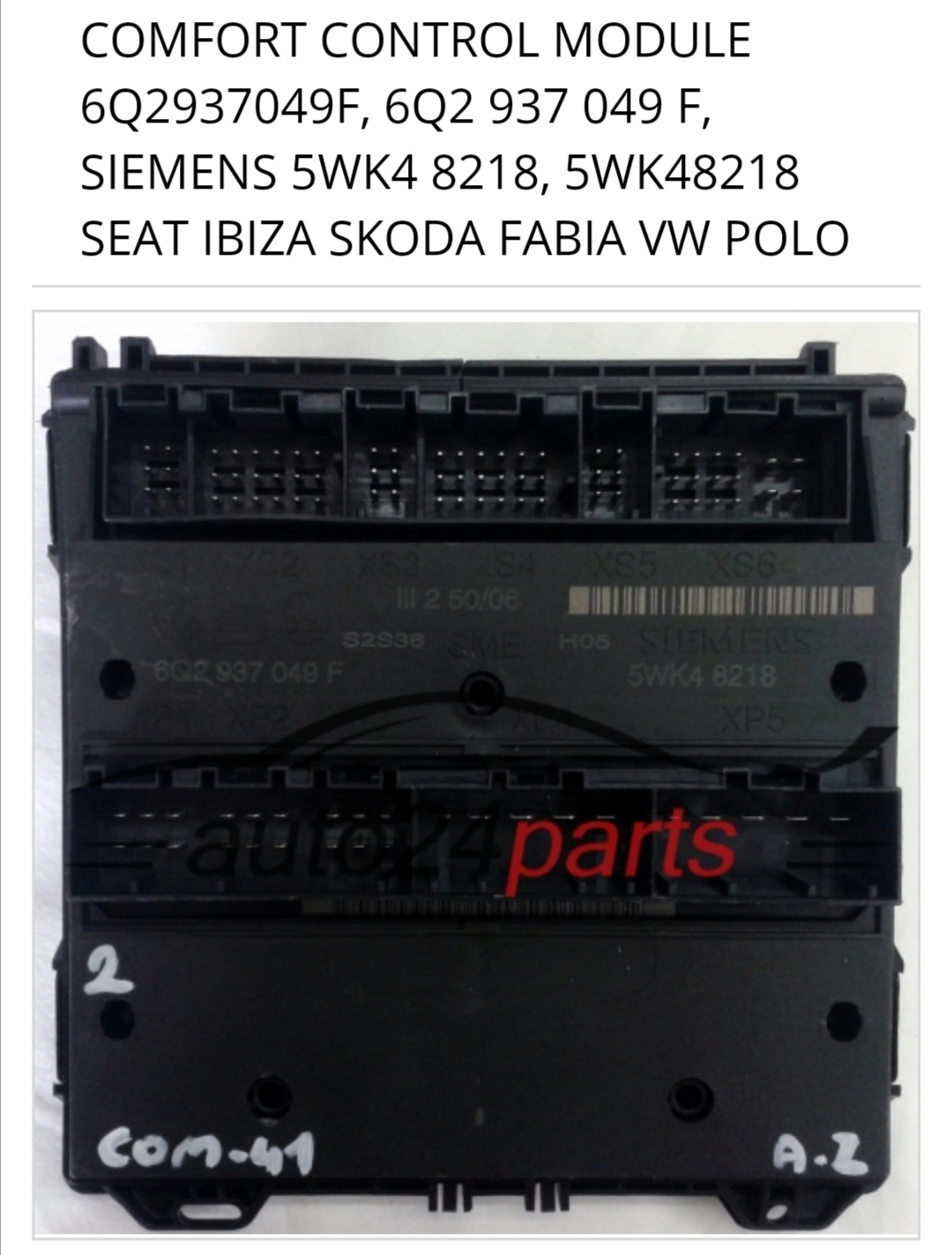

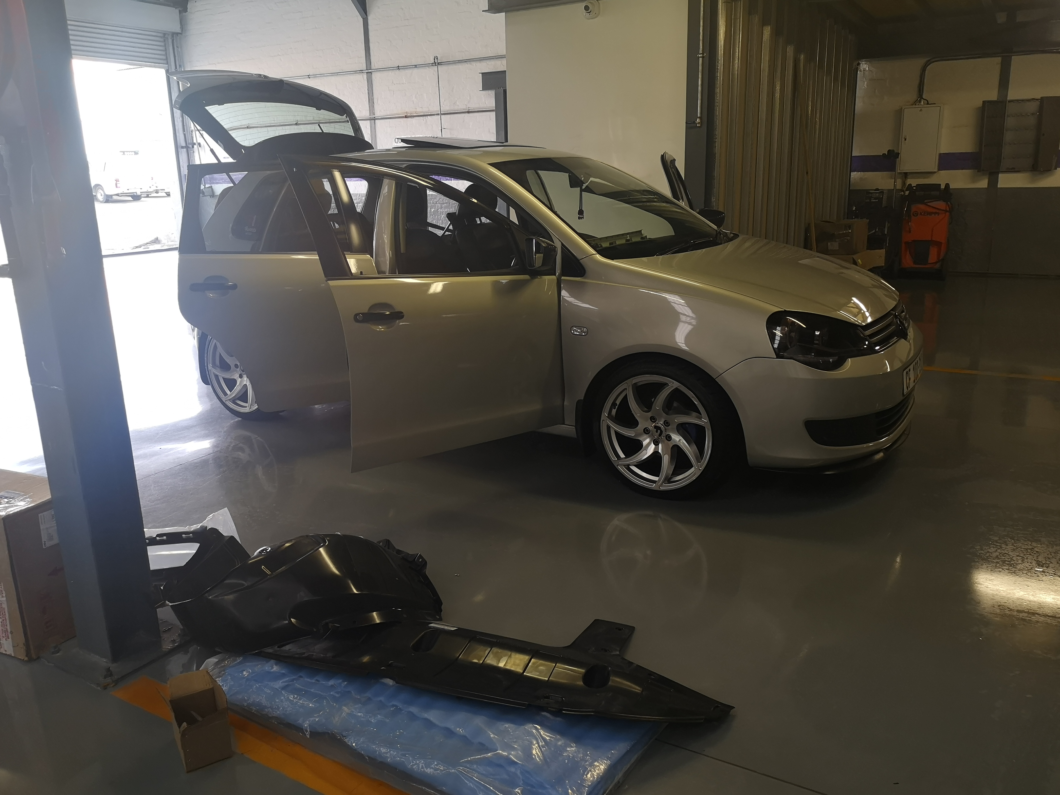

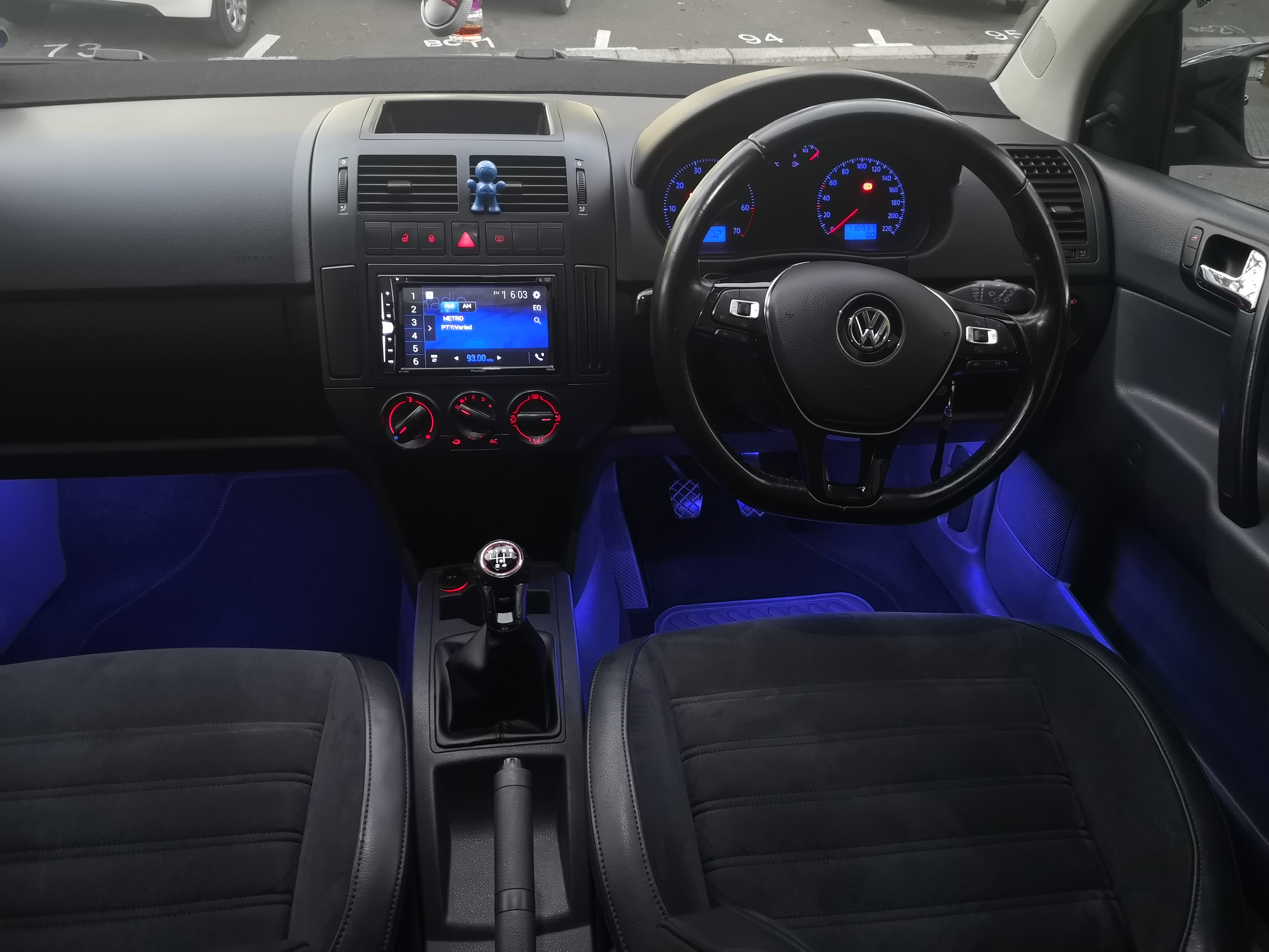

But does the steering wheel require coding to illuminate the buttons on the wheel?
I have retrofitted a MFSW on my polo vivo and I am struggling to illuminate the buttons. My BCM which I believe would be used to activate the functions on the wheel is 6q2937049f. (see picd attached)
For now I firstly want to just illuminate the buttons, to work with the low beam lights before I can worry about connecting the functions to a radio.
My instrument cluster does not give any info other than fuel, clock, mileage, oil, battery, airbag, steering, etc. Which I don't necessarily need to use on the buttons. I just want to be able to illuminate the buttons as well as control the aftermarket radio.
What can you advise? 🙏🏾😭
BCM 6q2937049f

Re: Retrofit MFSW (no CC) to Polo 6C
Your polo is very likely a 9N or a 9N3. they do not come with a multifunctional steering wheel. ever. I don't think it is possible to retrofit one, I'm sorry.
