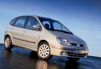

Josh_PoloGTi wrote:Anyway, you can now buy Aero blades off of an old Renault Scenic that fit onto the oldskool arms! BONZA!
Josh, you would become a hero if you could provide some more information on these wiper blades - if I go to my local Renault garage and ask them for some aero blades from a Scenic they'd look at me sideways :D
Are we talking about one of these (see below)...?
Or the latest one, one of these:

Renault Part Number:
77 11 236 179
Scenic Wiper Blades
31 quid
8)

Do the oldskool arms need to be modified in any way or is it a direct fit? I might get down there on Monday and buy some 8)

Apparently they are direct fit onto oldskool hoop arms.
www.seatcupra.net
www.briskoda.net
(search for "Aero" on either of those sites).
I ordered mine a couple of days ago... Just waiting for them to call to say they've arrived.
