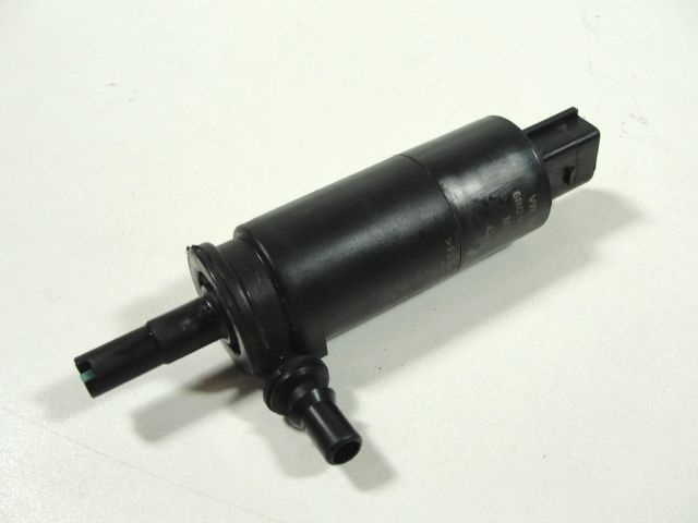

So I decided to go big.
Also install the headlight washers. Since it's a requirement anyway for the xenon headlights.
The plan:
Make wiring harness myself.
Just to confirm with a looking eye from tothers:
7M0 973 202, connector to level sensor
1J0 973 722 A connector to the washer pump <- this partnumber i'm not sure about
1K0 951 253 relay
i'll put the relay in another empty socket holder.
just to check the relay wirings:
85 to bcm white pin 49
86 to fuse box pin 46 (20 Amp fuse terminal 15)
30 to fuse bux pin 46 (20 Amp fuse terminal 15)
87 to the washer pump pin 2
and a wire from the tacho pin 17 to the sensor pin 2.
then at the sensor:
pin 1 to GND
pin 2 to tacho pin 17
and at the pump
pin 1 to GND
pin 2 to the relay pin 87
Posts: 8867
Re: iichels Polo 6R 1.2TDI Bluemotion
Posts: 6687
so 86 to gnd but the rest correct :D
Posts: 8867
so
Posts: 6687
Relay wired, bcm wired, engine bay wired.
Ordered the parts.
Now we wait 8)
thanks ciclo for your support
