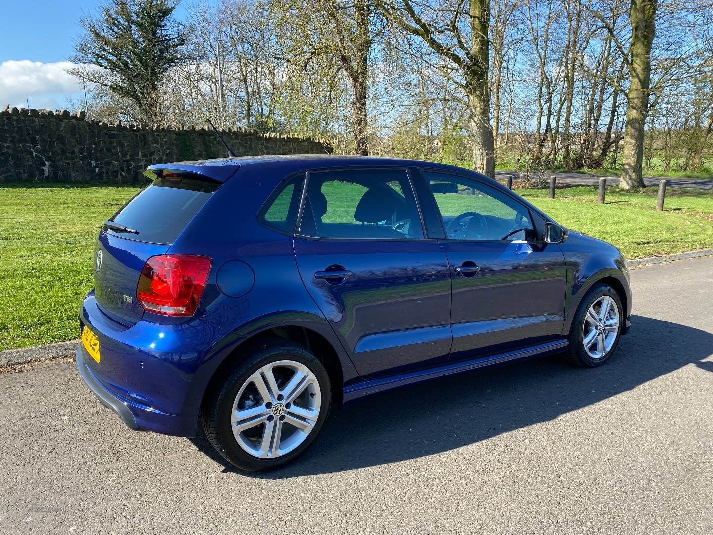

Posts: 6689
Re: How do I disable DRL
2014 could be both 6R and 6C. Perhaps a picture of the car in question could help.
Bobupndown
Posts: 44
Joined: Mon Apr 05, 2021 9:49 pm
Drives: None
Location: N Ireland
Post by Bobupndown »
6R?
Posts: 6689
Yes this is a 6R
