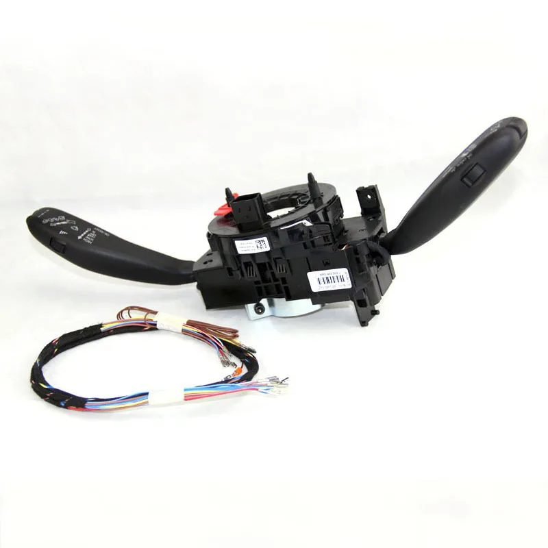

These are the stalks you should buy.
6R0953507C
In this case and if your priority is the total cost,
these will also work perfectly. (they are of good quality, but not as much as European ones)
Depending on your brake system (ABS or ESP) it may be necessary to replace your current steering ring by the one installed on the stalks of the image. Easy.
In this forum there are Russian users who can help you with this. Maybe firegrafik can advise you here.
All you have to do to install it is this.
6R0953507C
