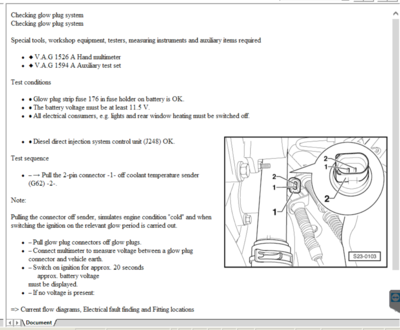

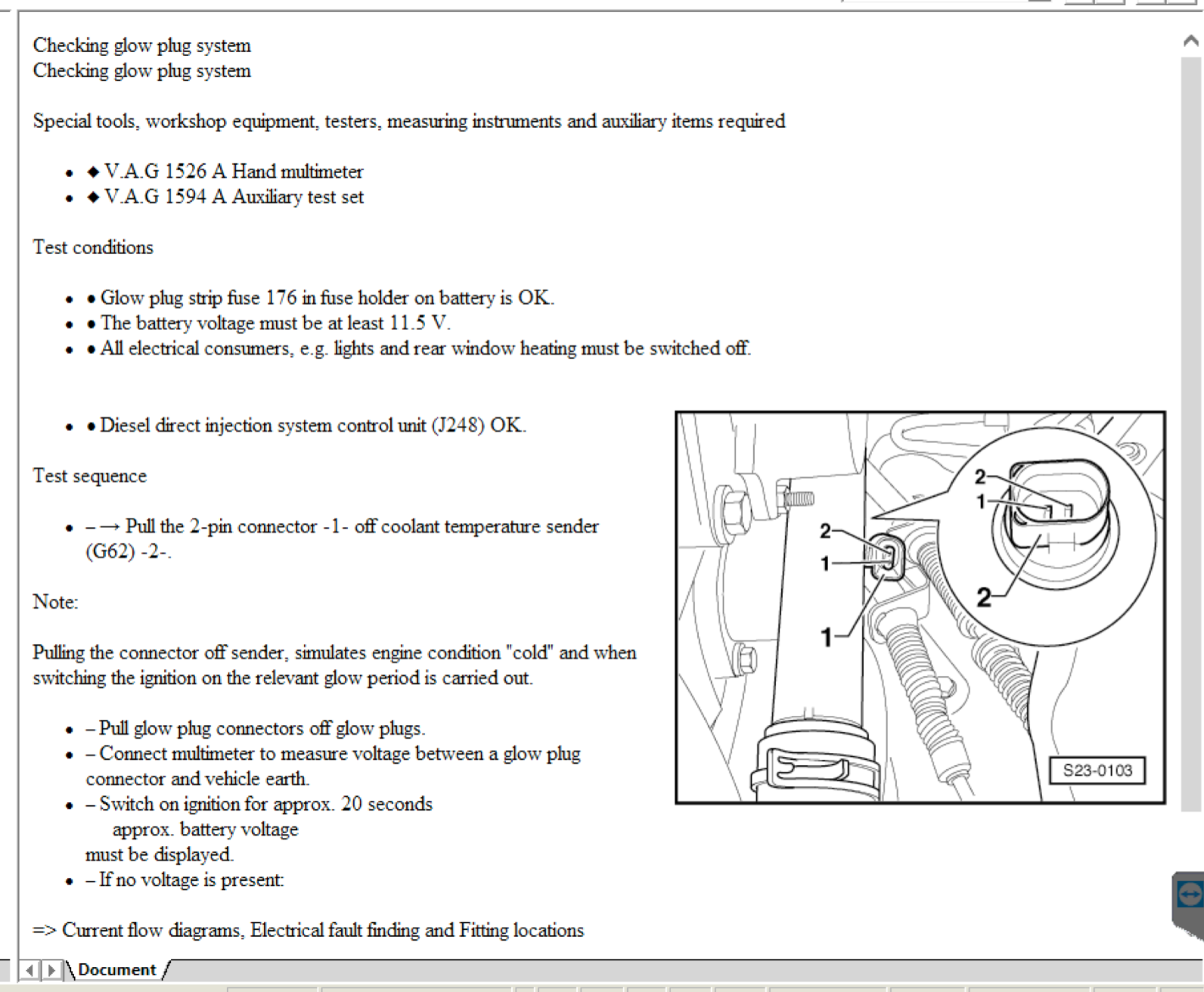

From the workshop manual
Pull the 2 pin connector off the coolant temperature sender (g62) to simulate a cold start and see if they work

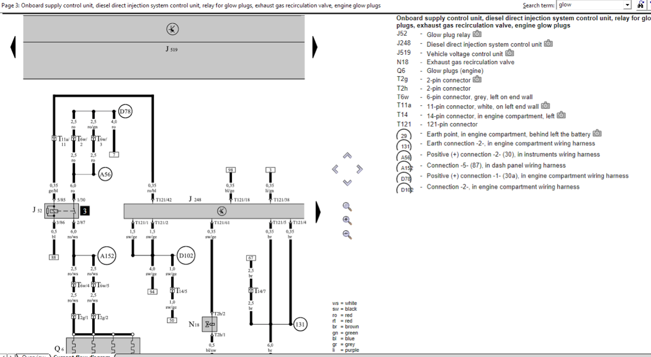

Wiring diagram.
The trigger for the relay comes from J248 - the diesel direct injection system control unit (which is actually, the engine ECU)

Yes, when I pull off g62 connector and switch on the ignition I can ear the glow relay "click" sound and glows start to heating.
Then another question rape me, if the ambient temperature is not cold (I live in spain) must glows come on always or only when ambient temperature is under 4º celsius (48 fahrenheit)?????
